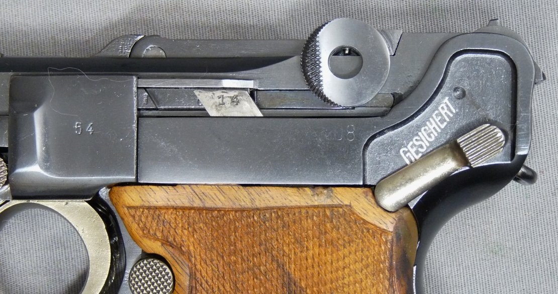

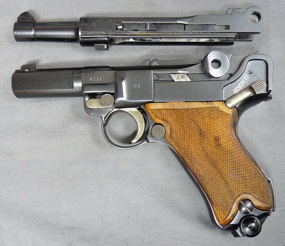

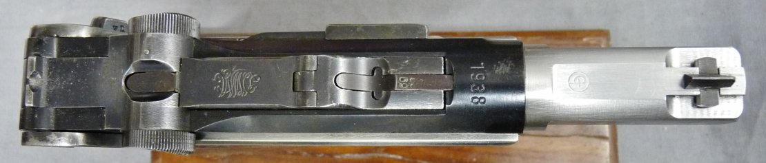

Unread 05-03-2018, 10:32 AM   #22
I'll be darned, there is a pin in the left knob! Curiouser and curiouser. Good call Don. Since I didn't expect a pin, I wouldn't have looked for one.
May be a 1900 that had the slot filled and pin added to "work" with a P 08 type frame?
The milling of the grooves is not consistent with a cut out P 08 toggle; like this one Rich did for me. Scallops are not as "deep" since the toggle is not as wide.
I just like the "dished" look.
A quick measurement, compared to Dave's data will tell the tale.
