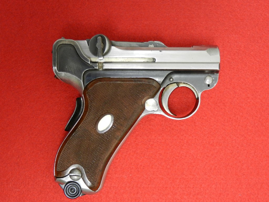

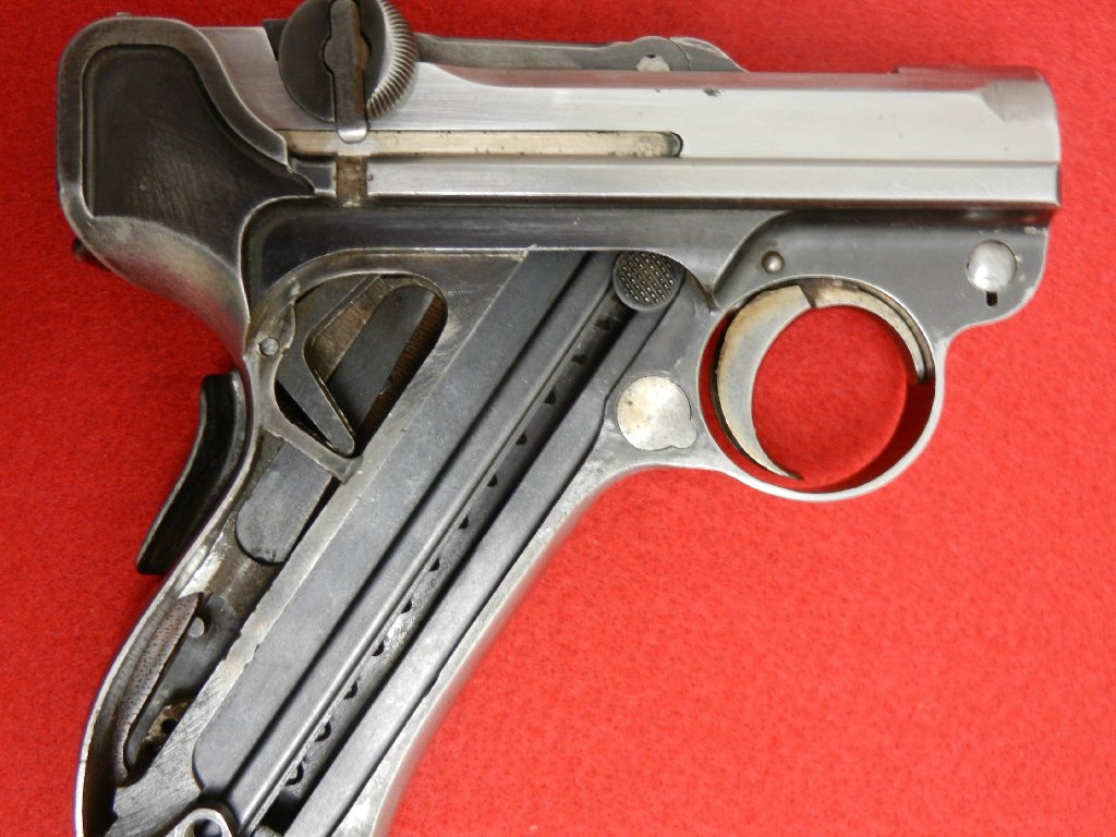

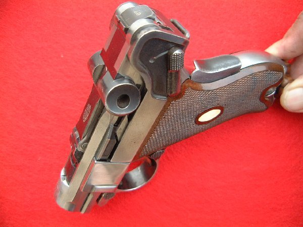

I have a copy of that article around somewhere...I will dig it out later and scan and post some of it. In the meantime here is a project I started over 30 years ago while I was still in the Army and I have never gotten around to finishing it. It is a hybrid 1900/1906 Baby. The modification for the coil spring insert is pretty crude in comparison to the DWM factory mod, but in my defense I am not a machinist and I did it all with hand tools.

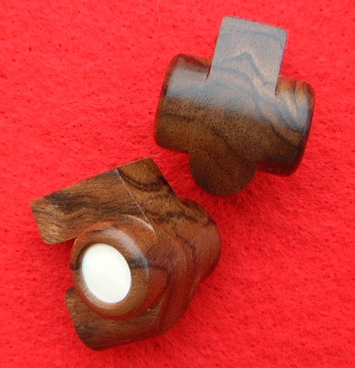

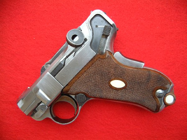

Here are some additional photos. GT made me some ivory insert magazine bottoms with fancy walnut to match my grips another craftsman made for me many years ago. Once again, I haven't gotten around to modifying some mag bodies to attach them to (I just stuck one not attached to a magazine in the gun for these photos). The magazine in the gun in the first photos is some aftermarket item I hacked up just to see if I could do it.

I have made a shortened mainspring and guide, it just isn't installed in the photo (I can install and remove mainsprings but it is still a pain in the butt for me...weak hands I guess). Once (if and when) I get all the pieces completed and put together it will require "tuning" of the mainspring to get it to cycle reliably with standard ammo. I plan (ha!) to make it a 9mm.
One of the things holding up the barrel installation is getting a "long" threaded shank barrel to match the long receiver on the gun. I finally got one but as I told you in the PM there are still some hurdles to overcome.

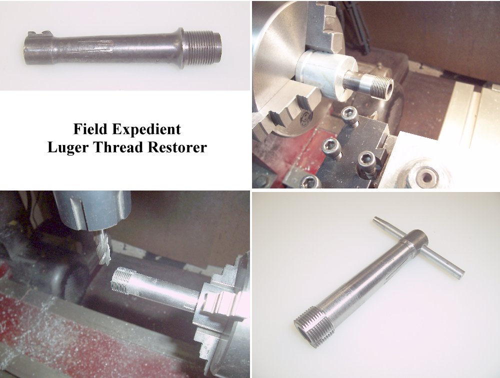

Here's what you need to clean up those pesky threads, Ron!

Wow, beautiful! It didn't take you long to knock that out! Do you have to harden the cutting edges?
I have two thoughts on that -
(1) Better that it re-forms the thread, not cut more off. Work it in & out, with oil, repeatedly. Use polishing compound if necessary.
(2) The barrel steel is pretty soft; I don't know if it will harden...And I would probably lose the 'edge' of the 6 grooves if I heat it...
If you want to try it, shoot me an address & I'll get it out to you.
