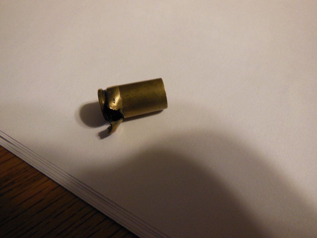

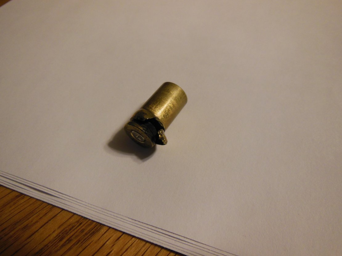

Then one day, one the last round of the mag, I suffered a severe blowout, the case ruptured at the rim area and the case was swelled about 2 tenths up. Nothing other than that, sounded the same, felt the same. I use a Unique load that is about halfway up the books, so double charge is not likely because of volume.
Needless to say, after a while at reloading(40 years plus) that took me back, never had that happen before. So I started looking at bullets in the MTM boxes to be shot, and some of them looked odd straight on.
I dusted off the case gages(like I should have before) and about half would not fully insert into the gage(Dillon). Most would stick out about 0.050" or so, a few more than that.
I was hoping that the pistol would give some protection to an out of battery problem with the disconnector. This particular pistol is new on the market relatively speaking, and when loaded with an empty 9x21 case, the disconnector does its thing. I can however, put a correctly lengthed 9mmx19 into the firearm and slowly close the action, the user can feel the slide/trigger engage, and stop, then pull the trigger, the slide jumps forwards a tiny amount and the firing pin drops. So something seems to be going on there to me, but just a simplistic opinion.
I would surmise that a strong hold would help with most things, a soft hold would irritate the breeching completion, especially on a slide that has been lightened as this one has.
In examining the plated bullets, slightly cocked in the completed cartridge as reloaded; I revamped my Dillon progressive dedicated to 9mm. I took the route of the lead bullet guys and bell the heck out of the empty case, and firmed up my taper crimp. This seemed to help a lot by allowing 90% of my reloaded 9mms to pass the gage test. Still have a few to go in boxes of bullets, always buy in 1000 piece lots which sometimes bites me I guess.
Things I have noted about plated bullets. They deform easily, as just plating over lead. Not very tolerant of a minimum champer, cuts rings off the bottom of the bullet. Seems that the coefficient of friction is more stout than with fmj bullets, seem to grab the inside of the case, just my opinion again from feel during seating. Some will show the case mouth pushed back some, ie the bullet grabbed the edge and deformed the case mouth very slightly.
So I am about ready to cry uncle and throw in the towel with plated bullets for autos. Probably will still use them for revolvers and single shots. Not completely there yet,as thinking I am missing something easy...........

Here is why I am interested, a couple of poor picts. Appears to fired out of battery, but why............I have the two suspicions, but jury is still out here. Sending the pistol back to the manufacturer is really not much use, been there and done that a time or two; so probably will become a safe queen unless the Rick can come to grips with whys. I am somewhat thankful that this did not happen with a full mega magazine full of rounds, happened on the last round. Debris in the face a little, threw the extractor across the room(reused), and blackened things up some. The load is with unique, so a double charge does not seem too feasible, no debris on the star of the press at any time fwiw. Report was normal, not a biggie boom/flash etc etc.
I have beat this to death, but as usual; detail does not come easy. I am done with the thread, thanks for the comments.
