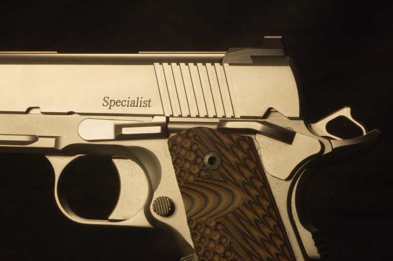

I've had the similar experience with a semi-custom Specialist from Dan Wesson. Remarkable precision in a production pistol...
That said... nothing like a Les Bahr or Wilson...

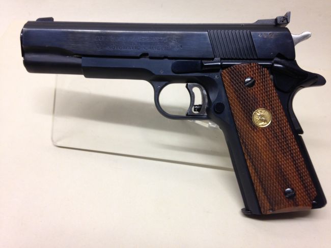

For those not familiar with the collet bushing, here is one with its 38 Super barrel.
Edit: The bushing has four slots. The 'groove' you see is an internal ridge that physically touches the barrel. A 'normal' Colt bushing is a thousandth or so over the barrel dia, and theoretically rides on a film of oil, similar to an automotive crankshaft bearing. I don't shoot my Colts enough to notice any appreciable wear, and the collet flange ID is within a thousandth or so of the barrel dia, so I suppose that acts as a kind of 'fallback' if the fingers should wear enough to no longer center the barrel in the bushing. Just conjecture on my part.
