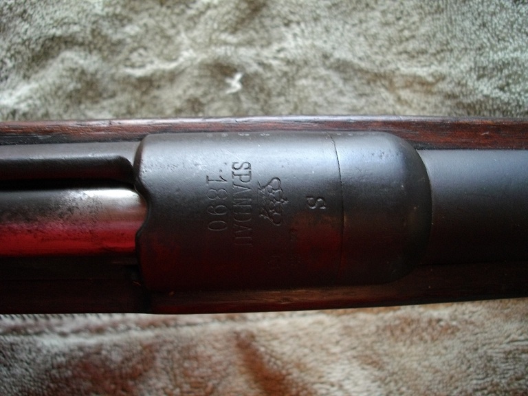

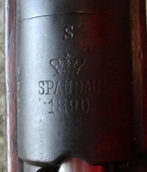

Here is a Spandau Gew88 that has been stamped.-or roll die?
