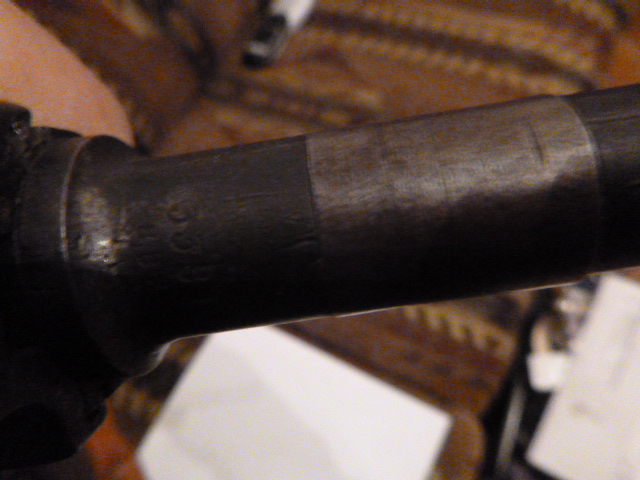

I have a friend who picked this up a while back. I wondered what the heck is with the barrel piece. Any ideas about what it is or purpose?

How's it look inside?

I just looked without a light using my fingernail as a reflector, but couldn't see anything blatantly abnormal. He said he has shot it and it shot fine.

Is it a repair or a discoloration?
is it a repair from a bulged barrel? Ed |

I sure don't know. It seems to be flush. I couldn't tell if it was an added on piece or whet. The barrel sn matches the gun, so it isn't a replaced barrel. I wondered if anyone here has seen something like it. I sure can't figure it out.

How long is the barrel OAL?

I will have the guy measure it. I didn't think of it until I got home.
#8 |
Lifetime Forum Patron Join Date: Feb 2009
It's a Bubba-fied Luger. Possibly an added-on sleeve to 'repair' a damaged artillery sight dovetail, but the braze is inexcusable.

I agree with Rich, bubba at work.
Looks like someone didn't like the artillery sight and turned down the front half of the base. Then perhaps someone else decided to repair it; and we see the pitiful results. Why? There is just no explaining "bubba's" ideas.

my guess is it was turned for some type of scope ring, and repaired at a later date on the workbench in the garage........

And we use the term "repair" loosely. "Hacked" would be a more fitting term.

"Hacked" is too polite a term... in this instance the only word I can use to describe the work done to this Luger is "butchered"... What a shame.

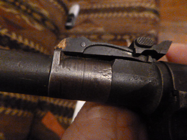

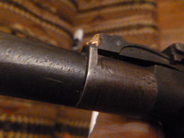

I had the guy with the gun send me a couple of pictures of the barrel and front sight. I hope they come out on here ok as they are from a phone picture. Also, he said the length of the barrel is 7 3/4.I can't see that the front sight has been removed as was earlier suggested.
#19 |
LugerForum Patron Join Date: Jun 2002
Dave, These LPO8s with barrels of less than 8"s (around 7&1/2") are normally a result of the original fine tune front sight being frozen up and the post WW1 repair consisted of cutting off the barrel at the rear of the front sight base. The front of barrel was then turn down to accept a standard non-adjustable front sight and base. TH
#20 |
Guy probably just doesn't know how to measure the barrel or read the ruler!
That one still has the adjustable front sight.
