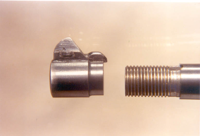

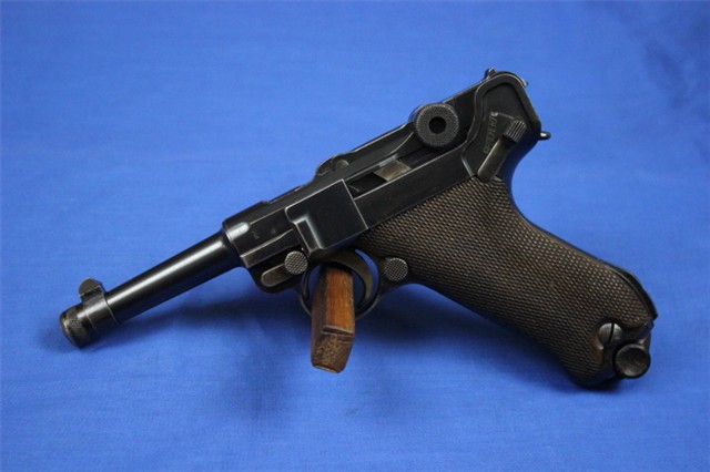

Here are pictures of a 1920 Commercial Luger in 7.65mm with a barrel threaded end attachment. The pistol has Germany origin stamped marks.
The following 2 members says Thank You to Dick Herman for your post:
Unread 01-18-2017, 03:22 PM   #8
Very similar to the gun I was describing Dick, but on the gun we had displayed the entire front sight ring/base screwed off and the front sight was spring loaded as the latch for removal... but thanks for sharing your photo... I would love to see the suppressor that accompanied the gun in your photos, and know its vintage...

Nope, sorry, that is not it either. On the gun I am referencing, the entire front sight band and front sight base looks normal until you depress the front sight to unlatch the sight band and allow it to be screwed off of the barrel...
At the time it was displayed, it belonged to the Lugerforum.com site owner, John D., but I am pretty sure he traded/sold it many years back. Maybe if he is listening to this thread, he can shed some light on the photo, and the present owner of the gun for us...

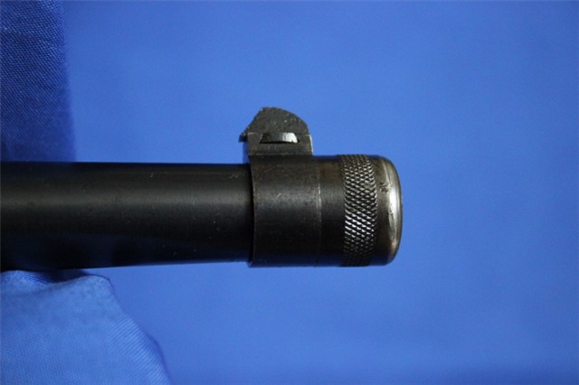

This one ??

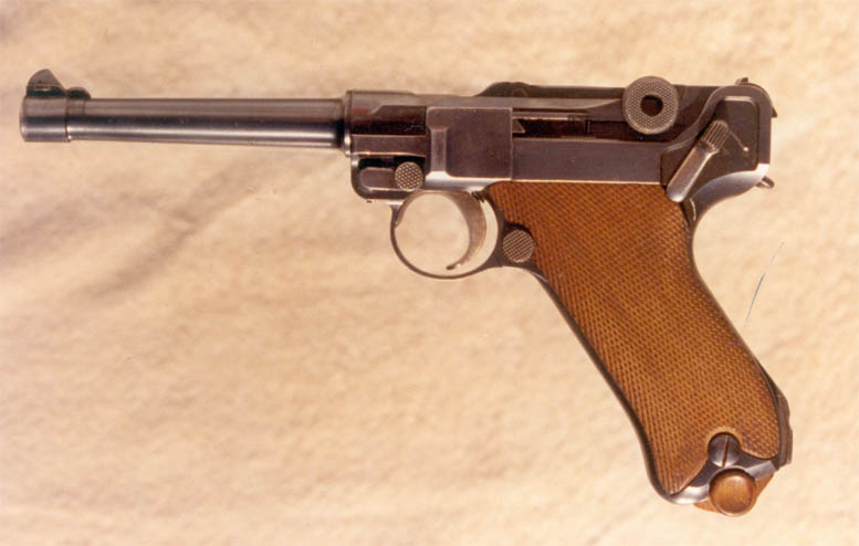

OK - this one was mine:
I'll try to dig out some more...
John D.
