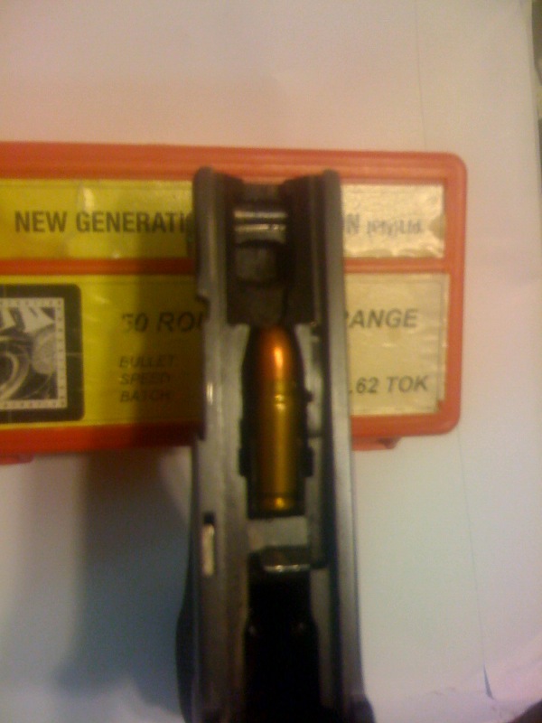

here ya go....quick iPhone pics...this is also a Mec Gar....it easily slides into the mag well.....whether it feeds or not is a secret known only to Herr Werle for now!

...and the rounds are dragging the nose on the mag tube...
But I see what you mean now...and I see you've already got the 7.62 Tokarev cartridges...
Mail me your barrel/receiver assembly; I'll hog that sucker out!...
