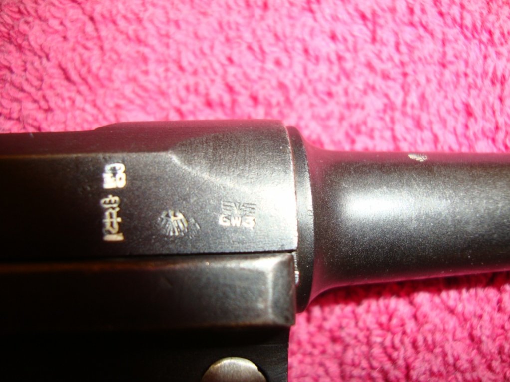

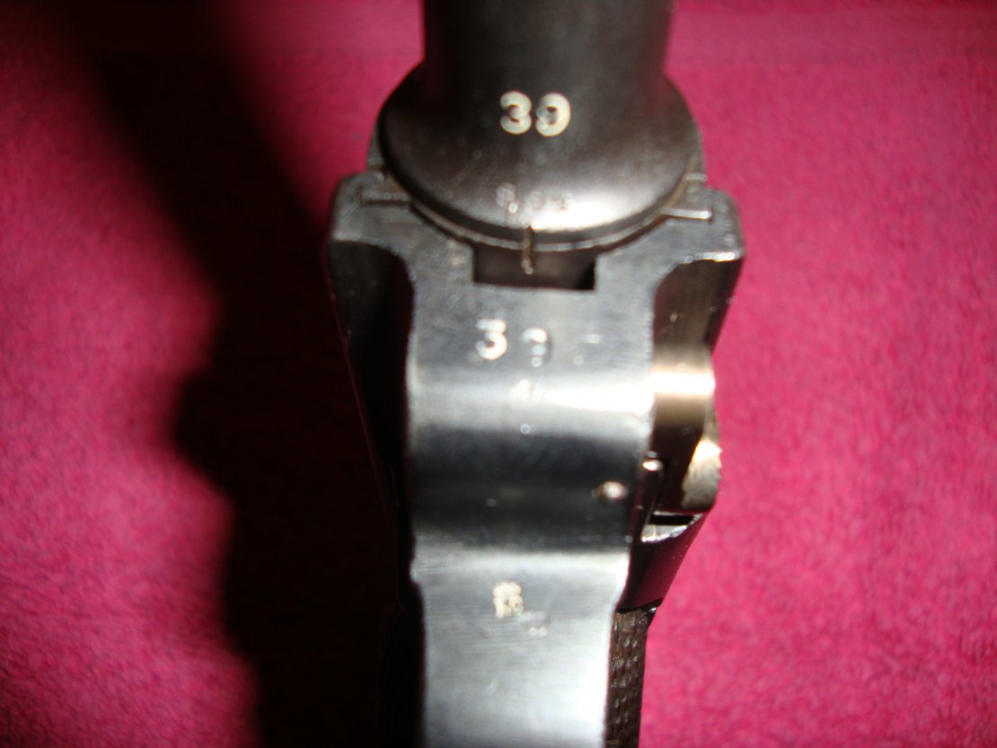

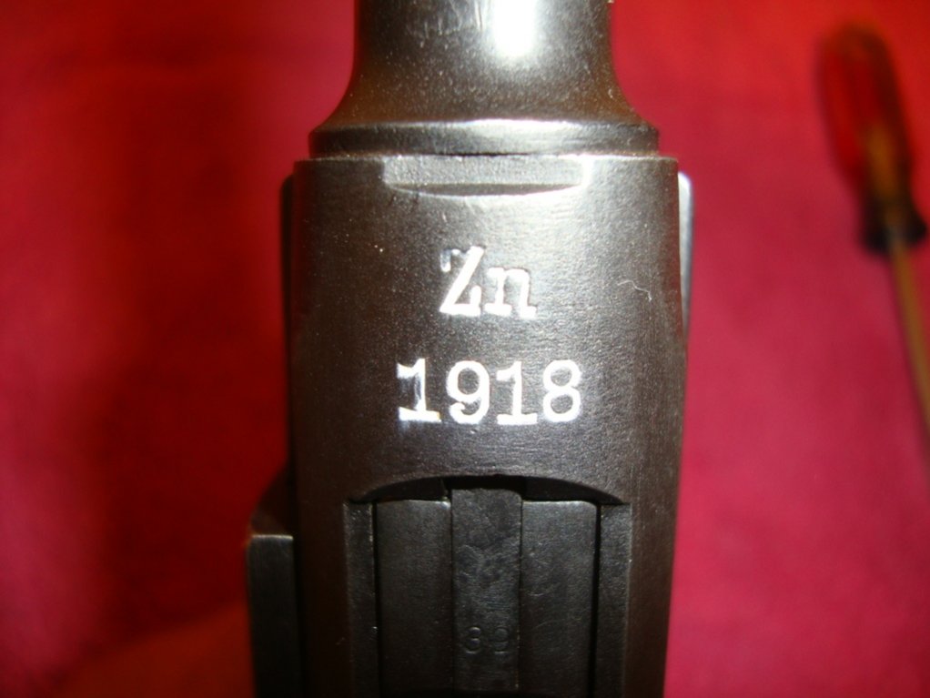

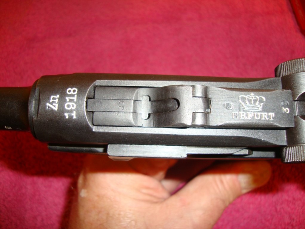

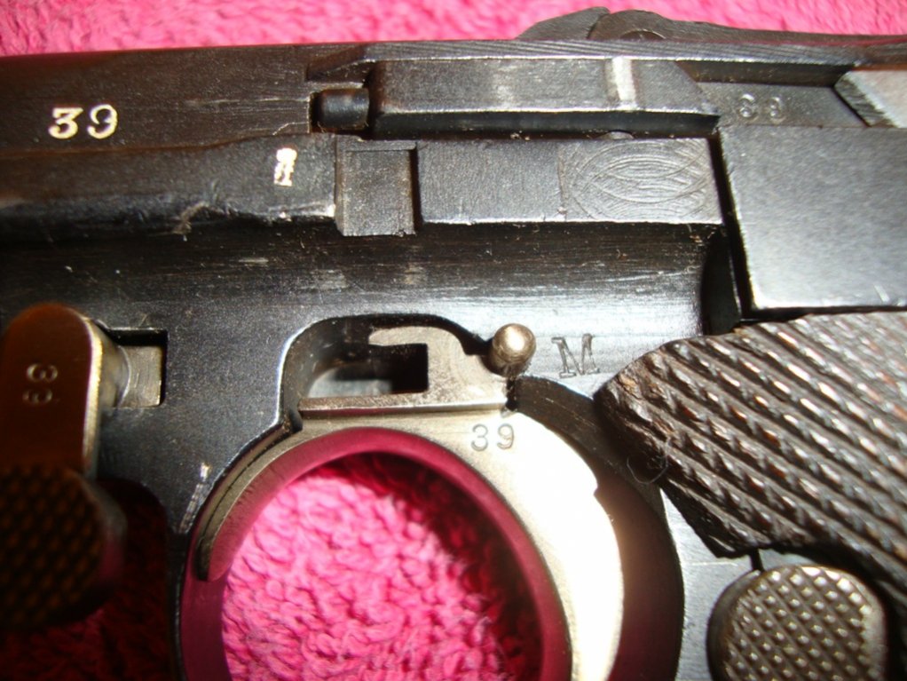

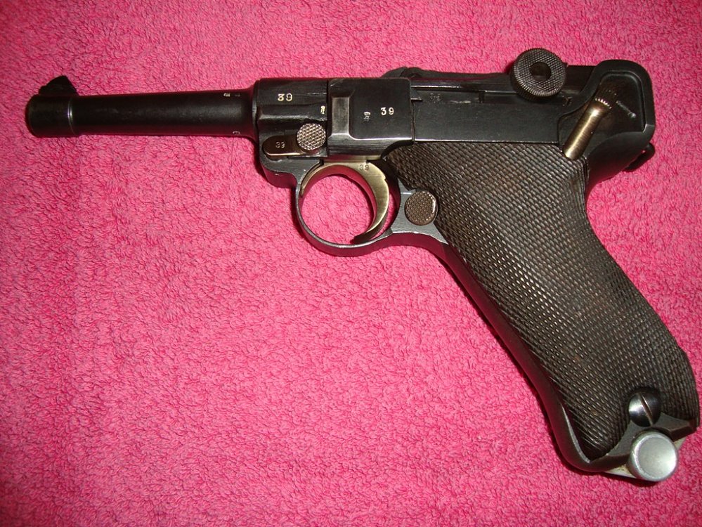

Ed it was my gun here are some pics there is also a post on Jan's sight under Zn marked Luger Kevin http://forum.lugerforum.com/attachme...75d=1455758875
