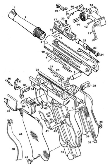

I am not clear about which pin you are trying to remove.
Can you show it on a diagram ?
Try putting it in the freezer over night.

Hi,
I think you need to remove #15 before you can slide to this axel # 14 pin.out. On my pistols they remove right to left.

Yes. 15 on the diagram. I'll try the freezer technique as a last ditch effort before sending it off to Gerry Tomeks as Mark suggests.
