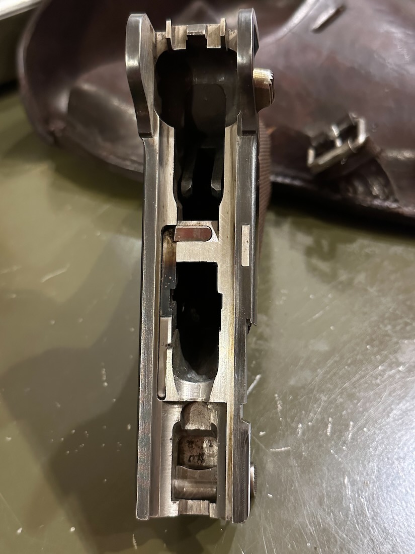

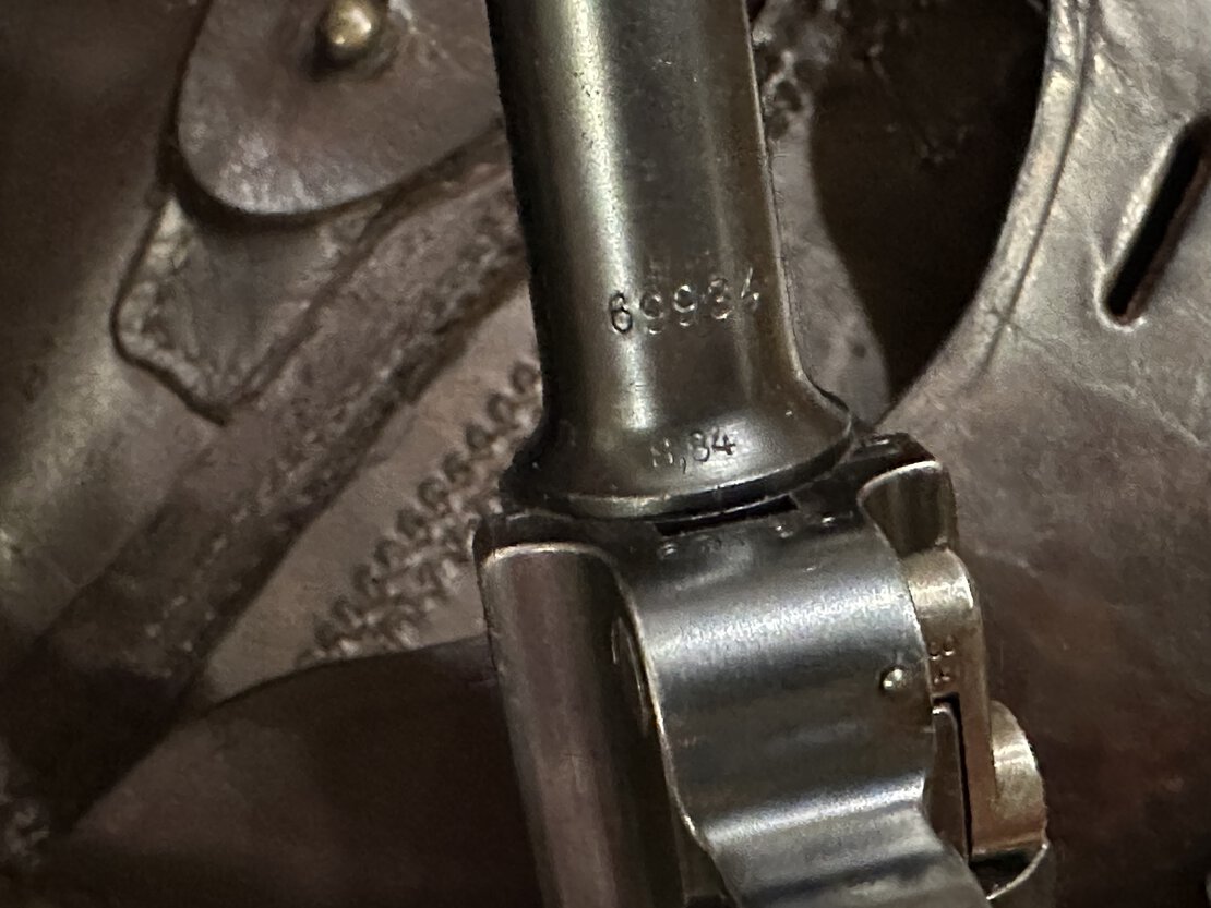

More pics of 69934

Unread 10-02-2024, 09:05 AM   #13
tarhe
Join Date: Sep 2023
Posts: 5
Thanked 6 Times in 3 Posts

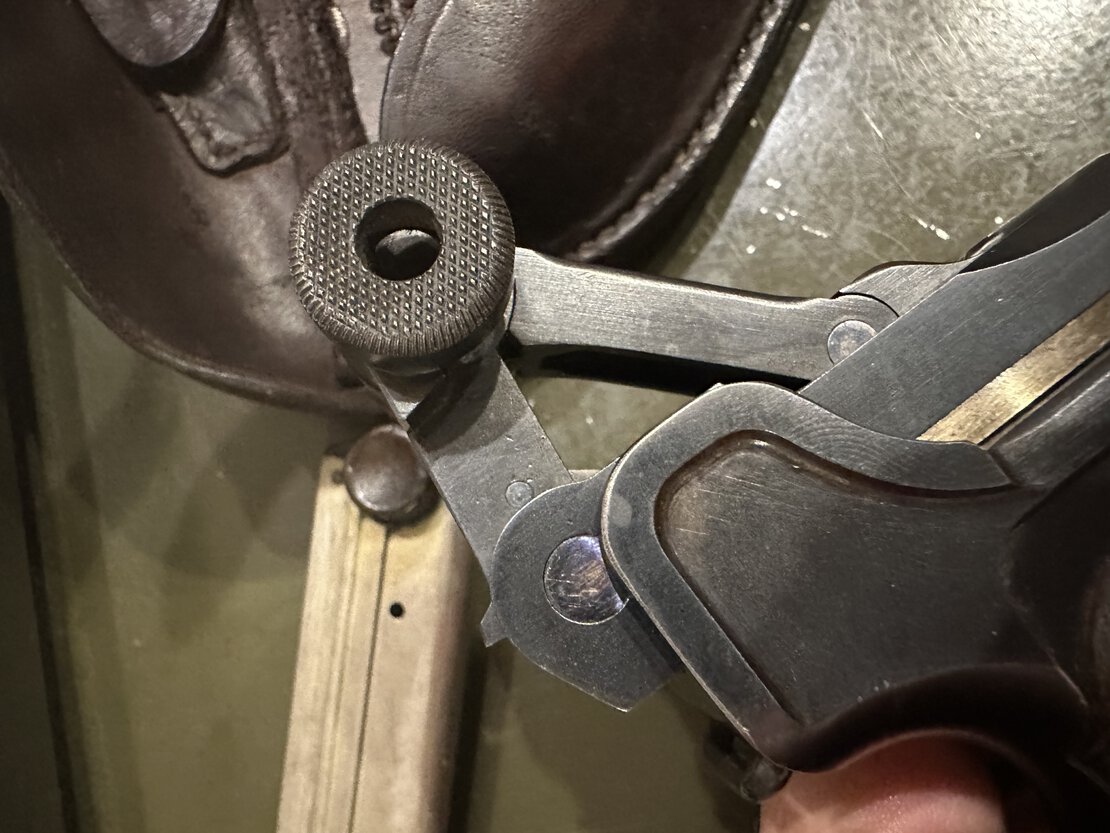

Default even more pics!
What are your thoughts on the finish in the right side where I'm pointing? Was that from when the slide stop was added?

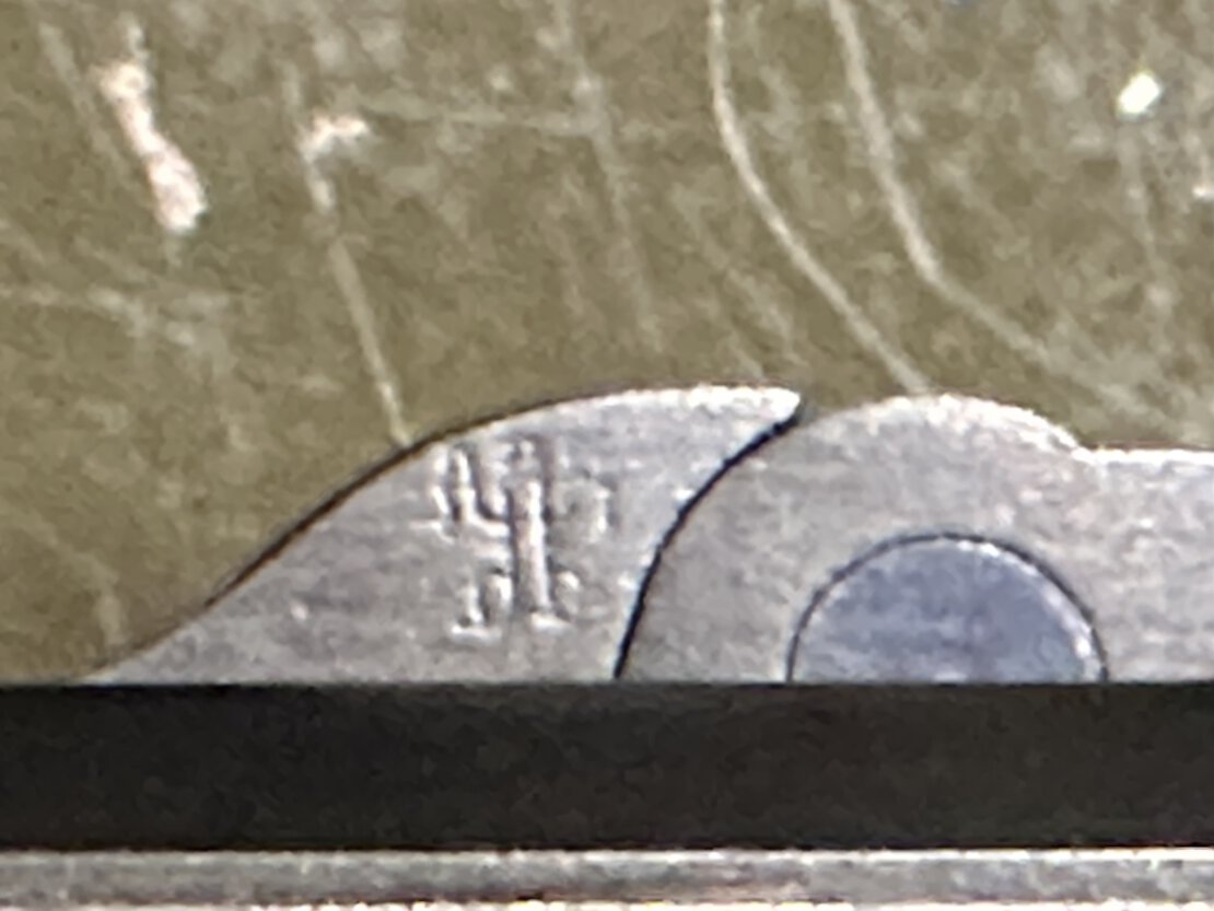

Unread 10-02-2024, 04:11 PM   #14
HerrKaiser
HerrKaiser's Avatar
Join Date: Feb 2018
Location: South Carolina
Posts: 891
Thanks: 839
Thanked 904 Times in 437 Posts
Mismatched sear bar as well (seeing a 95)
