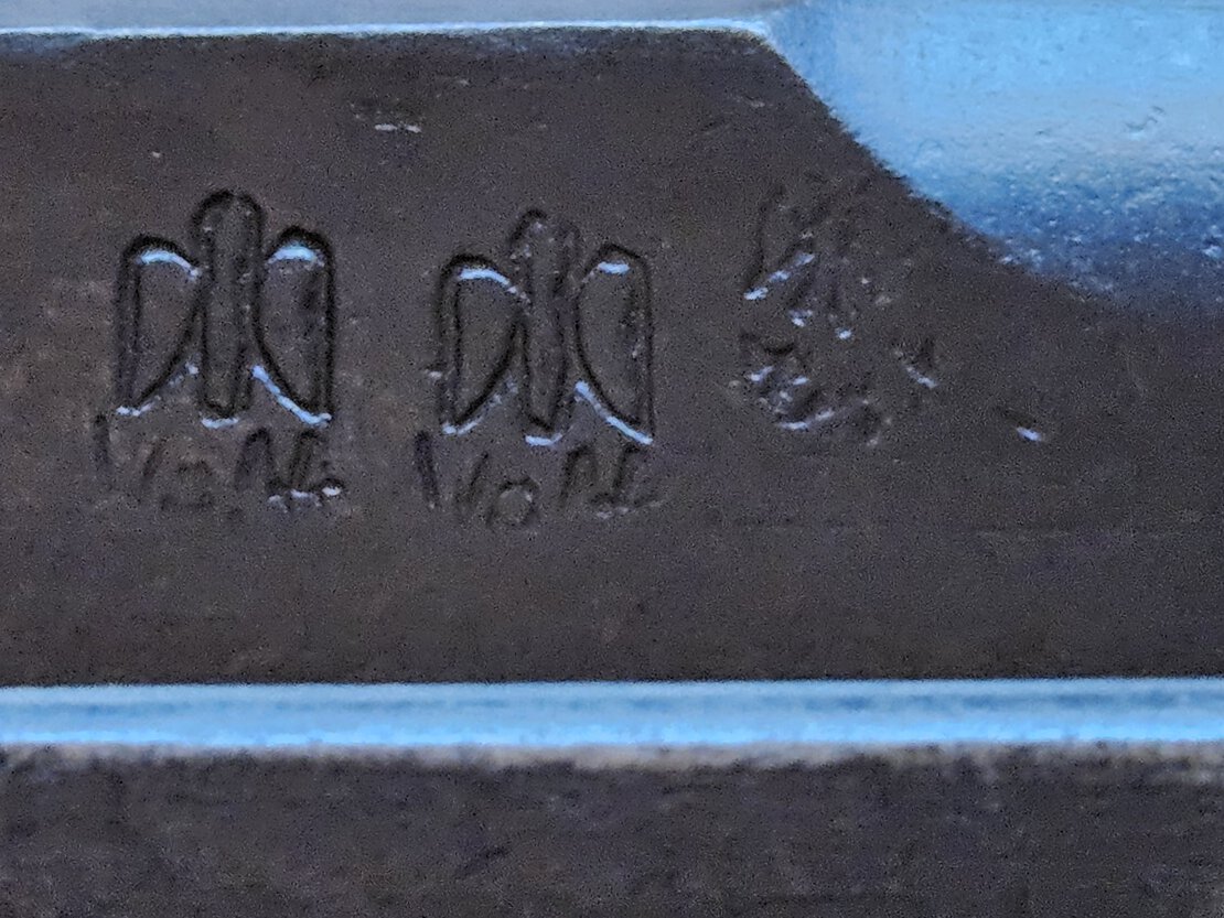

Please re-confirm the receiver stamps. Please do not call them dove-anything They are EAGLE/WaA4 inspection and acceptance. The proof stamps should be a different eagle ArA4--this stamp is on the barrel as well, although it is usually very poorly stamped. The same eagle should be found on the left side of the breechblock, again poorly stamped. The designations under the eagles are important data.
Please note, if all three stamps on the receiver are actually e/WaA4 this is a data point which should be addressed specifically, as it is not expected and may be important.
Also, there are some of these pistols found with a very different style of eagle stamp with no letters underneath. This should be addressed specifically as well.

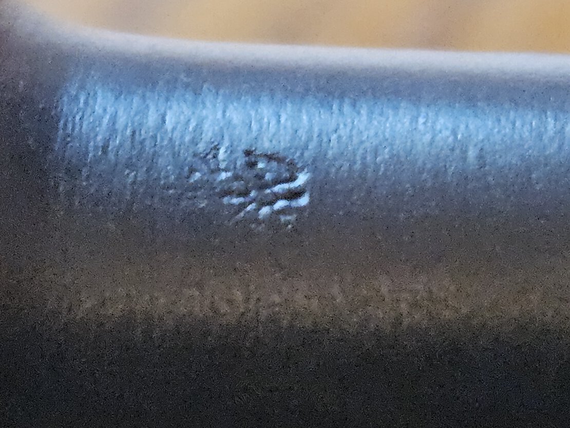

Good-Day is offline   Reply With Quote
Unread 02-26-2024, 03:01 AM   #5
Very good. And I would like to point point something about the e/WaA4 stamps. Costanzo, in his Proof marks book, deliberately misrepresents these stamps by expressly calling them doves, and drawing them to look like doves with their beaks pointing "up." Part of the problem with the stamps as they exist is that the dies were very poorly made, and crucial detail was worn away quickly in use. It is possible to see, in your examples, that there is a very tiny, pointy beak extending to the left (the eagle's right, as the bird's body faces the viewer). It is this detail which has worn away quickly to disguise the stamp, and make it possible to casually accept Costanzo's deception.

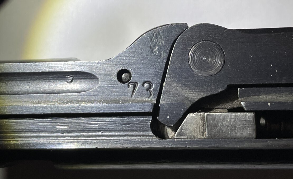

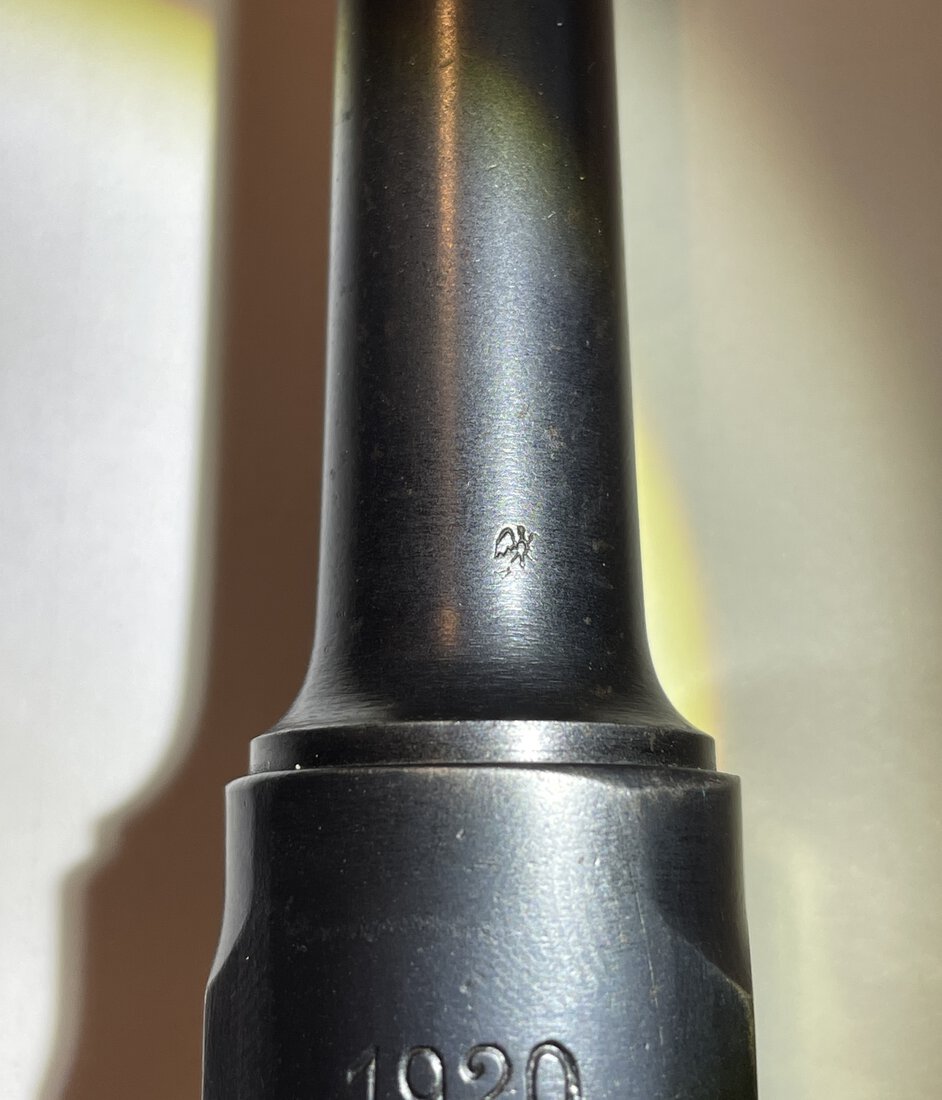

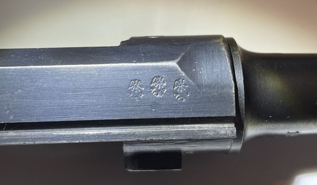

5. The inspection/Proof stamps on the barrel extension and the barrel and toggle (5 entries): 3 proof marks on the barrel extension, one on the barrel and one on the toggle (see pictures)
6. Any Inscriptions: No inscriptions
7. Presence/Absence/Removal of Sear Safety & Mag Safety: No sear or mag safety
Piranha451 is offline   Reply With Quote
