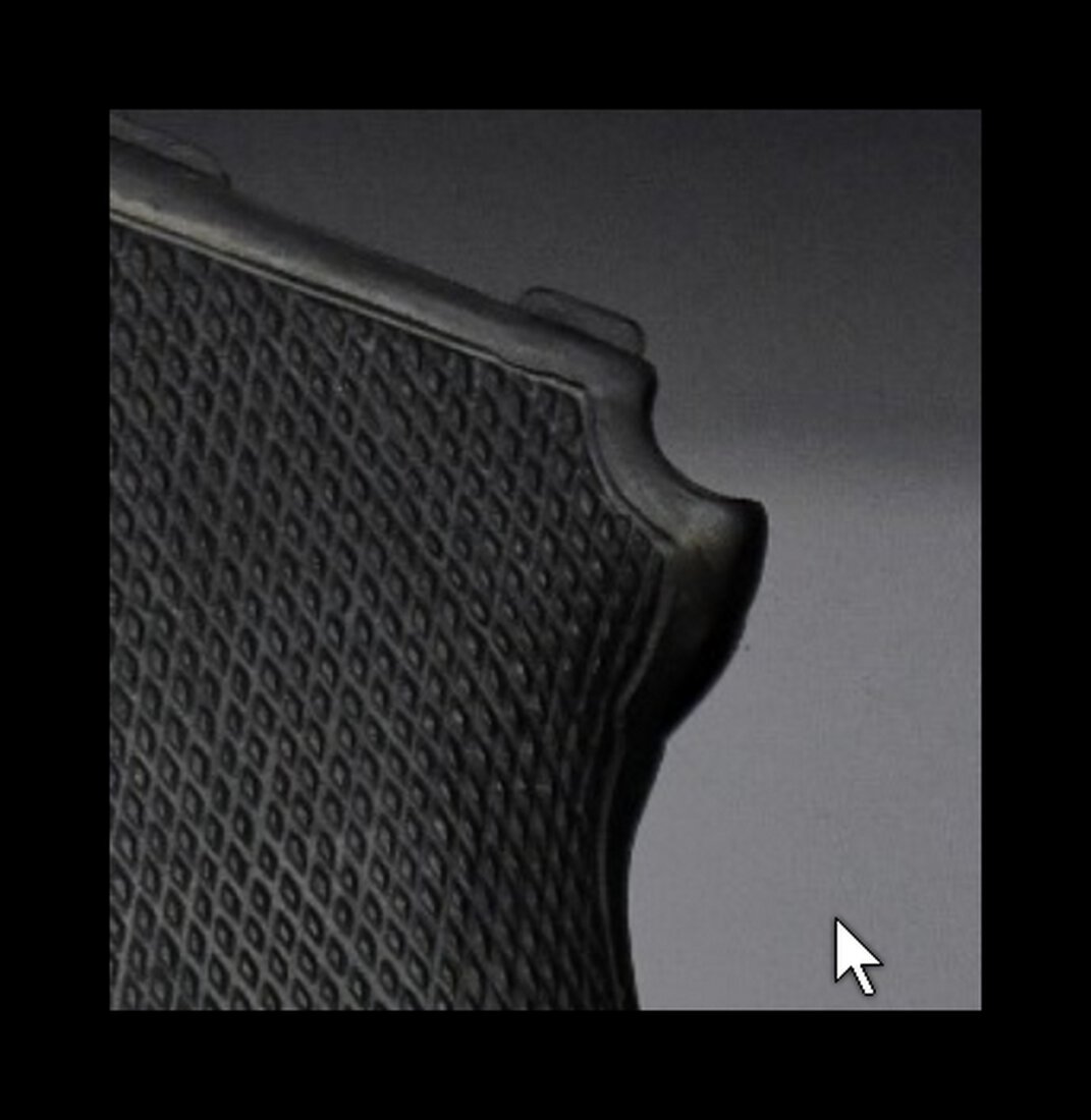

Here's the $45 pair. https://www.gunbroker.com/item/1029329637
They're cast urethane reproductions. The back sides of BW (and brown) grips will give clues to their originality, but seller does not include a pic that shows the backs in the listing. Misshapen checkering (as in Greg's pic), holes that aren't threaded, and wood grain impressions on the back (e.g., the latter would indicate repros cast from wood grips) are some elementary red flags. If you have them in-hand, the hot pin test easily separates Bakelite from plastic--although not necessarily original from repro.

itha. ----- Thanks for showing the photo above. I could live with the cast urethane repro. grips on my byf 42 luger since I'd be aware that is all they would be (repro). I'm not interested in what kind of imprint there might be on the back side of the grip panels either. If I were to pick up a pair of the repro grip panels, they would be only for my own private display. I'd still have the original wooden panels that currently reside on the luger and I could reinstall them at any time.
