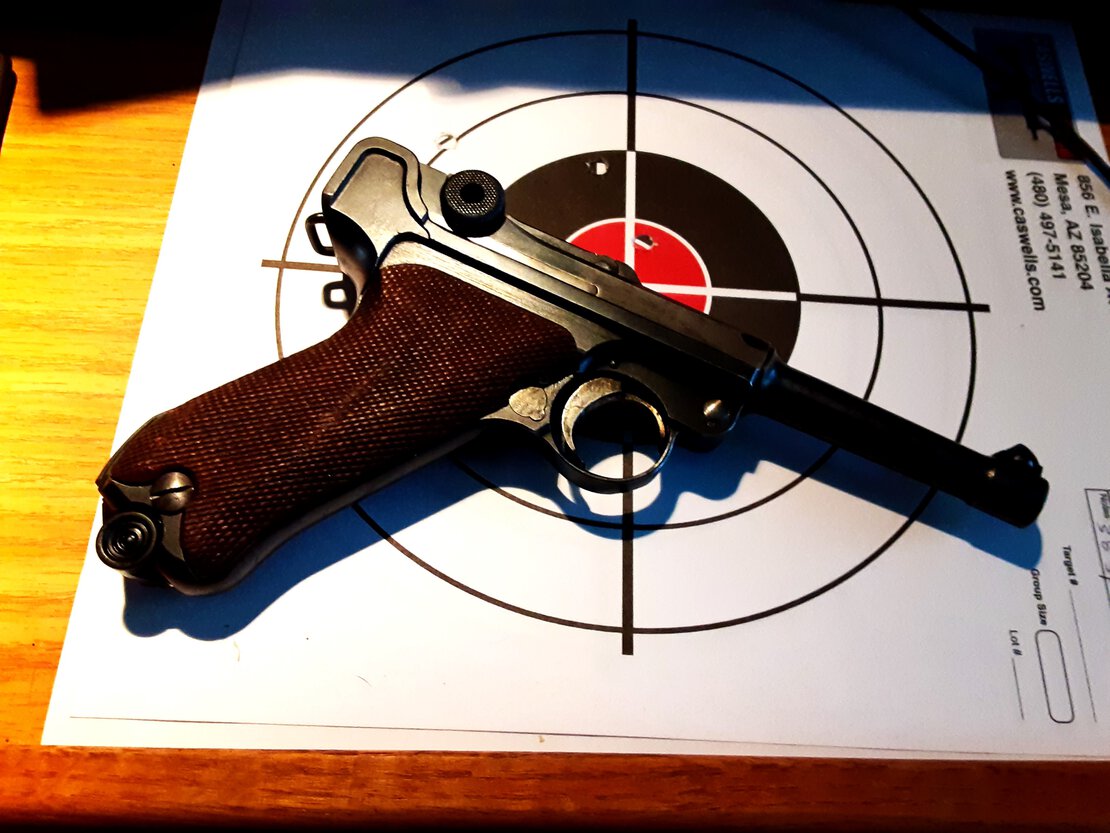

Hi, Luger Forum people! I have an old Luger that shoots well after I replaced a spring on its extractor mechanism. I think about having it refinished now and then, by an experienced quality gunsmith for these. Can you enlighten me on how the value will be viewed for this gun by collectors after a quality reblue?

Dear Gerald,
Welcome to the forum. Your photo is a bit dark but from what I can see the Luger appears to be in fine condition. I do not see an advantage in refinishing the gun, and it would significantly reduce the value. Moreover, from the strawed (yellow) parts (trigger, mag release), the gun must have a "cold" rust blued finish rather than the "hot" salt blued finish typically used on modern guns. In short, I advise you to leave it as is.
I encourage you to post more photos.

Dear Karl,
Thanks for your reply. I agree with not refinishing the gun, as it is great to shoot and not bad to look at as is. I was looking for confirmation from someone, just as you have given. I will post some more photos. The gun has all matching numbers, and I think the bore looks great for a gun of its age.

More pictures, especially of all markings, would help us give you more information. You don't mention caliber but the barrel mark 8,82 says it's 9mm. From what I can presently see, it's an Imperial German military pistol that has had the date removed but is otherwise pretty much as-issued.... except for the stamp on the rear of the frame. That is most assuredly not original to the gun when it left the factory.

I think it would be a sin to re-finish this Luger.
Plus done properly by someone who knows what he is doing would be costly.
Done improperly by someone who doesn't know what he is doing could be even more costly.
Bottom line you would be placing your #'s matching, possibly 'collector' class gun permanently into the 'shooter' grade class at best.
The stamp on the end of the receiver adds 'uniqueness' and would be interesting to research ... fun gun.
Your pictures present a Luger that I would be proud to own and enjoy.

This is an interesting Luger. Closeup pictures of the left, right, and top of the receiver would be useful in order to completely tell you what you have.
This gun should be a good shooter. I am sure you recognize that its condition removes it from the realm of prime collectibility. Having it reblued would certainly remove all remaining collecting consideration, and (depending on the skill and knowledge of the operator) probably physically alter the steel surface. It would not be worth the cost, in any case.
But here is a thought for you: if you want to improve the gun's superficial presentibility, consider cold blue. Remove any oil from the surface (do not otherwise prepare the surface in any fashion), and then apply cold blue to the bare steel patches. This will not damage the steel and can be easily removed.
This is heresy under most circumstances. It is something which I have never before recommended (and I expect stringent disagreement) and would not do myself, but honestly as a shooter it will not alter its value.
If it's mechanically excellent, don't do anything except maintain it properly.
We publish a FAQ reference document on this forum. Be sure to download it. Just follow the FAQ links at the top of every page. You'll find the information useful.
Take your pictures with a camera that can focus properly, and in natural shaded light without using a flash. That way the finish will photograph properly and we can see details.
You cannot improve a Luger by refinishing it. You'll spend money and probably reduce it's financial as well as historic value.
