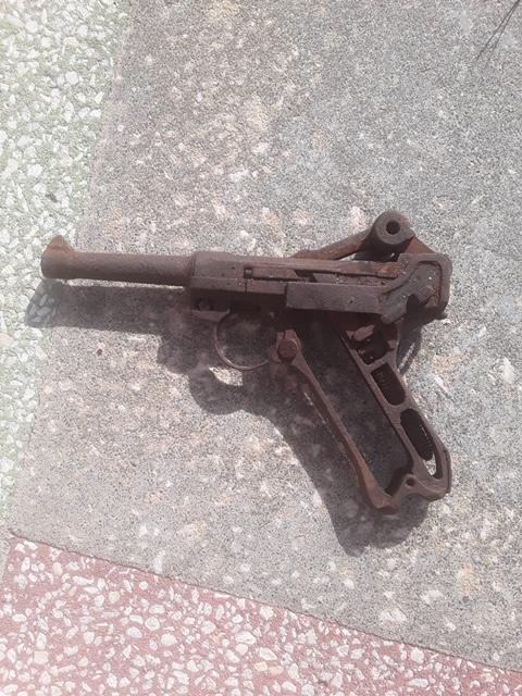

I'll try to make a long story short. A friend of mine bought a retirement home on the coast to retire in, about twenty years ago. About six months ago he was up on a shelf he'd never been to before. Wrapped in a rag was a rusted piece of junk that used to be a 1936 PO8 Luger. Serial number 7237 and according to what markings are left, was issued to the German Navy. It was missing a number of pieces. As of now, after much effort, work, trial and error, and a fair chuck of change, I have a Luger that fires. But here is the problem.

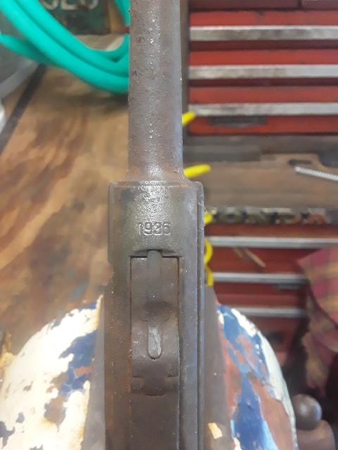

The marking for the "Kreigsmarine", or the Germany Navy is a script M just below the serial number in front of the trigger guard. I'll try to post a picture of that as well, as soon as I figure out how to post a picture.
If I've done this right, the first couple of pictures are what I got. One picture is a clear shot of the manufacture date of 1936. One picture shows the Navy marking. Not on my Luger, but one I found online.

If you restored that rusted anchor into a working pistol, my hat's off to you!
Tons of work. I can't image any of the small parts survived.
That luger looks like it was recovered from a sunken ship or submarine.

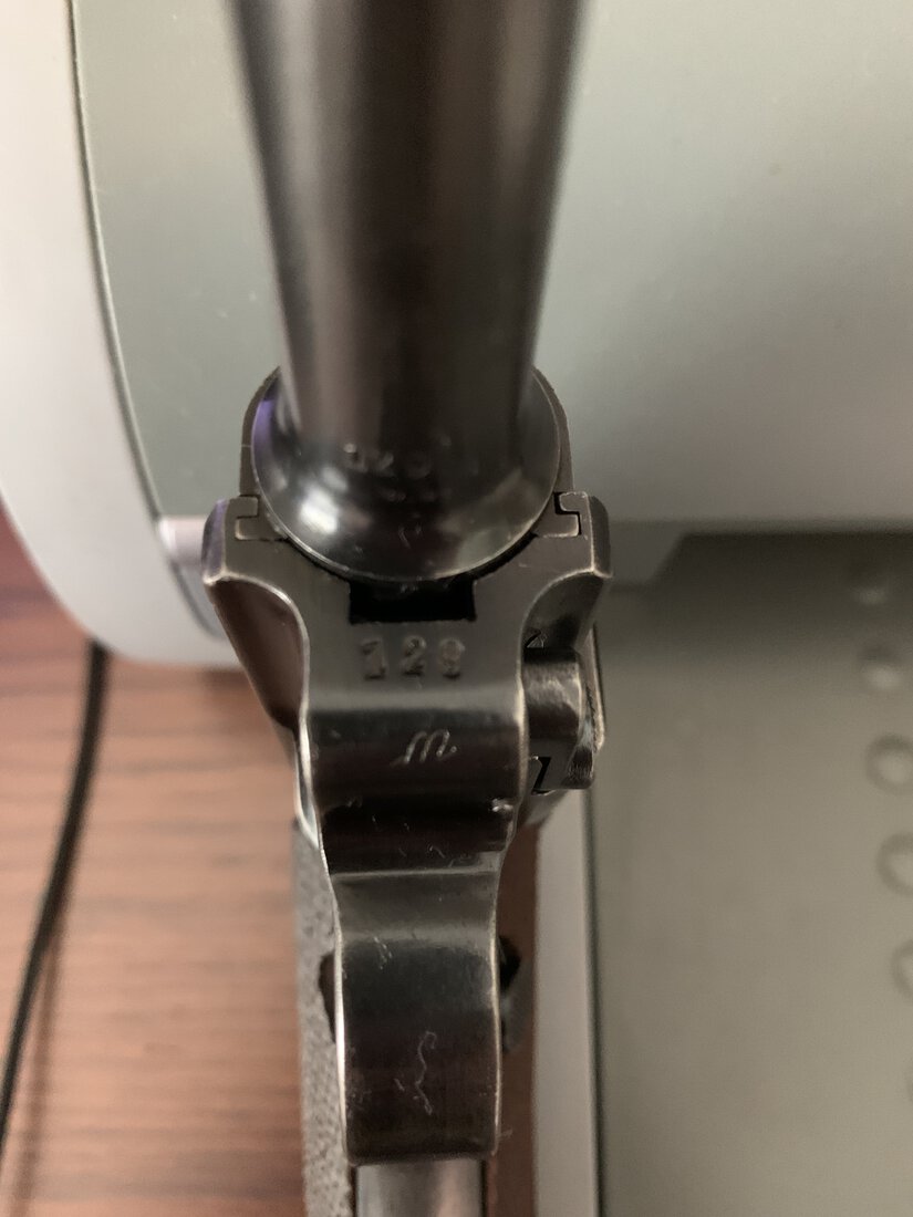

The photo you showed has a serial number (blurry, but looks like "329") and suffix "m".
I don't see any german navy marking. Can you point it out ?

Yes, the 'm' suffix is part of the serial number, but afraid it has nothing to do with the navy.
You have a 1936 (date) that likely has the Mauser code of S/42 and made by Mauser.
Oh, yeah. I can see the Mauser bump on the ear.

Ask and ye shall receive. Two shots of the M. One with and one without oil. The third picture is pretty much done. I still have to stain the grips. Sorry it's upside down. I will also say that the serial number didn't come through as clearly as you can see it with the eye. But I was shooting the M anyway. The number is 7237.

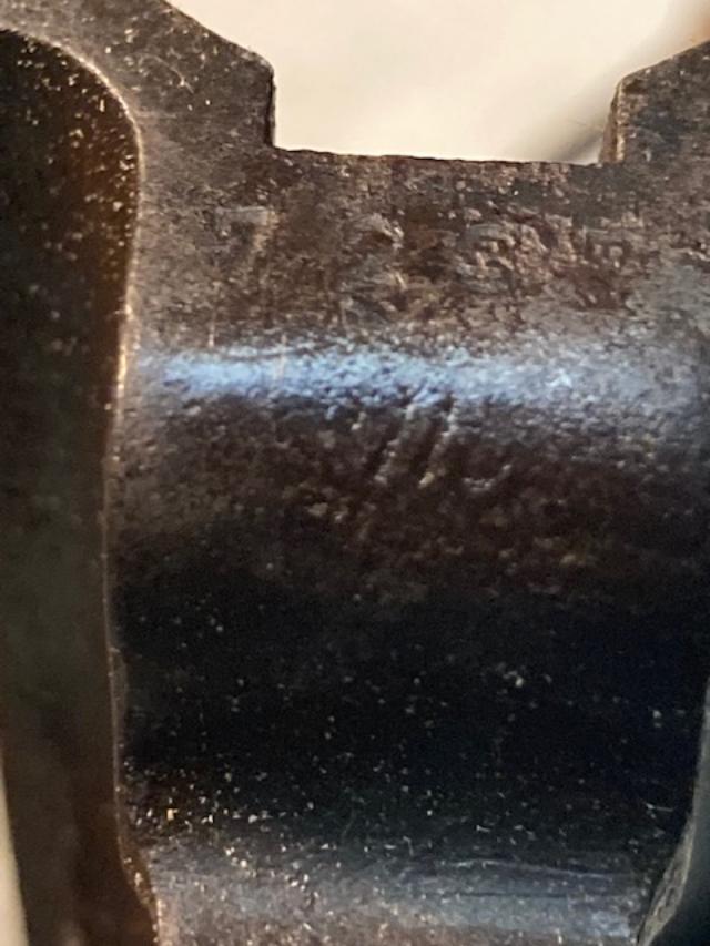

It is stamped S/42, so I guess the M does mean Mauser. One marking Which has me puzzled is inside the frame, under the lockdown bolt. It is quite clearly stamped H. I have no clue what that means. I've looked on-line but haven't found anything.
