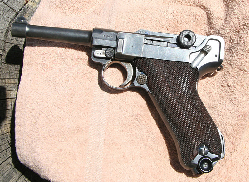

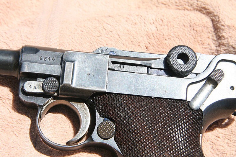

I'm new to Luger's and know just enough to know that I'm WAAAAY over my head.
A dear friend passed about three months ago. Last week his widow called and informed me that they'd found, "...some guns..." in cases in the basement. Yeah, I know, but this one really happened. Anyway, this was among the bunch.
From my very limited knowledge of Luger's, it appears to be a pre-war 1936 "i" series Mauser. All numbers with the exception of the magazine match. Gun retains 90-95% of original blue (assuming it hasn't been reblued...ears still show tool marks, all straw parts are correct color). Bore is absolutely pristine. Light wear on the normal sharp edges.
Magazine appears to be a late war issue (Pinned plastic base, no SN). It exhibits "fxo" over a "straight wing/37" and "P08" (upright) on the base and another faint 'straight-wing/37" at the top of the magazine with the magazine on it's spine. No visible proof marks. A Type 6?
Both my friend and his wife were/are anti-firearm and the guns were inherited. I don't believe that either of them realized what they had.
When I got it the action was frozen solid. Probably hadn't been racked in 30+ years. It took 3 days soaking to get the toggle open and do a light field strip. Still cannot get the toggle pin out to clean the toggle/firing pin assembly and really don't relish beating on it to try and force it.
The family is attempting to establish estimated value for estate purposes. Any information on history, value, etc. that you might offer would be greatly appreciated.

1936 is a special year for Lugers.....details are beautifully finished.....beginning in 1937, detail finishing began to be replaced with less effort because of the need to increase production............
most of mine are 1936, by choice......

Lovely Luger - it's a keeper !
really nice pictures, too!

Re: Pics...The FAQ really helped, but I forgot to put the year in the post title. Oh, well...next time.
Had to take the gun outdoors. My shop lighting wasn't bright enough to give me the depth-of-field that I needed, manual exposure on a tripod didn't work out, and I didn't have a soft-box or off-camera umbrella to use. On-camera flash gave too much glare/reflection even with a diffuser.
This photo stuff was a lot easier 20 years ago when I could see.

The pistol has a retail value of $1850 to $2000 if all matching and in original finish with that magazine and in that condition. A formal appraisal could be done, but for an estate, that estimate should be adequate.
You can use a blunt flat tip bamboo chop stick and a polymer faced hammer to gently tap out the rear axle pin once you have relieved any firing pin tension that might be on the upper. Be sure to completely support the receiver while gently tapping. The pin only comes out to the left (numbered) side of the receiver. Don't try and remove the other axle pins once the toggle train is out of the receiver.
If you do any more soaking, pull off the grips. Be very careful when removing them - particularly the left grip. Lift it just enough to slide it down from the area of the safety lever to avoid chipping it in that area.
It is a very nice Luger and appears to be in high condition. If the new owners have political issues with firearms, do your best to help them place the guns in responsible hands that will preserve their history.
A side note, my 1936 Mauser made Luger is also in the "i" block of serial numbers, a couple hundred earlier than this one. In this period, Mauser was still making Lugers using the rust bluing technique, and these are some of the last of these before transition to salt bluing, which started in 1937.
