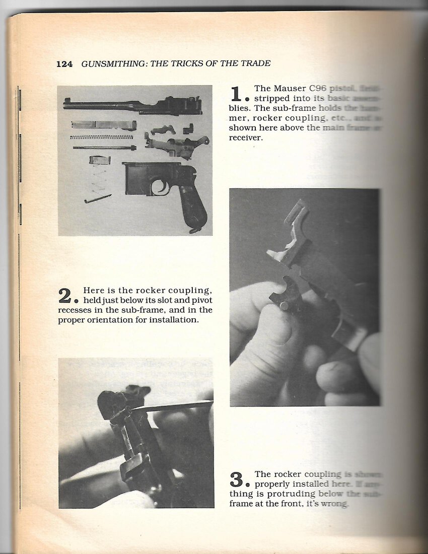

Hi to all! I have a C96 broom handle coming in the is stuck and cannot be disassembled? I have heard of incorrectly installing a crucial part and they are then stuck tight? Has anyone had this issue and were you able to solve the disassembly task?... Let me know, I'd like to have some knowledge going in if any is available... best, til....lat'r...GT

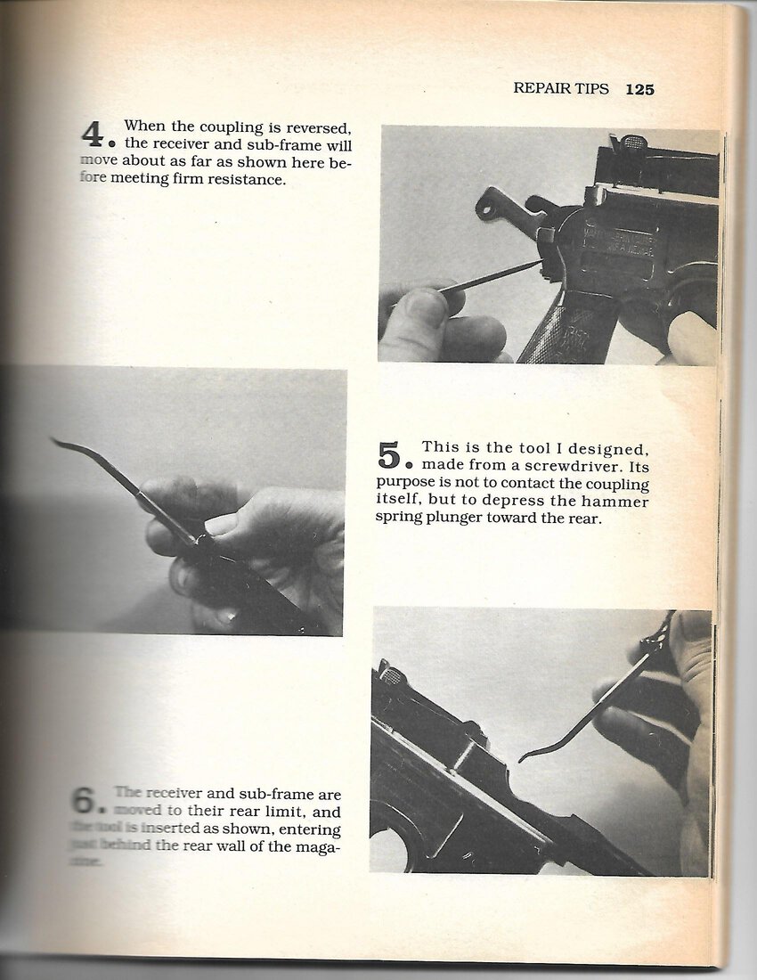

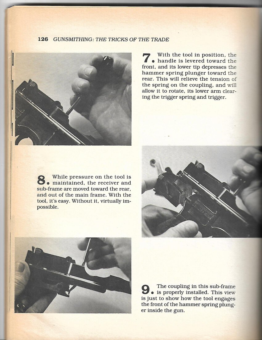

one method is to drill a hole to tip rocker tip down - another is to use a bent tol to depress rocker - i;ll look later to find description of tool use -

Default best i can do
find instructions starting on page 123 in digest book - gunsmithing : the tricks of the trade by J.B. wood -

Thanks schutzen-jager and Vlim, go the same article from him! Now I'm armed with a little knowledge! A dangerous thing!!! Best, GT....

Hello to all! So far, no good with any of the methods mentioned? This thing will not let the barrel extension come off! I'm going to clamp it in a vice and see if i can't get a better stability for prying as in the article? But so far, no cigar... It rattles back and forth about 3/8's of an inch, but then stops, and it's out of battery about the same... Not sure if i'm going to beat this one or not?... Best to all, til....lat'r....GT.....

took awhile + lot of tries , but method pictured did work for me - good luck -

I'm pretty sure it will eventually work out, just doesn't seem that way right now! I tried initially, with way too light of prybar... making another one this morning and with the help of my trust bench vice, we will attack again! The internet shows nothing on this and just seeing it work would be moral encouragement! More soon! Best to all, til.....lat'r.....GT...
