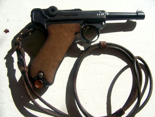

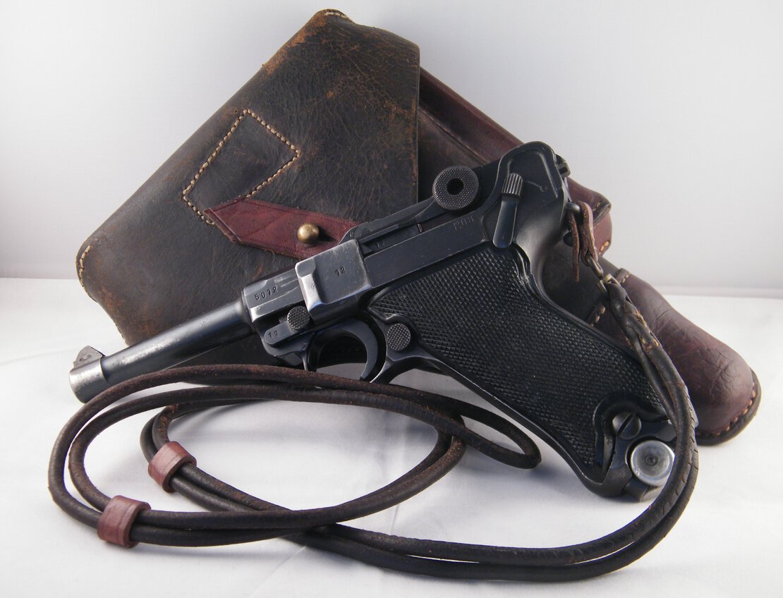

Shown before, but this is the Portuguese version.
Not uncommon in Europe as they came with the Portuguese Lugers through Frankonia in the 80s.
The tan color of the attachments and loops matches those of the holsters and holster repairs as well.
