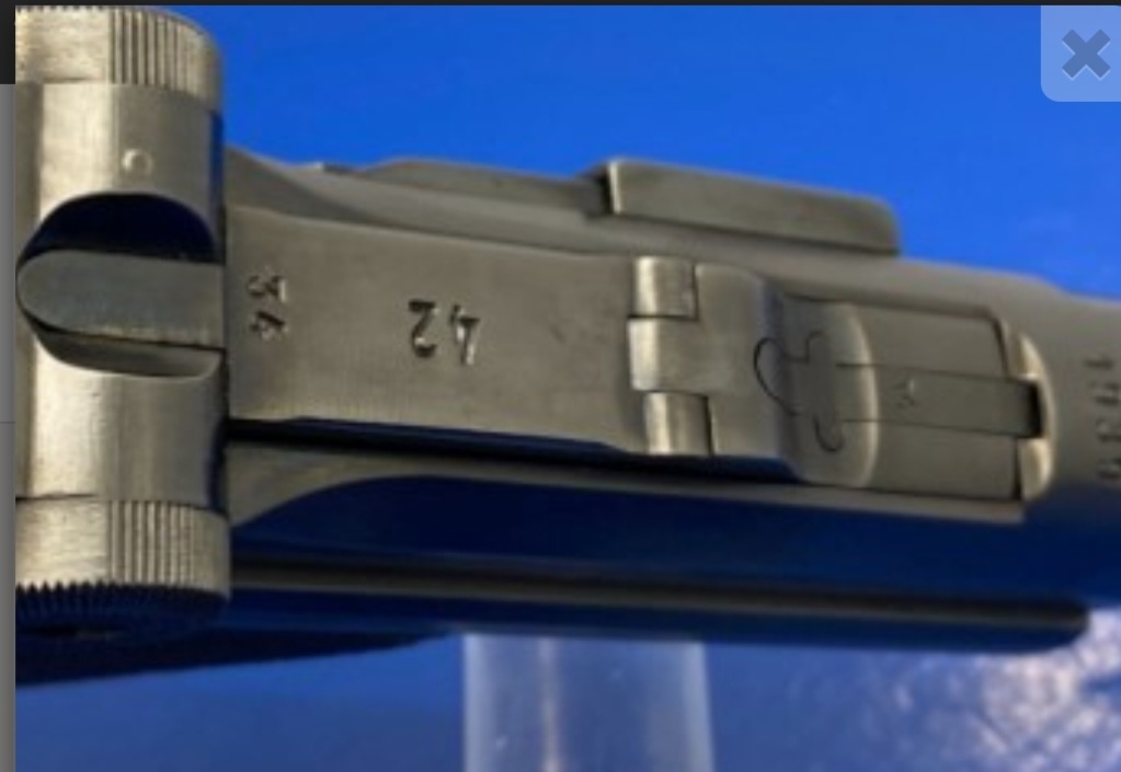

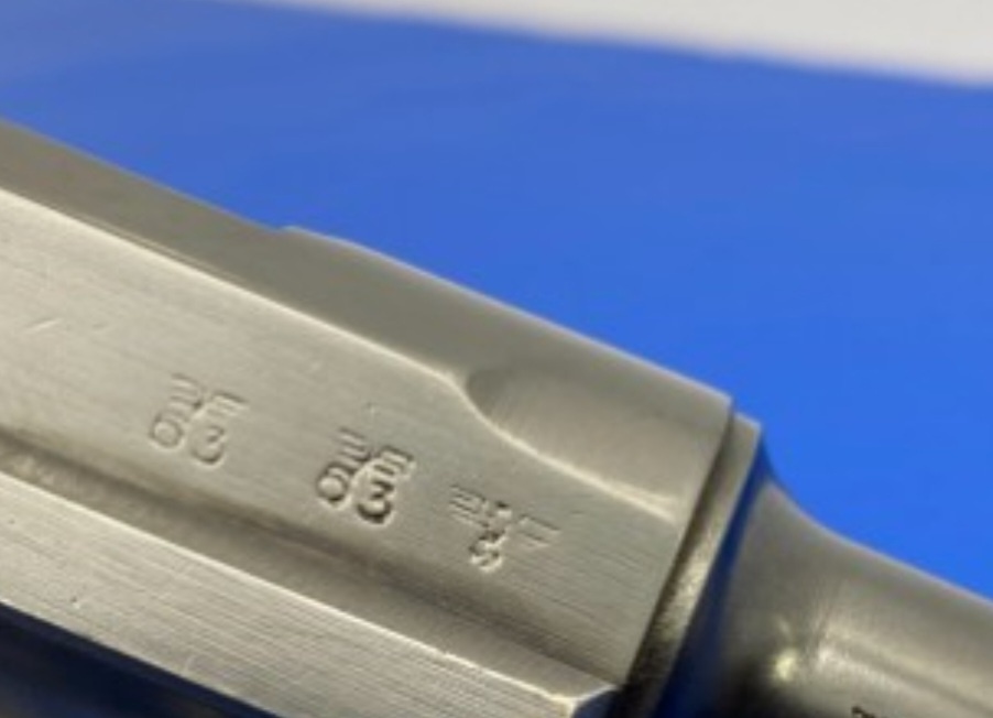

These are photos of markings and serial number

I'm just speculating right now, but the whole serial range dilemma can never be nailed down as absolute as there was almost always overlap between variations and their specific markings, plus "using up of old parts" has always been an undetermined variable as well?
But, if everything else on the gun was correct for a late variation 1939/42 then I would think it was just some overlap into the "no letter" range after the end of the "z" suffix? Start comparing font and strike size on the gun with other examples, it should become readily apparent if something is amiss? Good luck, might be your first major lesson in Luger collecting. Believe me, everyone here has been on the same cliff you currently occupy... Pictures would be great... otherwise, you've heard about all there is for now?.. best, til....lat'r....GT...

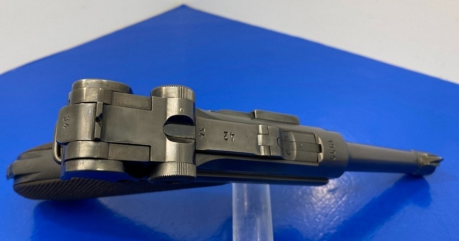

Default Additional photos
Here are a few more photos to help in identification for this series of the luger. Any help with athentification greatly appreciated.

Hi Troy, the picture we need is a very clear pic of the frame serial number and also the rounded part of the frame directly below the serial number? The suffix letter may be a bit below where you took the picture previously... The gun really looks nice? Others with more knowledge will probably jump in here... best, til...lat'r....GT

I definately see a stamp under the serial number location. I thought it was just a marking. Going to have to ask for a clearer photo to see what it is. Will change everything if it is a suffix code. Thanks for the help. Will send a request to him.

I would guess the suffix was in the range of r-w, based on the medium size of the SE-63 acceptance stamps. (Hallop & Kant page 192).
I would like to see the full frame front and the top view of the chamber and toggle, too.

Default Toggle view and more photos
This is what I have of the toggle and top of the gun

It definitely has a suffix letter. I can't be certain as it's not sharp but it looks like it MAY be an s.

It looks like this pistol, 734, was refinished. Is that correct? The stamps on the receiver look buffed.

Hi Aldo35, I think that the acceptance and proof stamps were applied prior to final finish and buffing/bluing? So, not sure? You'd have to have in hand to really tell? At this point with the pictures available, I'm guessing it's for real... But, again, wouldn't bet the house on it? ... I recommended to Troy to pursue it, as if real, it is real nice!!!.. Best, til....lat'r....GT...
Follow up, I private messaged Troy and advised he inspect the unit further in order to determine originality of the finish? My gut feeling is, by the pictures shown, still, that it is original, but better and more clear photos might (probably will!) prove me wrong.. It will be interesting to find out... I'm at the end of my ability to add anything further, some of you Mauser guys need to chime in, maybe some comp pics of the proofs! Best to all, til.....lat'r....GT

The photos don't show sharp focus detail in areas that would be critical to judge the pistol, and the appearance may be related to the lighting that the photographer is using in the lightbox, but the impression I have from the barrel, front locking bolt, and edges of the acceptance marks is that the Luger's receiver (at minimum) and locking bolt has been refinished and buffed.
It's very difficult to judge finish without the gun in hand. Also, the seller has given you photo after photo without showing the key image of the front of the frame above the trigger guard where the pistol's legal serial number with the suffix letter is shown. They don't know Lugers.
i would be inclined to offer no more than a shooter Luger's value on buying this. Perhaps $1200 in today's market - more if I had it in hand and could confirm it's original finish and all matching.
is the magazine matching? Is it period correct? Was it manipulated to match, or factory matching? Good sharp photos would help us judge this, and it would add to value if factory matching.

This Luger has either been refinished or NEVER shot. The rear view shows NO toggle marks on the frame...to me. It could be my eyes or the photos, but that is what I see. I also see rounding of the takedown edges, and a few other areas that concern me if this Luger is being represented as all original.
