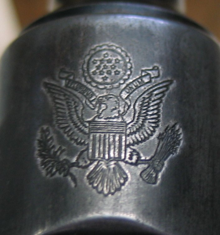

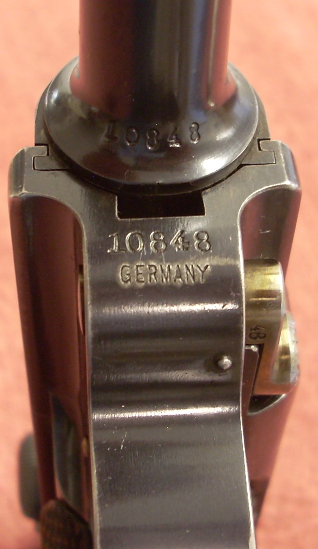

1900 American Eagle
Ser. # 10848
"Germany" Halo-Yes
"American Eagle" Halo-No
Proofs-none

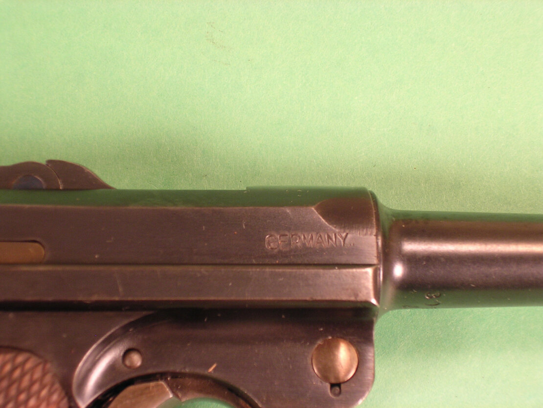

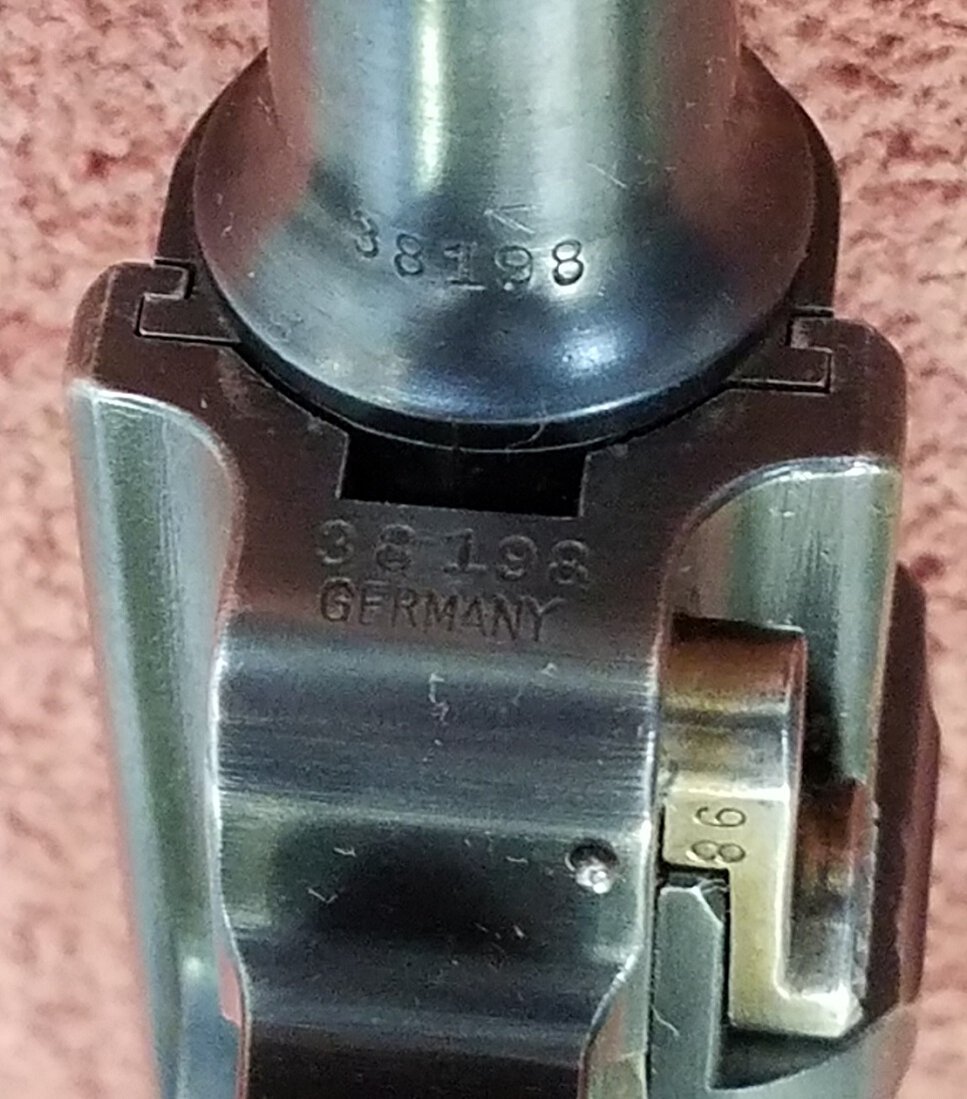

1906 American Eagle (9mm)
Ser. # 38198
"Germany" Halo-No
Proofs-None

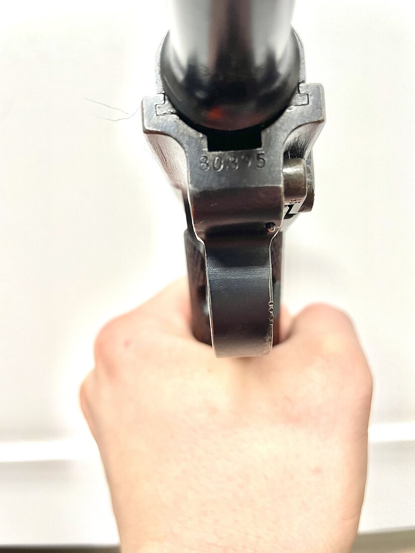

Standard DWM 1920 Commercial. .30 caliber, 3 and 13/16ths barrel
Serial: 80395
Germany Halo: Yes
American Eagle Halo: N/A
Proofs: Upright C/N. Also has a halo
File Type: jpg 08BA7EAE-091B-4697-A1B3-708BB998C8DA.jpg (147.6 KB, 2003 views)
File Type: jpg D7BB4852-575B-4DB5-87EC-6D1244A653D5.jpg (79.4 KB, 1986 views)
File Type: jpg D0873B02-6027-421C-98E3-9ED8977077AD.jpg (133.3 KB, 2078 views)
-QM

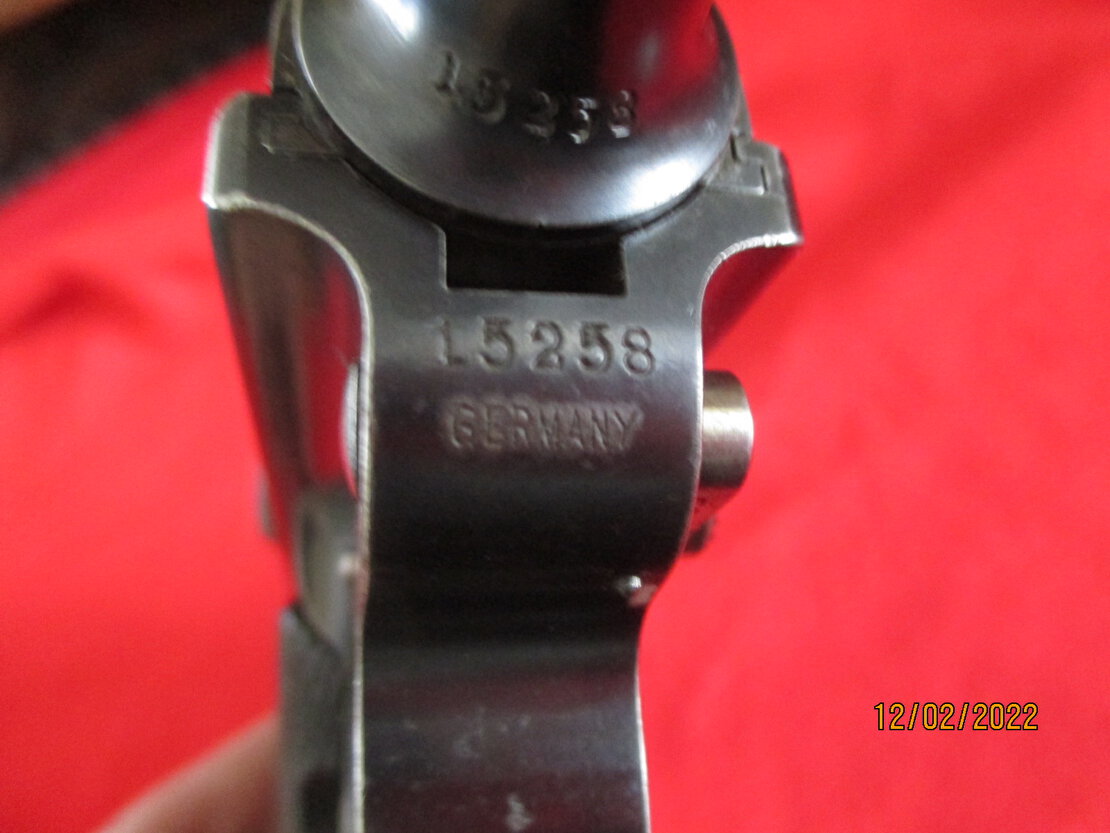

1900 AE
1. Serial number 15258
2.Germany halo: Yes
3.AE halo: no
4.AE present
5. No proofs
http://forum.lugerforum.com/attachme...1&d=1644709924
http://forum.lugerforum.com/attachme...1&d=1644709811

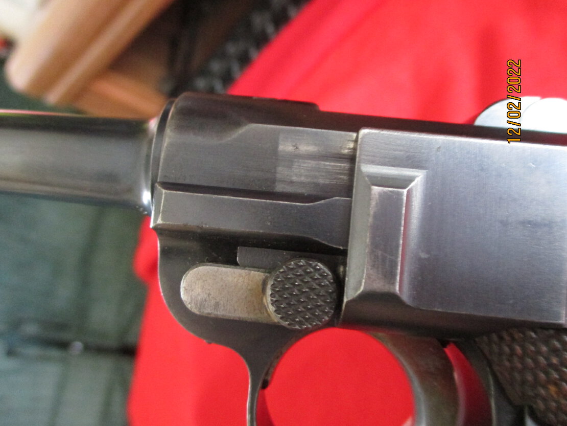

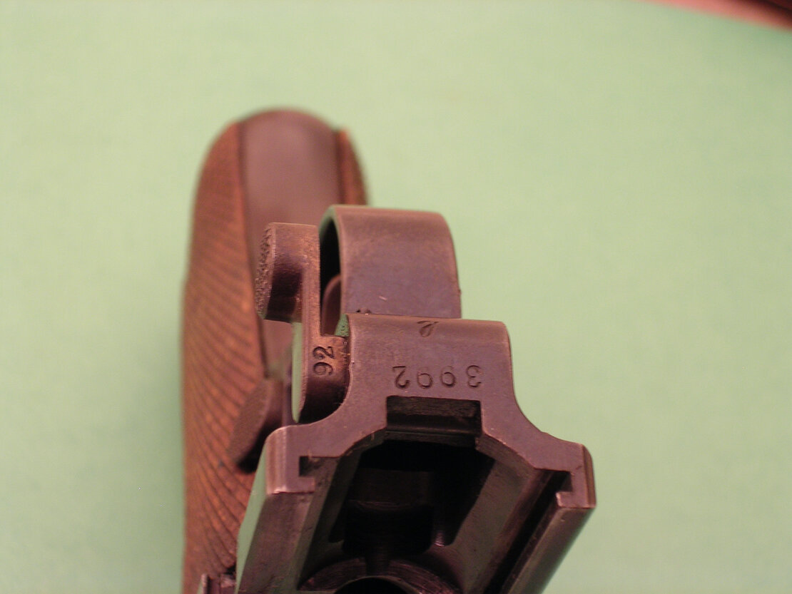

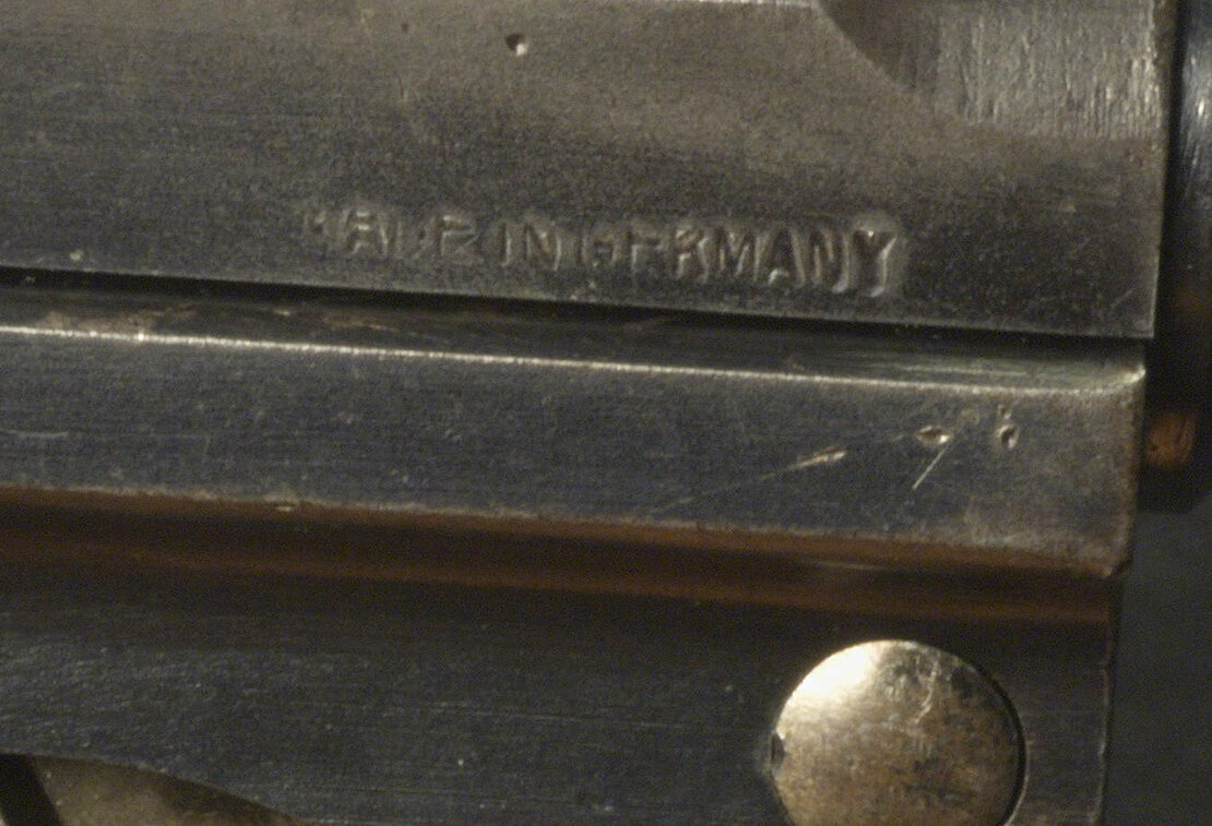

Dwight, here is the halo on the Germany stamp on my 3992 l with a vertical Crown N

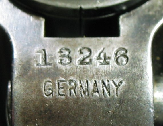

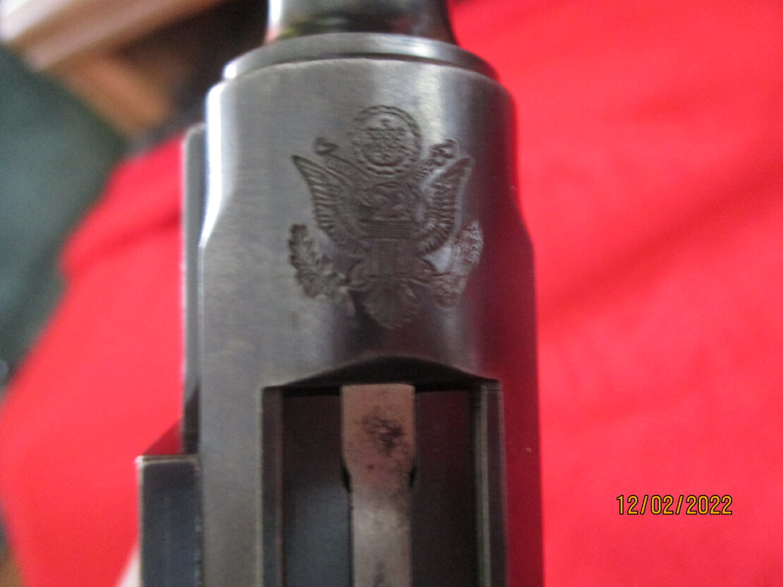

Unread 02-13-2022, 12:00 PM   #8
Serial number: 13246
GERMANY haloed or no: yes
American Eagle haloed or no: possibly
Absence of AE, i.e., a standard commercial model: ???
Proof stamp, if present: no
Pics attached. Additional info: flat-top breechblock; scalloped toggles; toggle lock; full-width grip safety; full-width trigger guard; 7.65mm x 120mm bbl; no proofs or acceptance stamps; serials + germany only markings; no stock lug; no 'gesichert' under safety lever.
I can not tell if the eagle has a halo; it may only be the slightly-rounded edges of the roll-stamping reflecting the light. Halo on germany is better viewed under less magnification.
Appears to be standard export model. IIRC, I looked in someone's database some years ago and decided it may be of 1902 manufacture...Bought from/with help of, Floyd at Simpsons...
Edit: The more I look at the eagle, the more I think it is haloed...
