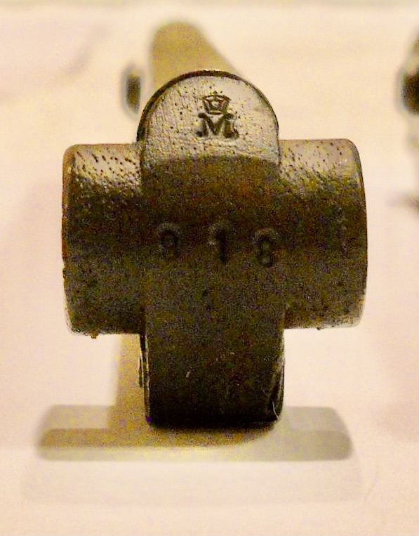

Mag 1 #918

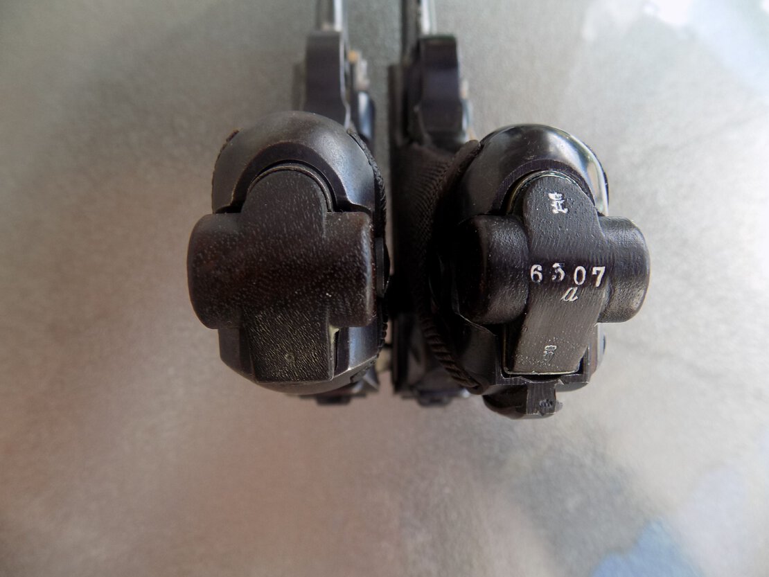

Mag 2 #3081 (2nd photo, number not visible)

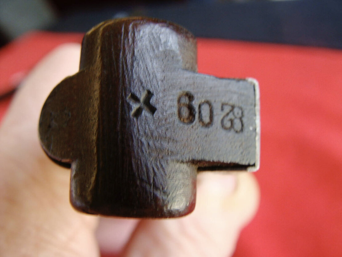

Mag 3 #3439

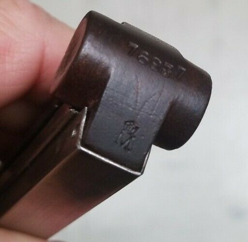

Mag 10 #76937

Mag 2 side view looks good

I will go with #9 and #2....#2 side view looks good as others point out, and we know some tubes are blued for navy mags.

#2 Mag #3081 (Blued tube)

#1 Mag #918, C/M inverted, numbers stamped cross-wise and too small.
#2 Mag #3081, this one is legit. I'll be discussing blued Imperial magazines in a separate thread.
#3 Mag #3439, C/M inverted, numbers too small.

#10 Mag #76937, C/M stamped at wrong end, the 5 digit serial # is too small and stamped cross-wise.
