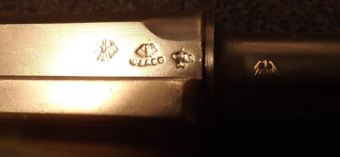

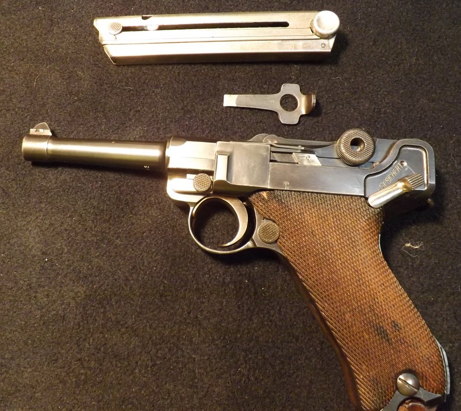

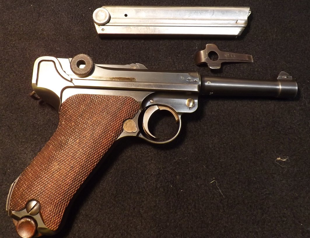

Hello All:
I am helping a friend to value her inherited gun collection.
I am not seeing the year or the manufacturing info that I think should be on top of the gun. Also inside the gun, I did not see SN markings.
Looking for ideas on what I have... I haven't seen any posts that are similiar....so far.
I have more Pictures if I missed something important
Thanks for your help!
Jeff

What she has is a police luger - it likely was sold as a 'commercial' straight to the polcie, perhaps through the army.
The FAQ here can be downloaded and help.
So, luger was made by DWM, guess is around 1929-1930 - pistols during the time period did not get a date.

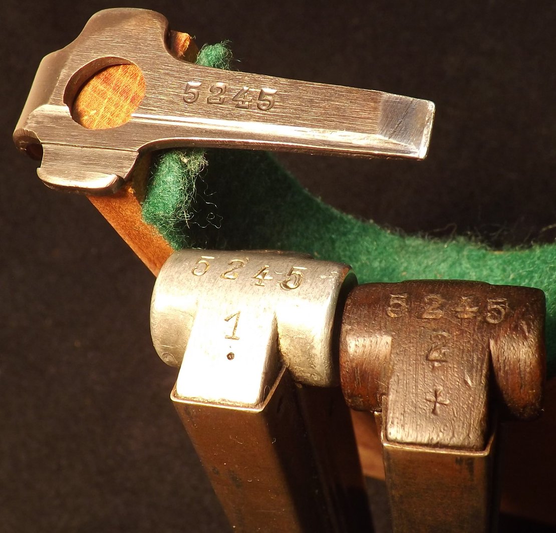

The two matching magazines are numbered 1 and 2 - which is correct for police.
Notice that the 'wood' mag has a " + " - this meant it was the second magazine, but in the army style. Either this luger was bought by the army and marked or it passed through them for a bit before being transferred to the police.
Originally issued two wood magazines, one would be blank with only serial number and the other would have a plus sign meaning second mag. Then as needed, wood magazine bottoms were being replaced by aluminum bases around 1926 time period - the number 1 mag got lost or damaged and a replacement in aluminum was supplied.

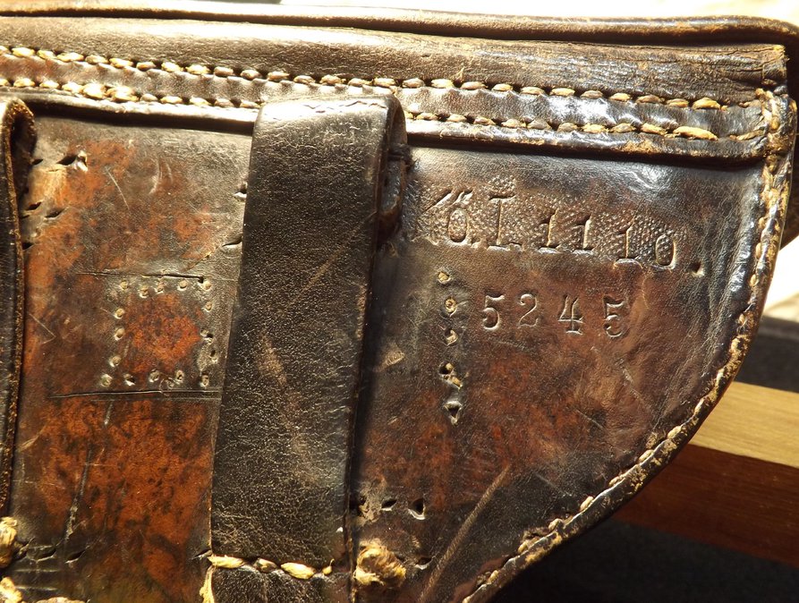

The holster is a shortened Artilley Luger holster, originally gorm WW1 and repurposed after WW1 for police use.
All in all a very nice set.

I know blank toggle links are possible, but that seem odd for a military pistol.
Also, isn't the magazine safety cut spot welded ?
And, then I have never seen a tool with the serial number stamped on it.

Your friend's Luger is an interesting one. It is a police Luger that had the sear safety installed (it's still intact) and the magazine safety installed then arsenal removed.
It could well have been assembled as one of the first put together when DWM assets were moved to Mauser in the early 1930's. The frame looks like a DWM frame, and Mauser reserved the "v" and "u" serial blocks for commercial sales.
They were transitioning from wood base to aluminum base tin magazines at about the same timeframe. The acceptance markings are Weimar era, so must be prior to the mid 1930's.
Unit marked "Kö" for Köln... Cologne in English. A large police force.
An arsenal police rework with two matching police magazines, it appears to be in good original condition. A nice collectible. Finish is hard to judge from the photos, but appears to be pretty nice.

It's a 1929 DWM, also called a 'sneak' because of the missing DWM toggle marking. These pistols were made for a North-African contract that was never fulfilled. The pistols were then diverted to the German police.

Looks like a very nice "blank toggle" police gun. The left grip was replaced at some point, as it is not cut for the removed/deactivated magazine safety.

Not all Police Lugers had a magazine safety. I would guess that the left grip is original. What a nice rig!! So unusual to find one like this.

That one did have a magazine safety. Look closely at the left frame wall to the rear of the side plate where you'll see the filled-in slot that was cut for a magazine safety.

I agree with Lyn that this is a very nice rig, however this rig most definitely had a magazine safety as Doub's has mentioned so the left grip is NOT original to this gun.
To help clarify Doub's point here is the required cut out for the magazine safety ... a picture is worth 1000 words.
