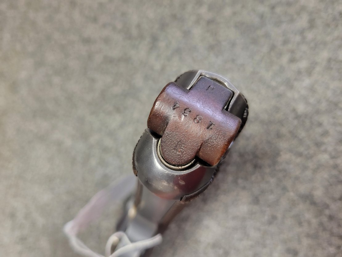

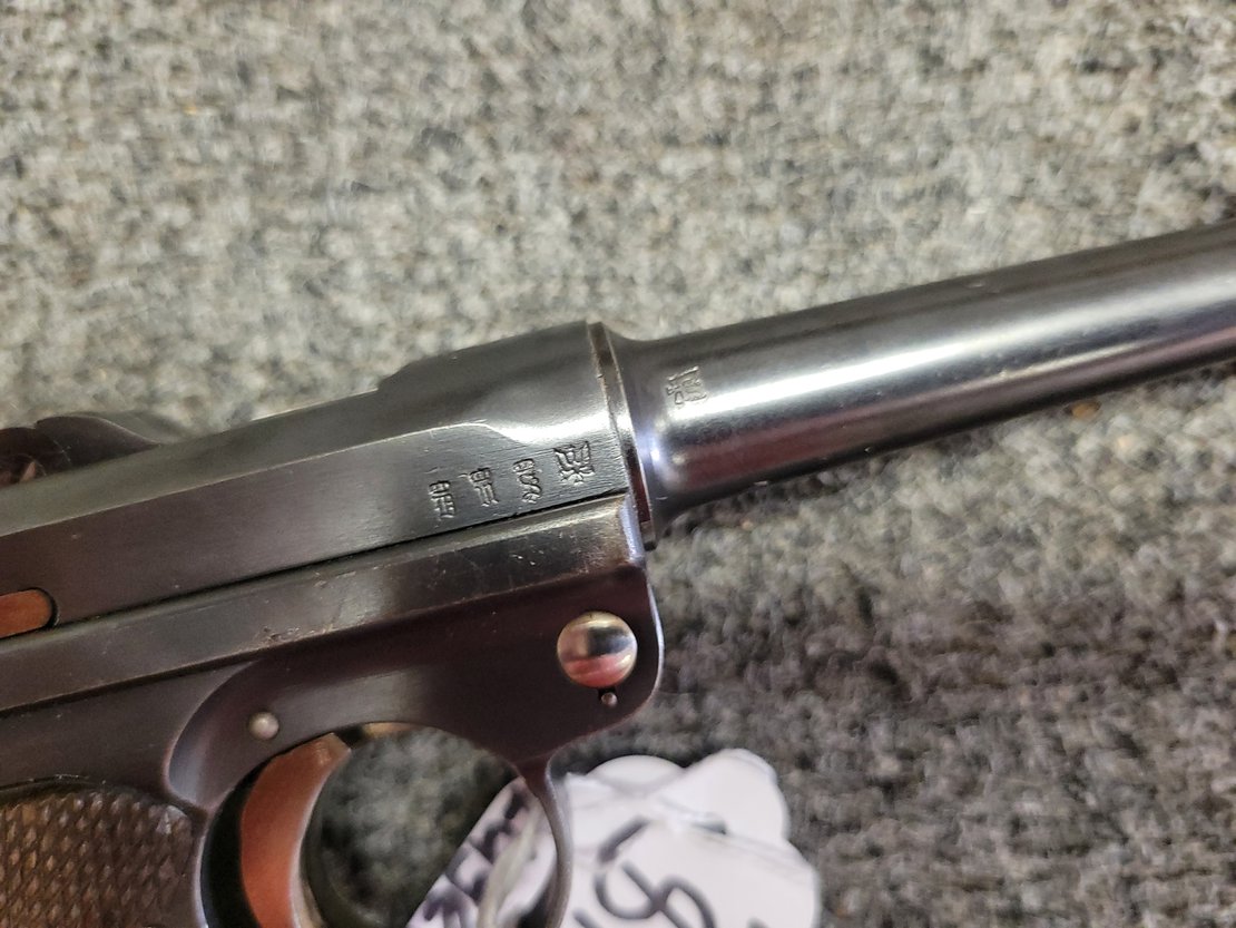

Default 1911 and 1913 Erfuts
Sorry for the quick post heres a couple Pics
they have a 1913 ( 1908 Patern ) also

Unread 08-14-2021, 01:54 AM   #7
Doubs
Doubs's Avatar
Location: Byron, Georgia
Posts: 1,745
Thanks: 828
Thanked 1,794 Times in 592 Posts
I believe that the scroll R indicates a reserve unit.
The 1913 may have a factory hold open and a stock lug depending upon when it was made in 1913. The earlier ones had neither or possibly a factory hold open and no stock lug. The hold open was mandated in a May, 1913, directive while the stock lug was mandated in an August, 1913 directive. Thus I think it possible for a 1913 to have the factory hold open but no stock lug... but that is speculation on my part. I would think that if any were produced that way, they would be very few in number.
Basically I'm saying that the 1913 Lugers could possibly be found in the following configurations:
1. No factory hold open or stock lug
2. Factory hold open but no stock lug
3. Factory hold open and stock lug
4. Early 1913 Luger without factory hold open modified by the Erfurt Rifle Arsenal to have a hold open and new front sight
The only one I'm not certain of is number 2

The 1913 does not hold open and has no stock lug
I did not break it down to see if it just has a broken spring
The 1911 does hold open
Good-Day is offline   Reply With Quote

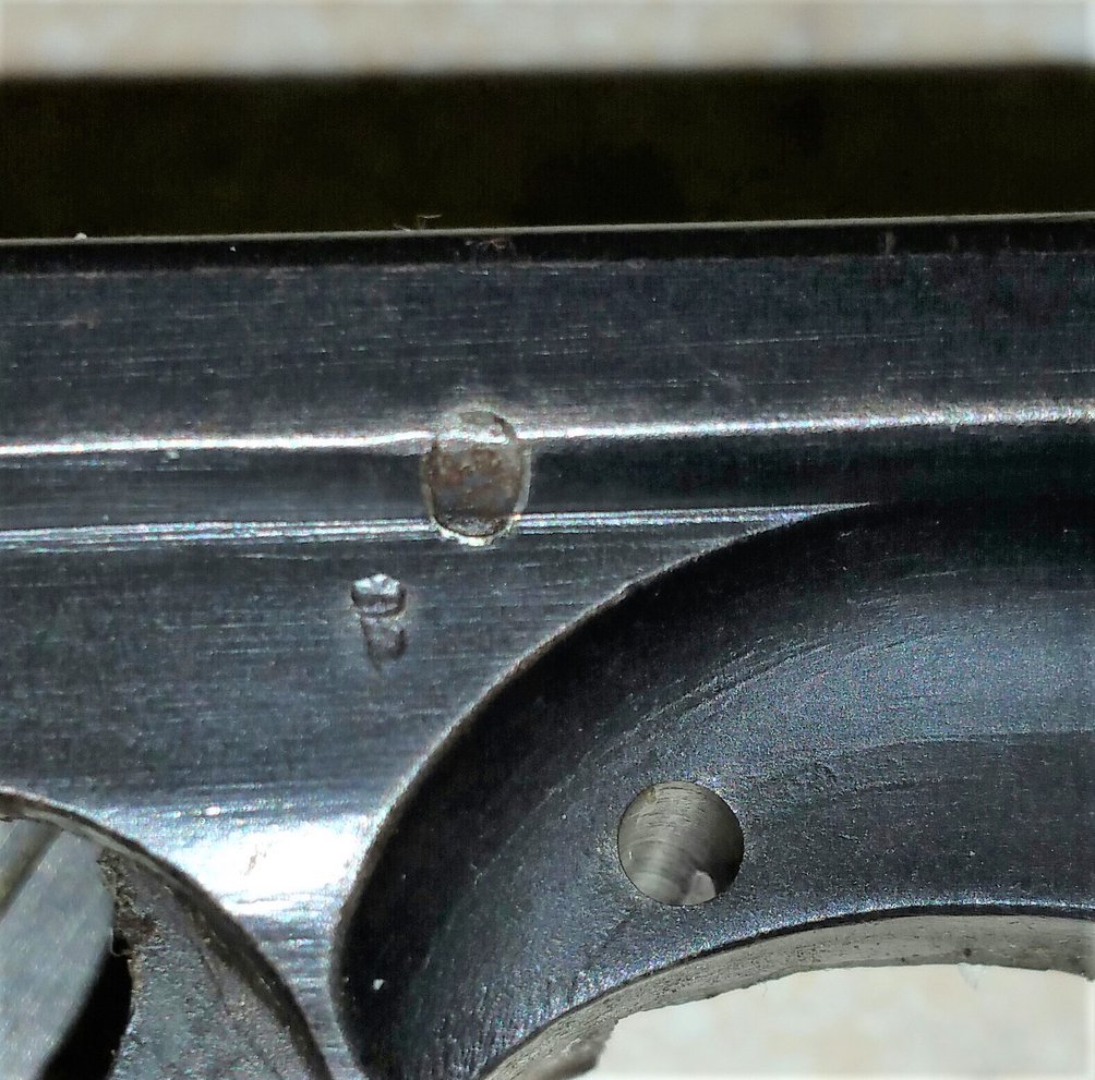

Unread 08-14-2021, 01:01 PM   #11
Doubs
Doubs's Avatar
Posts: 1,745
Thanks: 828
The 1911 was manufactured without a hold open. Many early Lugers made that way were later modified at the Royal Erfurt Rifle Arsenal (factory) to have a hold open. If you look on the right side just behind and above the trigger, you'll see a pin sticking through with a small crown over a letter stamped under it. That shows that the hold open was added after original manufacture. At the same time, the front sight was replaced to bring zero to 50 meters. Early Lugers were zeroed between 80 & 110 meters.
If the 1913 doesn't have a hold open, it was made early that year. Some units didn't return their Lugers to have the hold open added. The picture below shows a hold open and if you pull the action open on the 1913, you will be able to see if it has one or not.

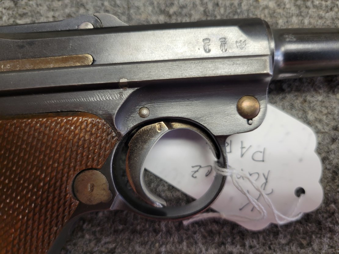

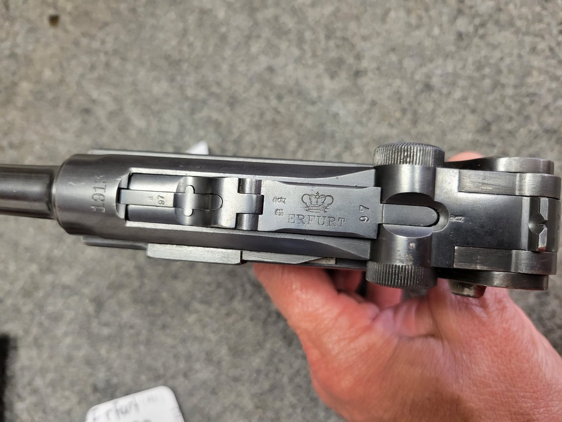

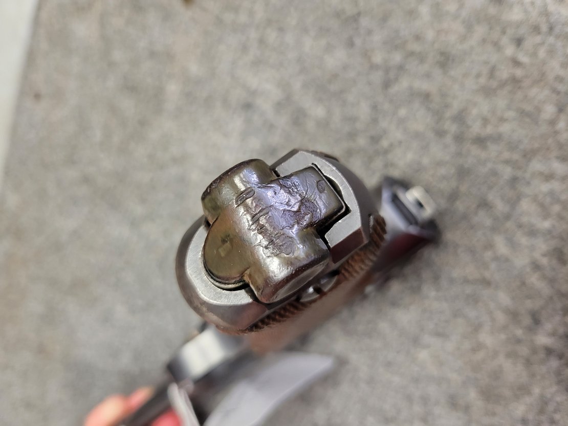

Default 1911 & 1913 Lugers
Cool Info on the Hold Open
Thank You
Added a few extra pics I had taken
Looking at the 1913 looks like it did not have the Hold Open or Mod
Now heres the hard part for me it's probably in my best interest to pass on these right now
But it would not be fair, as they are both kind of rare to not pass this on in case one of you wants to give them a good home
Almost forgot they also have a very nice DWM Comercial in .30 if someone is looking for a shooter
Sound Load in Everett Wa 425-252-2222
They are a really good people and they do ship
As always thank you all for your help and comments
