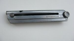

Unread 06-22-2021, 11:37 AM   #6
Are Haenel Schmeisser Magazines superior to a German magazine like a prewar Kreighoff?

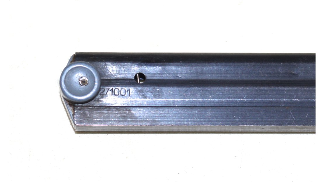

Unread 06-22-2021, 08:54 PM   #8

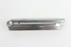

Whats the little hole for?
Unread 06-23-2021, 03:03 PM   #9
Posts: 3,401
Thanks: 7,560
So that the follower button can be tapped out when completely disassembling the mag.
Unread 06-23-2021, 04:15 PM   #10
pretty sure that haenel made both of these Eric.
Haenel made many of the mags for lugers (and other arms) over the years.

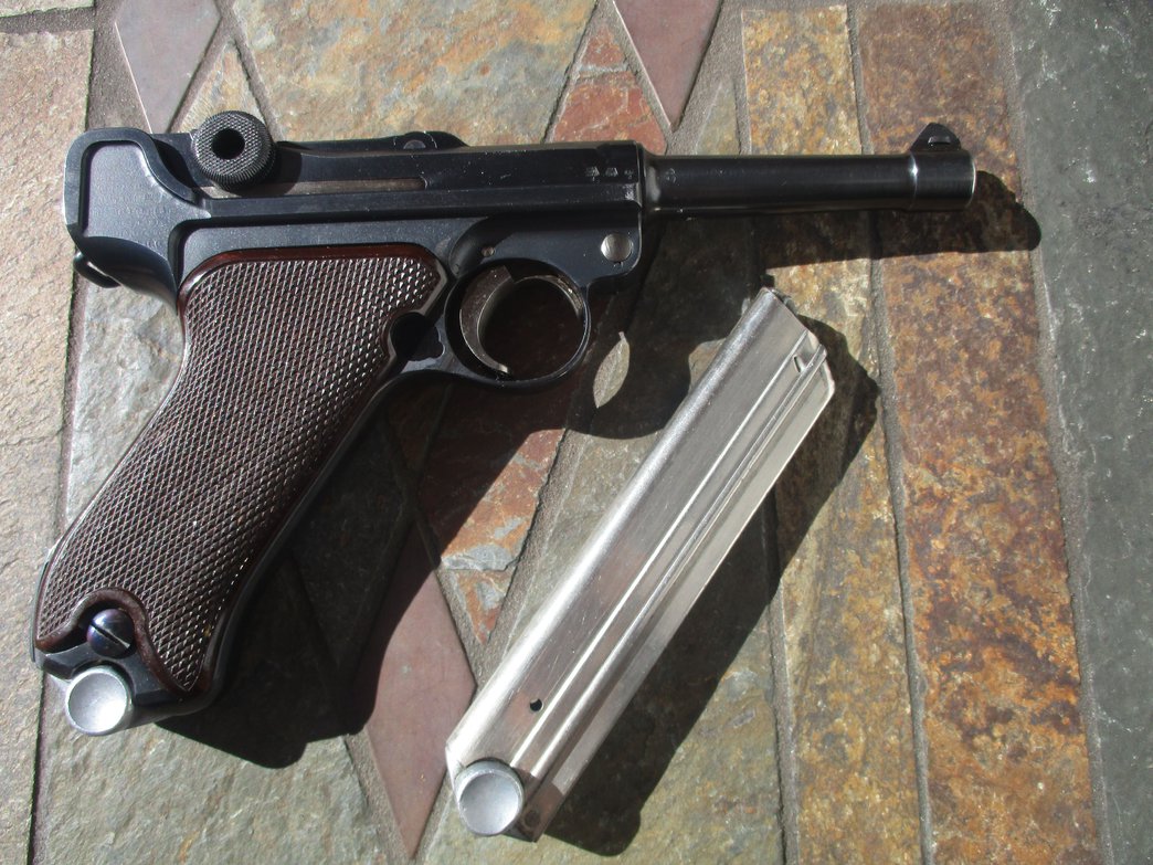

Unread 06-23-2021, 05:11 PM   #13
Where all makes as strong,, or well made? I think so!

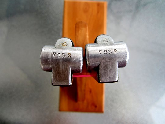

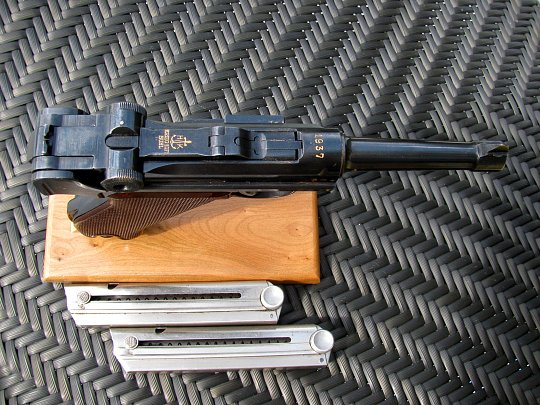

Unread 06-30-2021, 01:40 PM   #16
These two are #7932 from my 1937 Kreighof! The picture posted was to compare!
