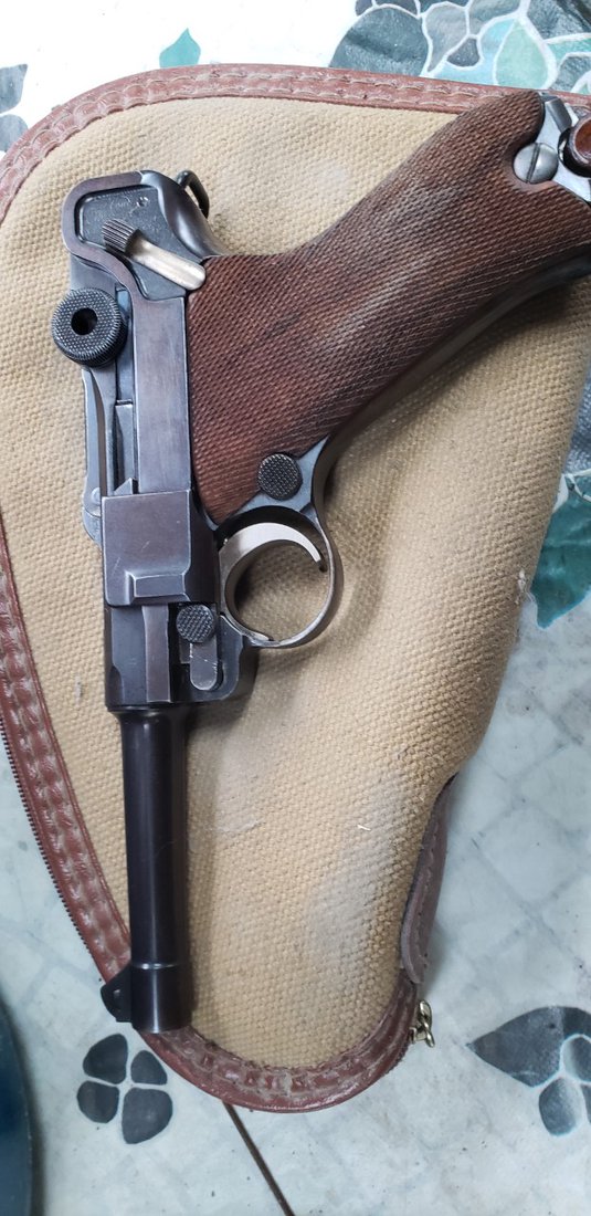

Default Commercial .30 --what can you tell me about it?
DWM on top of toggle. 8848 on front of frame below barrel. And below this--looks like an arrow pointing to this number of 8848.The bottom of the barrel in front of the receiver also has 8848 and above that --a crown with a N below the crown.And a character that looks like an arrow below the 8848. And a 48 on rear of toggle below rear sight. A faint N on left frame in front of side cover above trigger. Gesichert behind safety lever. The trigger has a 48 on it when the side plate has been removed. The back of the side plate has a 2 on it. There are no numbers on the other parts--not like a military issue. Wood bottom magazine . Stock lug on the rear of the grip frame. Looks to have been reblued--the rear of the frame is a brown tint around the safety lever. Circular machine marks on frame near the rear pin of the toggle.Ad light machine marks around the disassembly lever and above the trigger on the right side of frame.
Is this a Commercial 1920 or 1923? Sorry about the pictures--not as clear as I hoped.

From your description it's a 20's era commercial. Better pics are needed to help with info.

The "arrow" could be a suffix letter which would make it a commercial alphabet Luger from the 1920's. A picture of the "arrow" would help greatly.

It does look like a post WW-1 commercial.
It may also have GERMANY stamped on it if it was intended for export to the US.
Looking forward to better pictures and yes, outdoors is best lighting short of a real studio setting.
The suffix letter below the full serial number on the front of the frame is very telling.

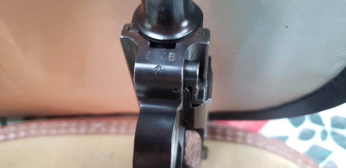

thumbnail_20210522_170013_4.jpg The character below the serial number seems to be a "r" in lower case. Both on the bottom of the barrel and the front of the receiver. And the barrel has the crown and N on it. The bottom side of the side plate has a 48 on it--I noticed. And a "2" on the inside of the side plate.
I have another question: DWM had a name change in 1922. It changed to BRIW. Does this mean that any Luger that has a DWM on the toggle--was made in 1922 or earlier? Or the toggle was made in 1922 or earlier?

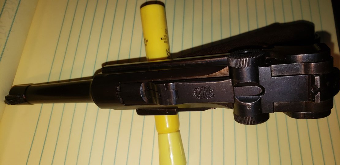

Some more pictures.

Attachment 83127 The character below the serial number seems to be a "r" in lower case.
It is in fact a lower case 'p' phoneman517191 and '48' is the last 2 digits of your guns serial number 8848 and should appear on other places both outside and inside your gun.
I can't remember what the '2' means on the inside of your trigger plate ... gettin old
"DWM underwent a number of name changes following World War I and the subsequent disarmament phase. DWM was no longer allowed to produce military equipment after World War I (although they continued on a smaller and somewhat secret scale) and the first name change was to BKIW (Berlin-Karlsruher Industriewerke or 'Berkawerke') in 1922. After the national-socialist takeover of power in Germany, the company added 'vormals Deutsche -Waffen und Munitionsfabriken' (former DWM) to the company name in 1933. In 1936 DWM reverted to its old name."
"Does this mean that any Luger that has a DWM on the toggle--was made in 1922 or earlier? Or the toggle was made in 1922 or earlier?" IMHO No, there are many knowledgeable members here that will be able to answer this question fully.

Your Luger's suffix letter is a "p" and it was likely made - give or take - about 1926. Being a commercial alphabet Luger, the last two digits of the serial number is stamped on the underside of the side plate and also the locking bolt, aka the takedown lever. The "48" will also be on the back of the rear toggle, the trigger as you've noted and other hidden places.
While the company name changed to BKIW in 1922, the DWM monogram continued to be used on the front toggle as your Luger was made well after the company name change.
The alphabet commercials are very well made but also the most common model of the Luger encountered.
