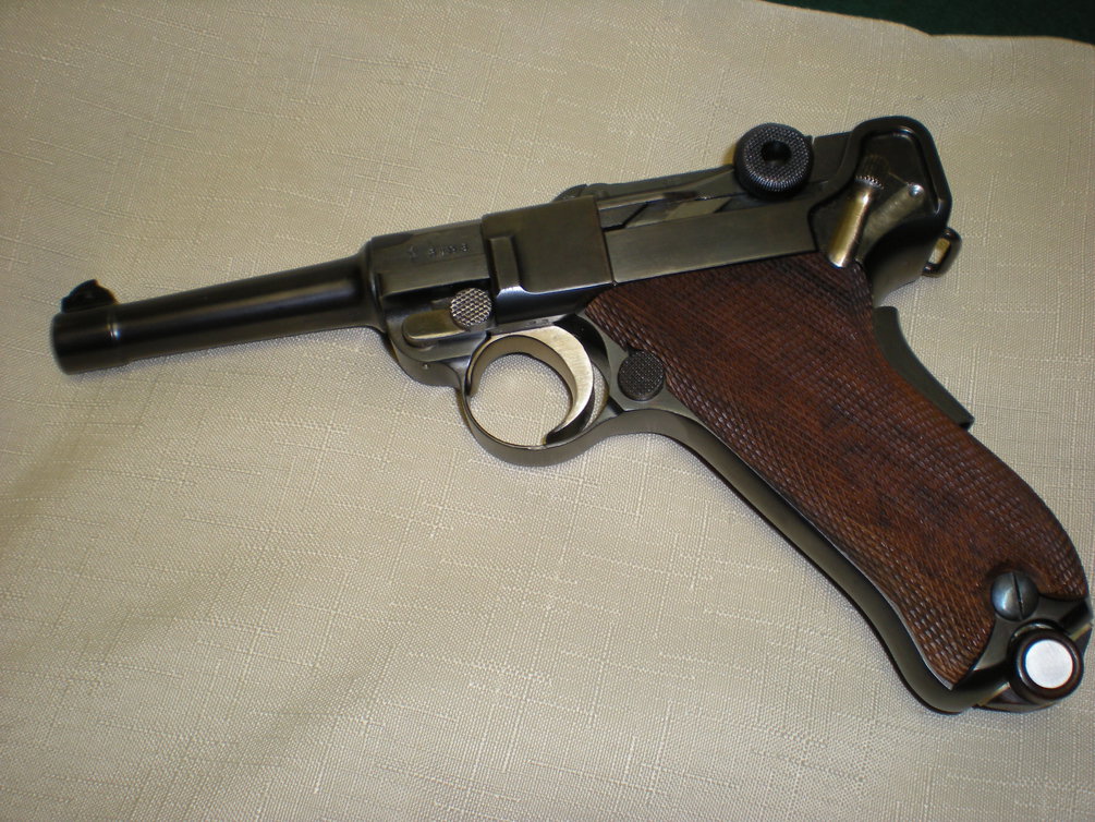

Could use some help identifing this swiss luger. pictures attached. Value would be a great help also. thanks

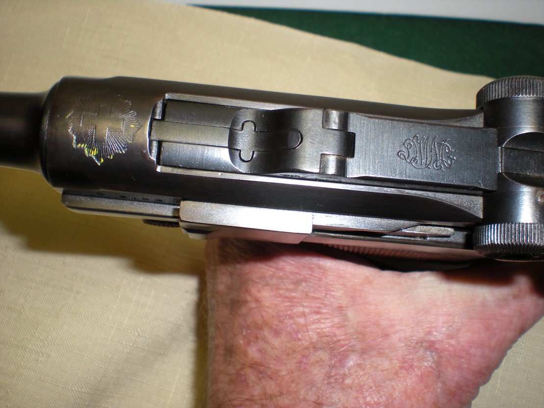

Looks to be a post-WW1 DWM model 1906 commercial Luger sold as a commercial pistol on the Swiss civilian market. It's interesting that it has the serial number on the left receiver in the military style but all else is commercial.
The cross in sunburst was used by DWM to mark Swiss commercial Lugers and also the first 9000 Swiss military 1906 Lugers. However, the crown/N shows that the gun was proofed in Germany and not by Swiss military authorities.

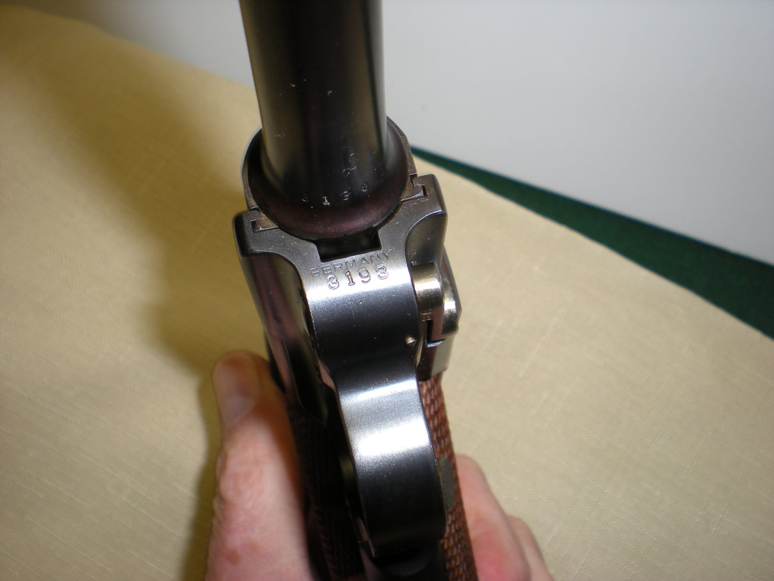

At some point, your Luger was imported into the US as evidenced by the "GERMANY" stamp on the frame.
That is a beautiful example of a commercial Swiss Luger.

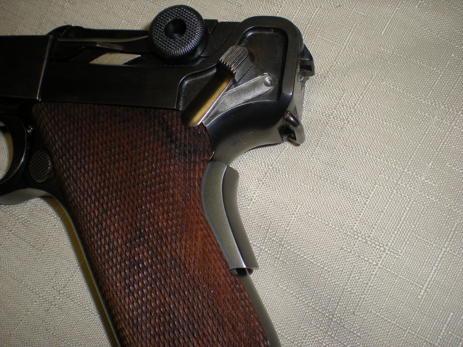

This pistol bears most of the characteristics of a Swiss Alphabet Commercial. In the difficult case of this pistol, this is identified by the blocky appearance of the left frame rail, without chamfering, ahead of the the sideplate. Beyond that it is hard to know where to start. To begin with, the gun has been refinished. This is identified most clearly by the re-cutting of the polished safety indication.

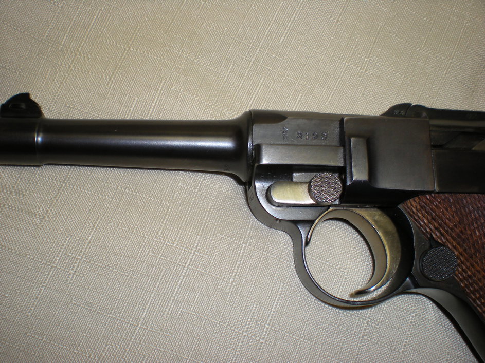

Re-finishing would account for the anomalous fame-front serial number. The number itself relates to no recognized serial range. It appears that the front of the frame has been considerably ground back (note the difference in length of the receiver where it meets the frame front) necessitating re-stamping of the serial number. The number stamps themselves do not match period number style, and a letter suffix has not been retained. The suffix would probably be i (most likely), n, or l. There is no independent way to identify this, as the frame suffix appears nowhere else.
The serial number stamped on the left receiver is characteristic of Swiss Alphabet Commercials.
The c/N receiver proof is evidence that the pistol was completed at DWM (not all were). There does not appear to be a proof on the barrel above the serial number. The photo is a bad angle for determination; a straight-on photo of that area would be useful.
The barrel with front sight is characteristic of a particular DWM assembly for the Swiss market. It is uncommon. Absence of a proof suggests a re-barrel. It is highly unlikely this would have been done in Switzerland, as the Swiss overwhelmingly preferred the 4 3/4 inch "pencil" barrel. In addition, a Swiss applied barrel serial number would have been stamped along the bore axis, not across. The barrel remains mysterious.
The magazine with its metal grip discs is a Swiss military item. The original would have had a plain wood base.

I'm not convinced that the pistol has been refinished. The toggle pin remains in the white suggesting that the toggle train retains it's original finish. The frame lines are still sharp and not rounded as would be expected if it had been refinished.
IMO, only a hands-on examination would provide a definitive answer as to it being refinished.
There are some pretty good refinish craftsmen out there. I think that if we could see a good picture of the pin it would be smoothed, that is, removed and reinserted. You are correct about the hands-on examination in the case of this pistol. A series of very specific, detailed pictures would go a long way.
