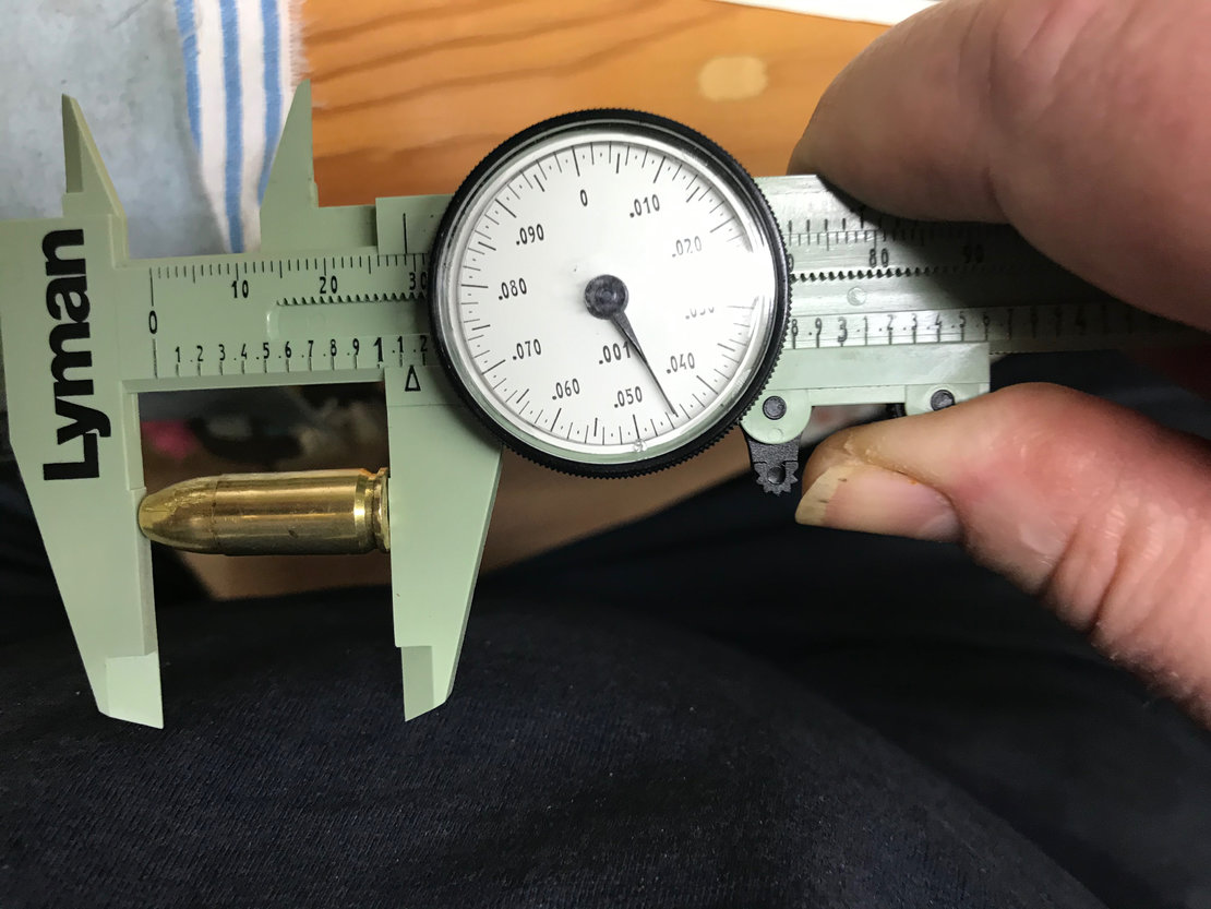

Default Comparing measures in 2 units-caliper
I've lost my first reply( took too long, I was logged out).
Now I've zeroed my caliper: good. Measured a 9mm cartridge first reading mm=29,15 converted in inches= 1.1476 rounded to 1.148 compared to vernier combined with dial measurment= 1.145. Difference of at least .003 inche. That's why I want to calibrate my caliper because I won't be sure of any measurment until I can gauge it. I understand that I will face many variables while reloading. But at least I should know for sure what's the real reading before I start reloading to expect some kind of accuracy.

WHY are you converting anything? Your calipers read directly in inches and thousands of an inch.
The bottom picture shows your 9mm cartridge COL measurement to be exactly 1.045"
Jerry is exactly right; you're over complicating things.

I'd ditch the plastic caliper, and get a Mitutoyo, or Starrett caliper. They aren't that expensive, and are much better tools. That's just me, though.
