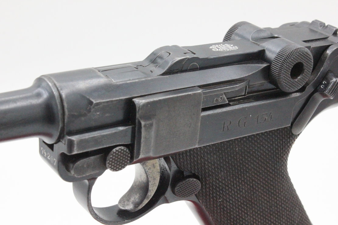

here is the sideview from my 74207 RG.154 !
Karl

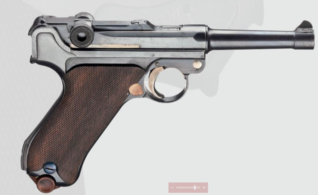

#74208 who was offered/sold at Hermann Historica auction.
Karl
