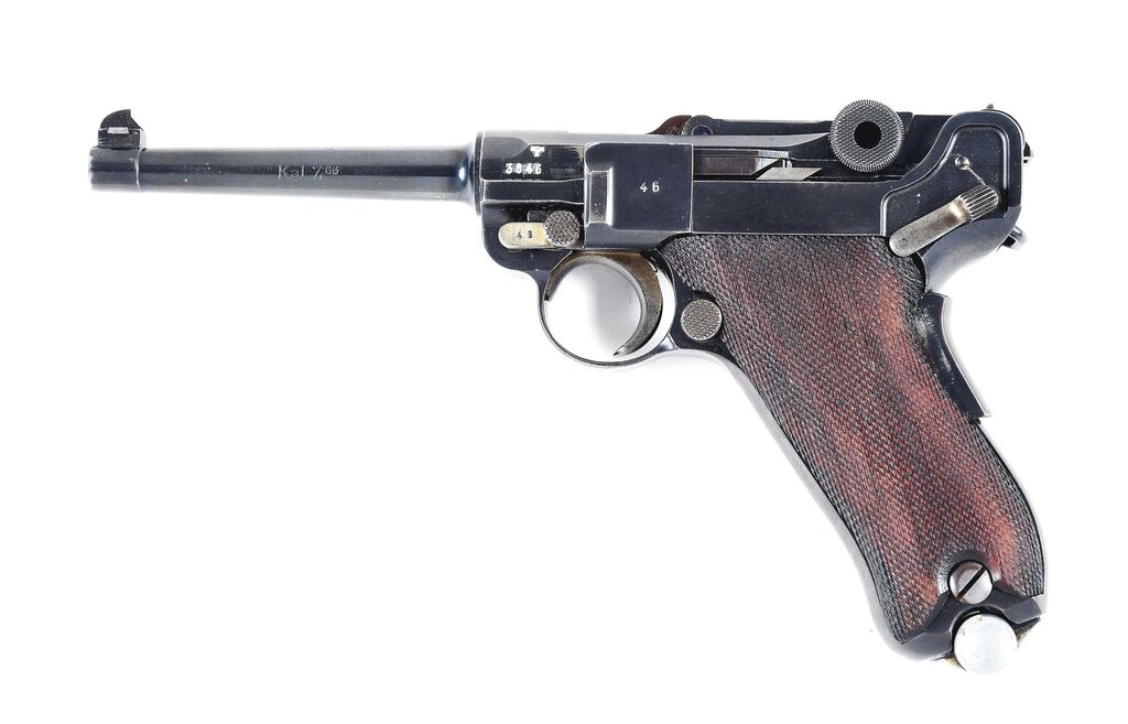

Default Swiss Sunburst and a Mauser Banner
Numbers matching.
https://www.proxibid.com/Firearms-Mi...99457#topoflot
Unread 07-06-2020, 09:12 AM   #2
Pretty strange; the description says it has a "DWM scroll" on the toggle, yet the picture shows the Mauser Banner.
I didn't think/know Mauser made or had any "long frames" until they made them again in the '70s.
Curious for sure, especially the chisel cut serial numbers on the front of the frame; I do believe this one is a "hoax" !
Unread 07-06-2020, 09:30 AM   #3
I've seen them before. Serial in the Mauser v-block, Eagle N commercial proof. I think it's correct and quite rare.

This Luger is listed in "The Mauser Parabellum 1930-1946" on page 471, Table 25.05. Jim
Thanks, Gerben. My Spidey sense tingled at this one. I knew Mauser had built some pistols for contracts, but am surprised that they made some for the Swiss.
Unread 07-07-2020, 12:40 AM   #7
Did you look at the close up of the serial number?
No way those are original numbers; they look like they were chased with a dull chisel . You can click on the picture for an even closer look.
JMHO.
Unread 07-07-2020, 08:05 AM   #8
Mauser also used to assemble pistols from parts they had left over. These were used for local purposes, like gifts to staff, local farmers for self protection, etc. So its not a surprise to find things that are not up to contract specifications, although the guns were functionally sound and proofed.
What you see is a serial that has been struck too hard and deep. Difficult to make out what exactly went wrong due to the whiting.

Note that the sear bar is pre-1916. That means the sear bar was made by DWM.
Compare the sear bar on my 1920 DWM Swiss:
If this was commercial production, why the military configuration numbers on the sideplate and the takedown latch?
If the Morphy pistol were a true Mauser it would have the "Mauser bump" on the rear of the frame. I don't see that feature.
I would like to see the stamps inside the front receiver well.
Smells like fish to me, but I am no expert. Perhaps it's made with leftover DWM parts that Mauser acquired when it acquired DWM. Some of you more knowledgeable guys can educate me.

Well, Don't assume that all the parts were newly made by Mauser at the time the pistol was assembled and tested for their Swiss contract.
There was likely quite a bit assembled out of sequence for commercial contracts during the war as "special" work that took second priority behind the huge government military contracts.
It's quite possible that a pre-1938 frame was used which had no "ears"... and a long frame originally from DWM would not be expected to have them either.
When master gunsmith August Weiss transported the tooling and gauges from DWM Berlin to Mauser in Oberndorf, the trains also carried a number of spare parts and incomplete firearms. IIRC an inventory was discovered documenting some of this. These parts could have come from that cache.
Unread 08-11-2020, 04:47 PM   #13
The artillery barrels, for example, were never made by Mauser, they used DWM stock from the WW1 era for the Mauser LP08 builds.
