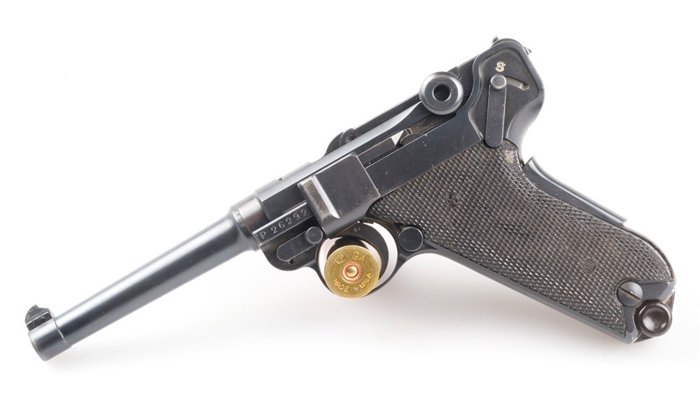

Default Swiss Waffenfabrik Bern 9mm Para Test P06/29 Luger
Found on Gun Broker, interesting variation on Swiss Bern 06/29 in 9mm no less. Looks like they want about 10x the price of a typical 06/29.
https://www.gunbroker.com/item/866036183

I would be very careful and do my homework extremely well, when buying a 9mm 06/29.
Most of the 9mm guns were rebarreled to .30 luger at the factory after tests were done. 9mm barrels were sold separately and used to recreate 9mm pistols many years later.
I have a factory letter inquiring about these conversions in the 1970s somewhere. Will look it up.

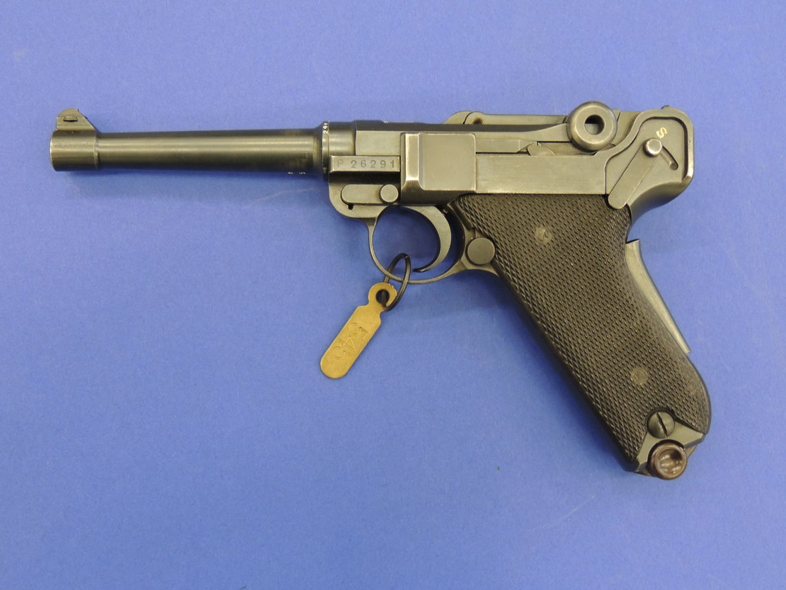

The attached document shows that the Pistol 06/29 with SN P26292 is a 9mm test pistol from 1943. The following pistols were tested in December 1943: SN P26291 to P26300 (the attached document mentions SN P36300, which is certainly a typing error). The letter P is not mentioned in the document because for the W+F it was not part of SN.
SN P26291 and P26300 have been preserved in the former collection of W+F (at present unfortunately stored and not accessible).
The gun presented here is most likely on of these 9mm test pistols.
Alexander

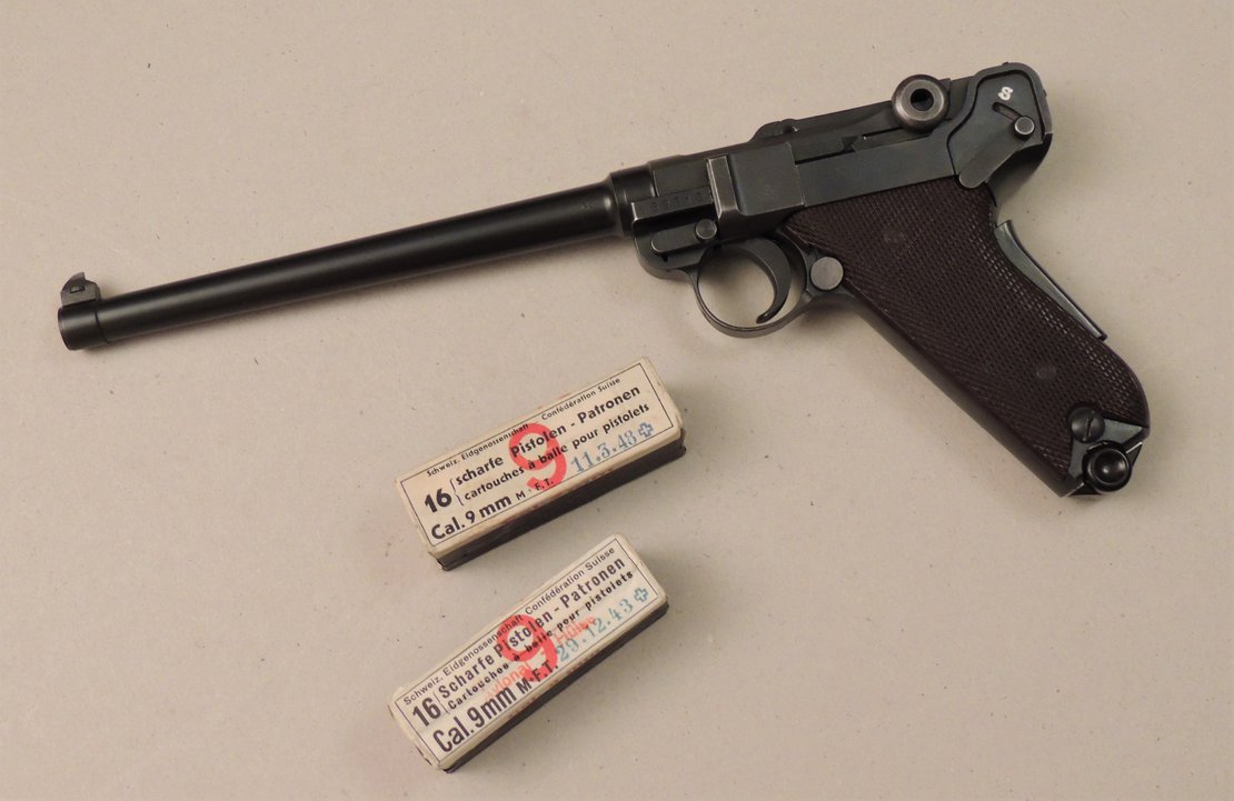

By the way, here's one of those pistols Vlim warned about…
200mm barrel, 9mm caliber. Until a few months ago, the barrel was still in white.
Shooting with this pistol is a real pleasure!

The question is whether P26292, and others, left the factory as 9mm or as reconverted. 30 luger pistols after the tests?
SN P26291 and P26300 are still equipped with the original 9mm barrels. I have checked those guns myself.
I assume that SN P26292 has also remained unchanged.
To my knowledge W+F has also sold 9mm pistols 06/29 commercially.

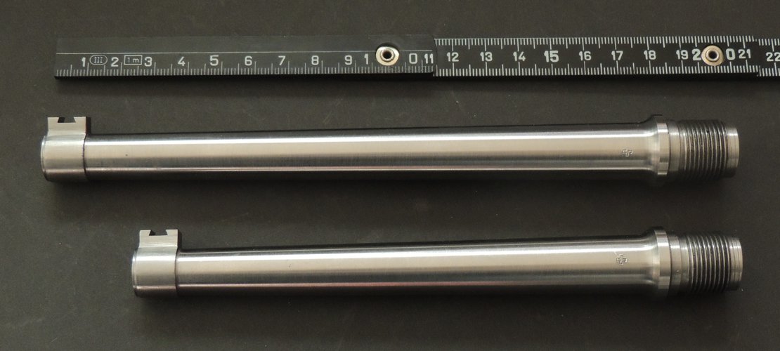

Unread 05-14-2020, 02:16 PM   #12
Drawing.
