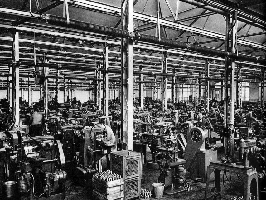

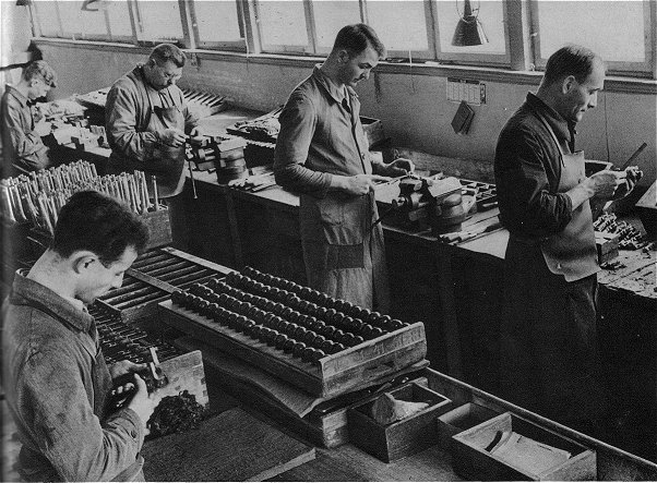

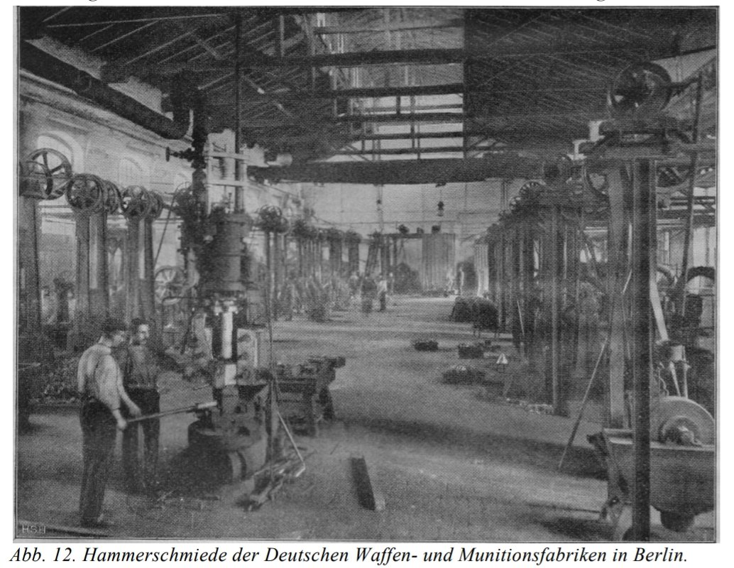

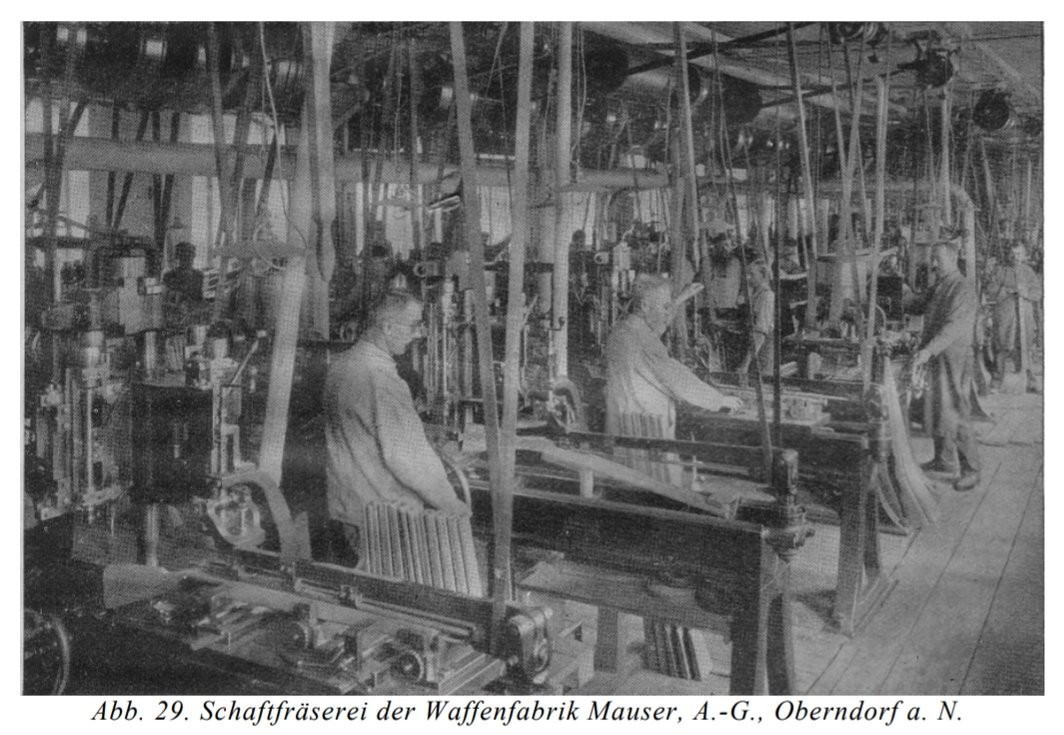

Unread 04-08-2020, 07:30 AM   #6
Some from 1913

Unread 04-08-2020, 08:08 AM   #7
Heinz
Heinz's Avatar
Location: Greenville SC
Posts: 1,004
Thanks: 377
Gerben, Thank you! Great photos.

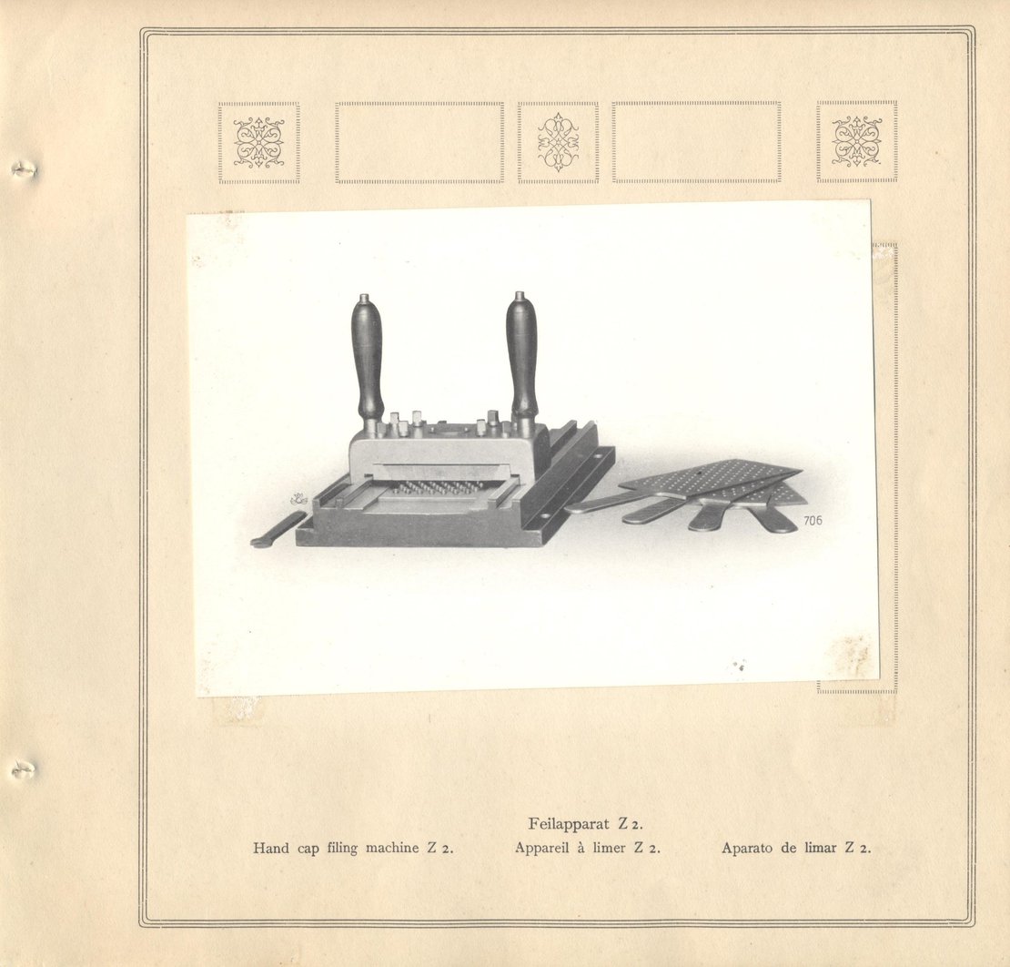

Unread 04-08-2020, 10:35 AM   #8
Loewe.
They not only made and sold tooling, but also tools to maintain and refurbish the tooling.
DWM was also specialized in ammunition production equipment and could offer complete manufacturing sets for ammunition component production.

Unread 04-08-2020, 05:03 PM   #10
Heinz
Heinz's Avatar
Posts: 1,004
Thanks: 377
I notice the overhead jackshafts for pulley belts are absent in picture 40 of the FN Herstal production. I see electric light fixtures but cannot tell if there are any electric powered tools in place.
The last DWM photos do show equipment with electric motors.
