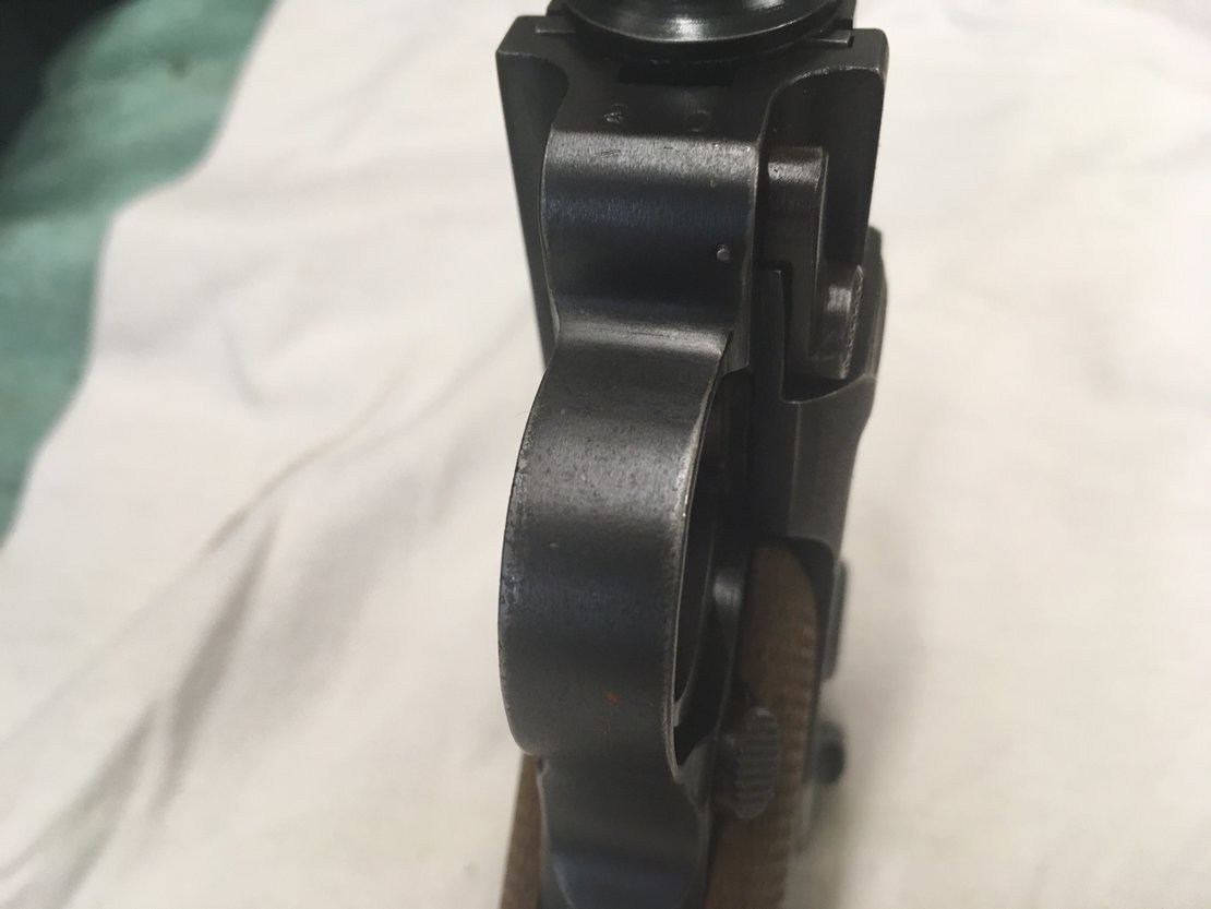

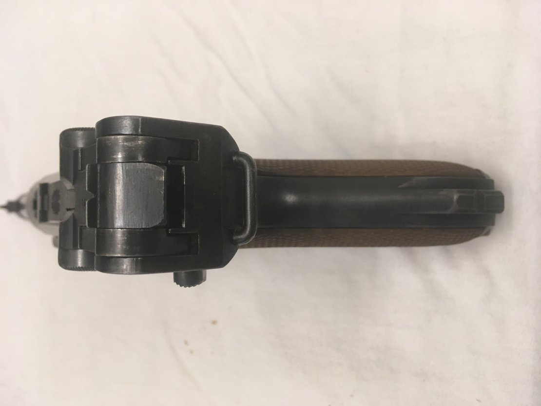

Is this what you are talking about David. It just seems strange that the number 20 is in 3 different places. It shoots very nice as well. Thank you all for your opinions.

Aside from the front of the frame, where else is it marked "20"?
The first of your last 3 photos looks like the front of the grip frame has been filed back to remove previous numbers. I say that judging by the curve in front of the take-down lever, AND the rails of the barrel extension sticking forward vs. being flush.
Also note the military location number (0) on the commercial side plate.
Things just don't add up to a factory gun, interesting as they may be.

I wonder if someone in the distant past, lacking the skills that Thor has, went to refinish this pistol? Had the work been done before the GCA 68, when serial numbers were mandated, the "refinisher" could well have stamped any numbers the owner wanted, and all this without nefarious intention.
And yes, if it came from an estate sale, make sure the receipt reflects the serial number presently on it. Otherwise, any examiner who looks at it in the future will have alarm bells going off.
