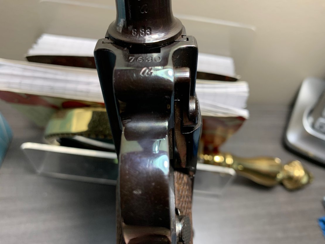

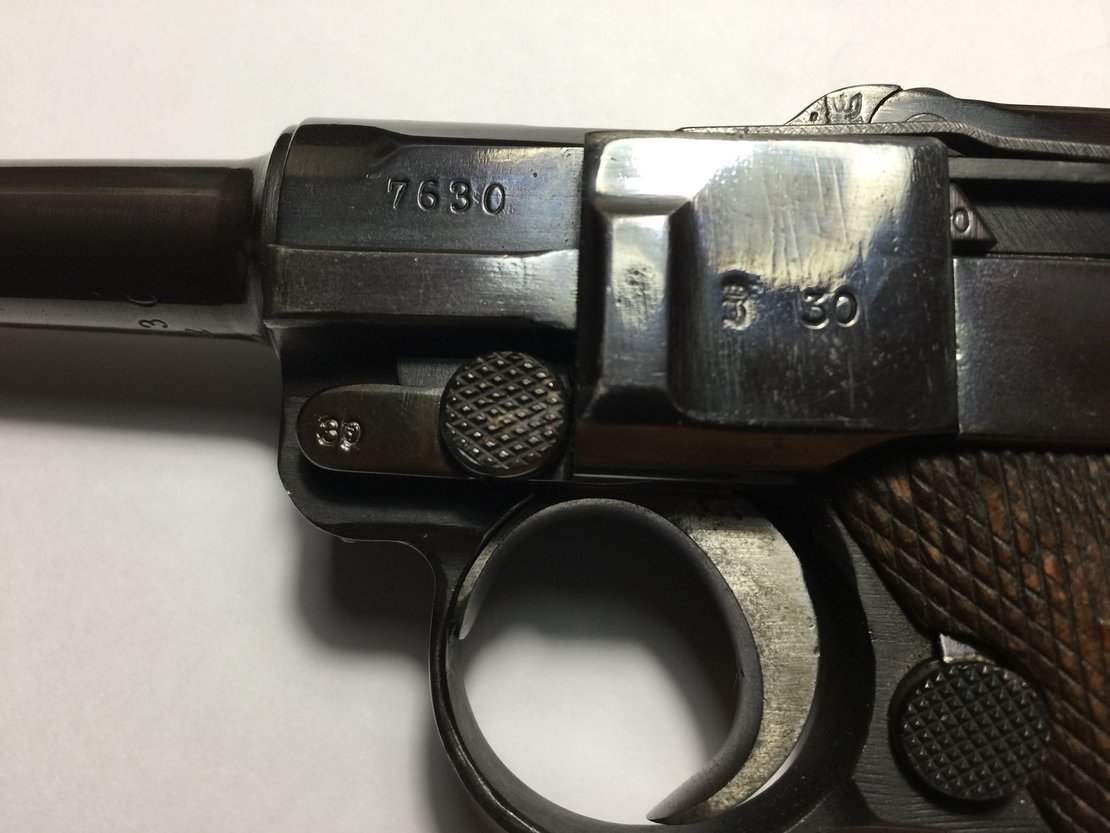

This is my first Luger and I would like to get some real info on it. I have been reading the posts an have gained some valuable info. Im not sure what the P.A.L markings are under the trigger guard.
I need a lot of education on what I have.

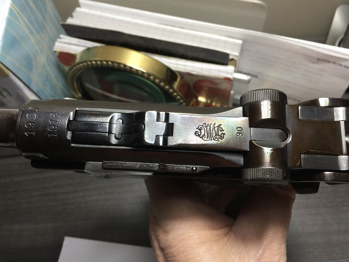

Nice DWM police unit marked Luger, that was manufactured for the Imperial Army during the last year of the Great War. The number 1920 on the chamber is not a year, as is 1918, but a property mark of the Weimar Government.
It was reassigned from military surplus to police set

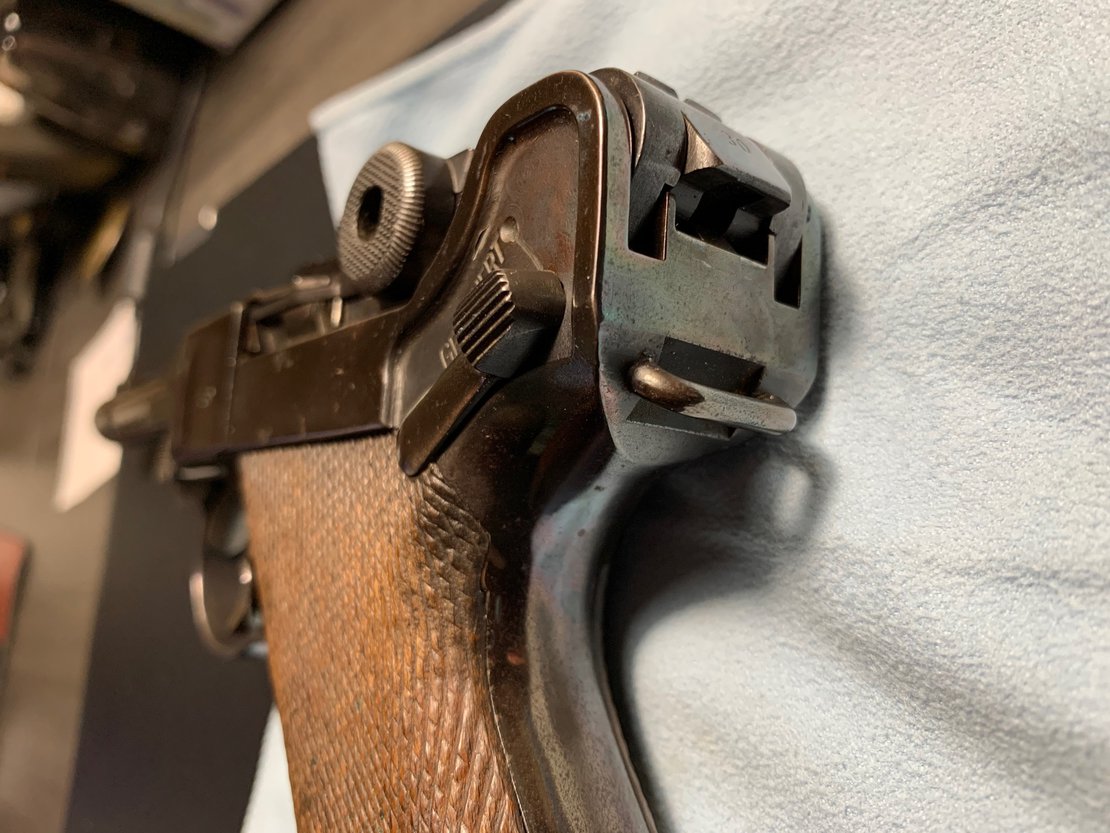

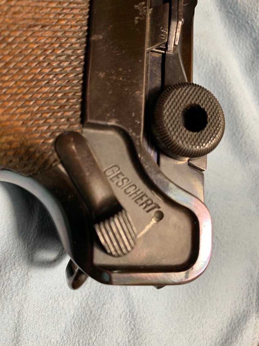

Need better photos to see the sear safety that was installed on most police Lugers.

P.A.L. is for the Polizei amt Leipzig, II likely is a sub-district of Leipzig, the R is for Revierpolizei or
"precinct police", and the 235 is the weapon number.
It has the sear safety questioned above.

Here are a few pictures of the back of the Luger. Is this what you are looking for?

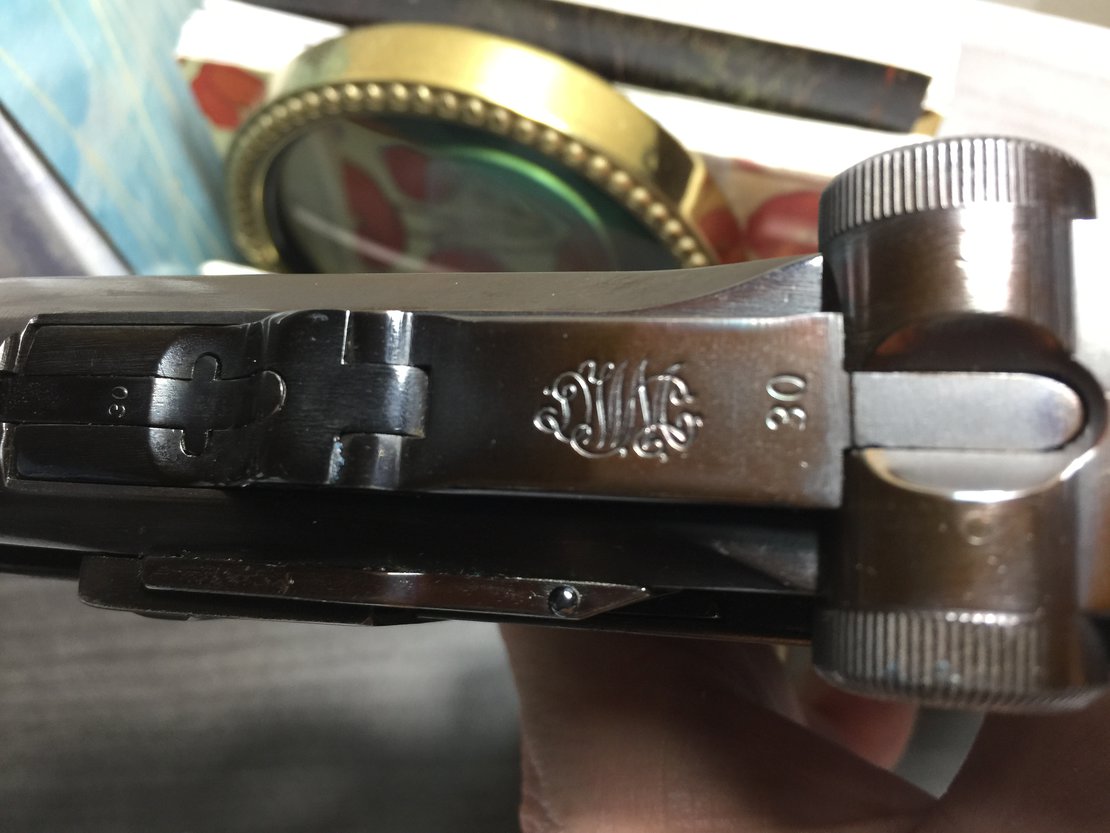

I notice the sideplate matches the last 2 of the pistol SN but is Erfurt proofed. Was that possibly done during a rework at some point between the wars before it went to police service?

The re-blue will hurt its value but will not ruin its value, as will the Erfurt sideplate. Just as there are all levels of collectors, there are all different levels of Lugers. Some will automatically drop it to shooter grade, but the value isn't hugely different. You have a nice gun with lots of history that you can collect and shoot.

In addition to being refinished, it's had a replacement side plate installed (one from Erfurt). Even though it's got a matching number, it wasn't on the pistol when it left the factory.
To be considered collectible, it has to be close to the state it left the factory in. All matching and in original finish. As a shooter grade Luger, it's got a value of about $800 if it properly fires and cycles.

I see at least three parts that were made by Erfurt: side plate, trigger and breech block.
None of that detracts from the obvious history your Luger has seen. Service in WW1, service during the Weimar Republic and pressed into police use.
