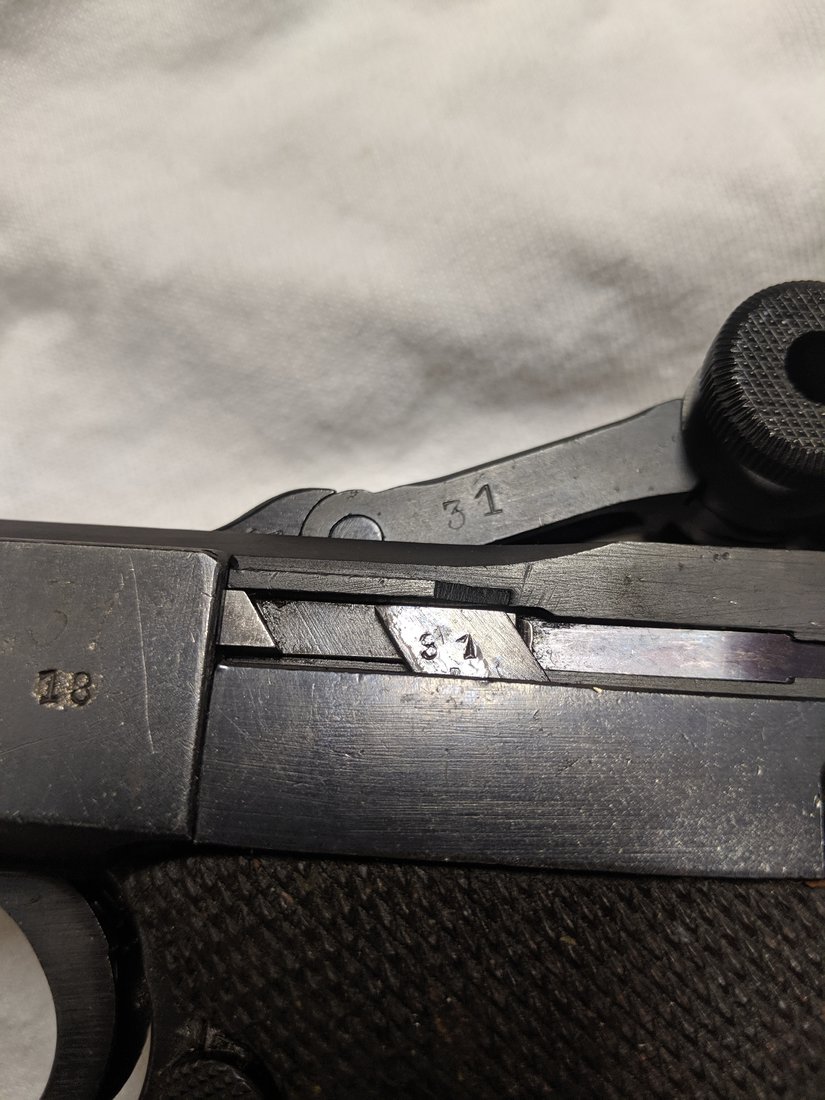

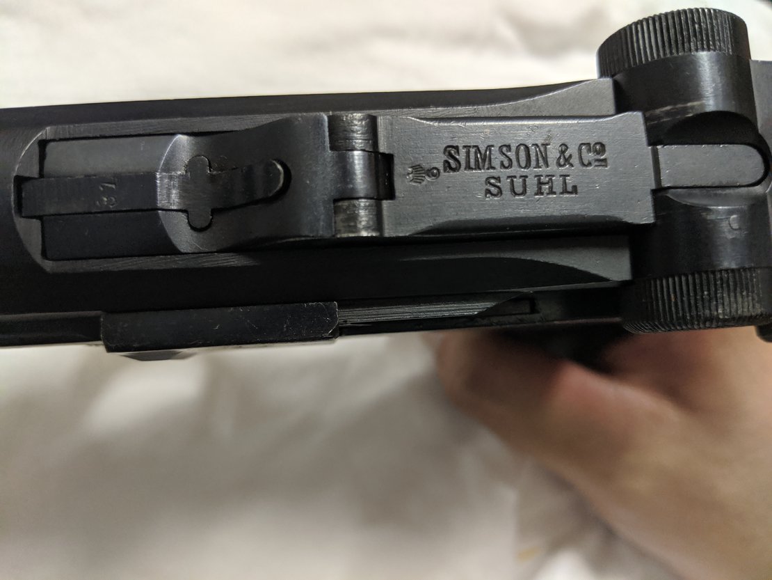

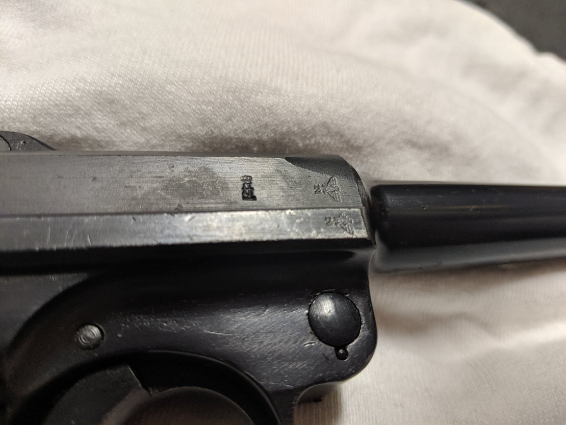

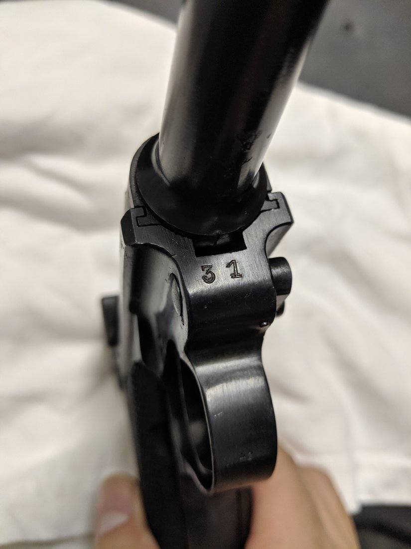

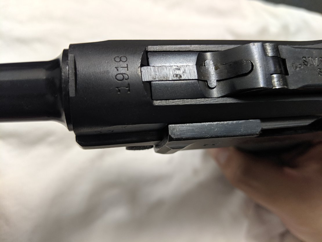

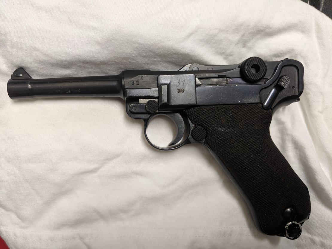

Hello everyone! I finally got my first Luger and I've already got a few questions about it!
1. The side plate has been force matched to read 31 and the take down lever is hard to read (I'll just assume it's not matching). But every other I've looked at besides the grips match with the number 31. This a pretty low serial number so I was wondering if all the 31 stamps are a German font or a Russian font? It would seem odd that they would force match a 31 on the side plate if they've stamped 31 everywhere else and to match so many pieces us pretty rare for Russian captures.
2. The toggle is a Simson but is every other piece Mauser? I'm guessing so due to the 42 stamps and Eagle 63. The toggle number matches the frame though so I'm not sure how that worked.
Any help would be appreciated! I know Russian captures aren't that collectable and they did a lot of work on what they captured but I'm really curious to hear what you all think.
Thank you so much!

Most folks, myself included will see the 'x' and think of it as a 'russian capture' - some recent information seems to show that it is not always true. The force matching I associate more with an east german gun that was then used in service. Making sure the part worked then renumbering is how I beleive.
The toggle was likely blank or perhaps it happened to be a #31.
The frame appears to have the 'Mauser' hump or bump, which would show that it was a mauser to start with and then it was reused / rebuilt when needed.
The low serial number can just be a coincidence, as tens of thousands were made each year and they started over (2nd batch of 10,000 would have a suffix letter). Or perhaps the front of the frame and side were renumbered.

Not just that, this one is all kinds of mixmaster force matched. I am pretty sure the right side of the upper is an Erfurt stamp, corroborated by the 1918 chamber date and Artillery cut. There are all kinds of mixed stamps on the gun, even in the same parts (like the barrel). Not sure if that side plate renumbering was scratched with a sharp tool or electropenciled on there. I would agree that it is more of an East German rework than a Russian capture gun. Shoot the crap out of it and let us know how it functions! Congrats on picking up your first Luger (they get a little addictive).

That is one of the more interesting mixmaster Lugers that I've ever seen. As stated, the receiver appears to be Erfurt while the frame is Mauser.
What's intriguing to me is that the barrel proof marks (E/N & E/J) and the two E/N stamps on the right side of the receiver and frame are IAW the 1939 proof laws indicating that it may have been pieced together during the war. The E/63 on the barrel also supports that idea.
The E/N & E/J proofs were only used - AFAIK - on commercial guns and were not military proofs. The E/J is for proof after repairs; in this case, likely the replacement barrel.
The extractor finish is rather crude and I think Simpson did repairs which MIGHT explain the toggle train.
Does the "X" indicate Russian capture? Who knows? If it was owned by a civilian, it may have been confiscated and put together with military guns. Unfortunately, there's no way on earth to know exactly how that mix of parts came together or when.

I believe the e/n and e/j were also used in East Germany post war.
update- E/n and E/u; thanks Dwight, one should always check before remembering.
Unread 09-16-2019, 11:56 PM   #6
The e/N and e/J are specifically 1939. East Germany (Suhl) used c/N and c/U for proof, the final proof eagles are different birds.
