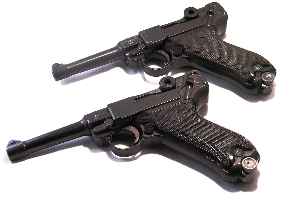

Unread 07-20-2019, 10:25 AM   #9
Hmm. After Krieghoff came the VEB Ernst Thälmann Werke in Suhl. They only did a small run in 1953.
So technically they should be the most expensive ones
