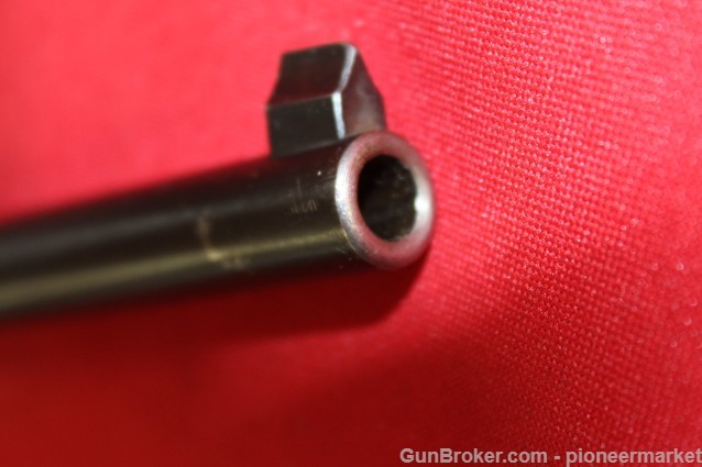

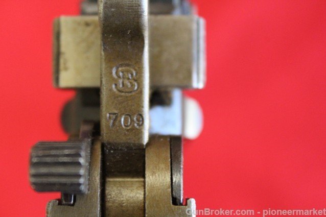

Please see the attached photos of .30 Mauser pistol #9709. The pistol's features are just like a typical "WW1 Commercial" except the serial number must be from the 1916 9mm "Red 9" contract, right? (The actual .30 Mauser #9709 would date to 1897 and have early features...note the "NS" safety which did not start in .30s until 1912/sn@280k.) What is the explanation please, and any special collector interest? I should get the pistol next week. Thank you, Joe

I believe you nailed it.
"Red 9"s are popular due to the military connection.
But,
I'm going to guess that your grips are replacements, as they are the wrong style and lack the Red 9 incised into the outside.
I don't like the look of the serial number on the left flat of the chamber either, looks like it was added to match the upper to the lower. Notice how close the top edge comes to the marking on the top flat, I believe the original number was milled off and a new number stamped.
I'm afraid you have a "boosted" 9mm Mauser, renumbered to match.
Post some hi-def pictures when you get it for a better look; these pictures won't expand enough to see fine detail.

Thank you Don, my theory was this pistol was made as a .30 but numbered with the Red 9 series, it seems you are saying the pistol has a .30 cannon and grips that were re-marked to match a 9mm gun, then everything was refinished. This could be right but it seems like a lot of work for back in the day-and look how well the number styles match and the finish looks original, right? When I get the pistol I will check the number under the rear sight and post better photos. Are any members aware of factory original .30's numbered with the 9mm contract pistols? Thank you, Joe.

It is tough to say about the finish without better pictures.
This could have been done in 1970, and have had near 50 years to "age" by now.
Matching pistols have always been more "valuable" than mismatched ones.
