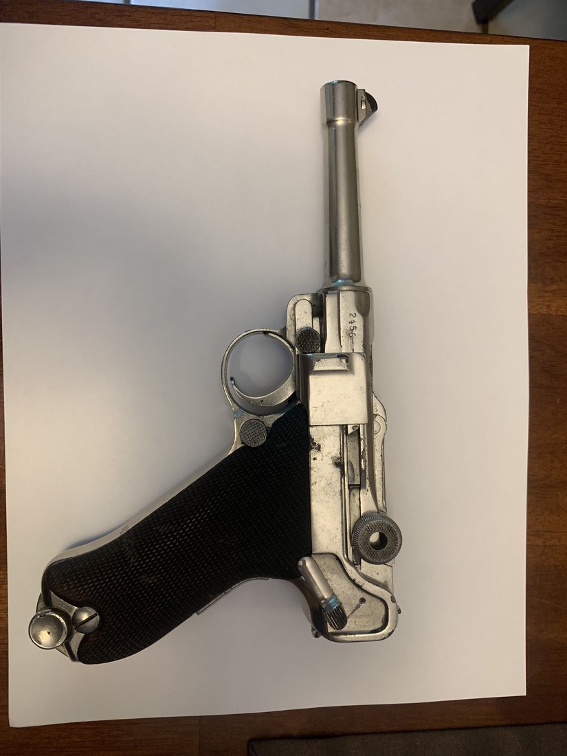

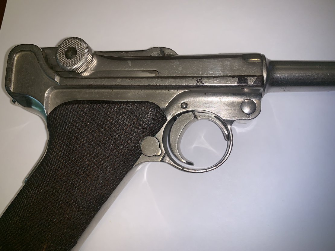

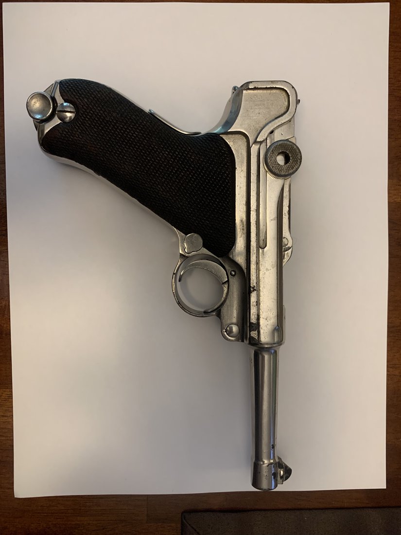

Hello everyone,
New to the forum and to Lugers. I've purchased a 1920 marked DWM Luger with a rough nickel plate finish. It's matching many numbers but not all. The barrel and receiver match and it looks like the alignment line is straight. The frame, side plate, take down lever, toggle link, grips, grip safety, and trigger are all the same serial as well. Unfortunately the grip safety spring is broken I think because it just falls flat on fire. Suggestions on where to find one of those parts would be appreciated. And any comments about it are welcome. I know it's no collector piece, just hoping to get some rounds through it and enjoy it.

Unread 06-09-2019, 10:46 PM   #3
Spring is there, unless it it missing its "end"; perhaps you don't have it on the right side of
the tab on the grip safety.
Or the grip safety tab is missing.
That is a mixed up luger, a P 08 upper on an "06 model frame.
I believe the upper receiver is a 1920 dated DWM, but I cannot read the numbers on it or the barrel.

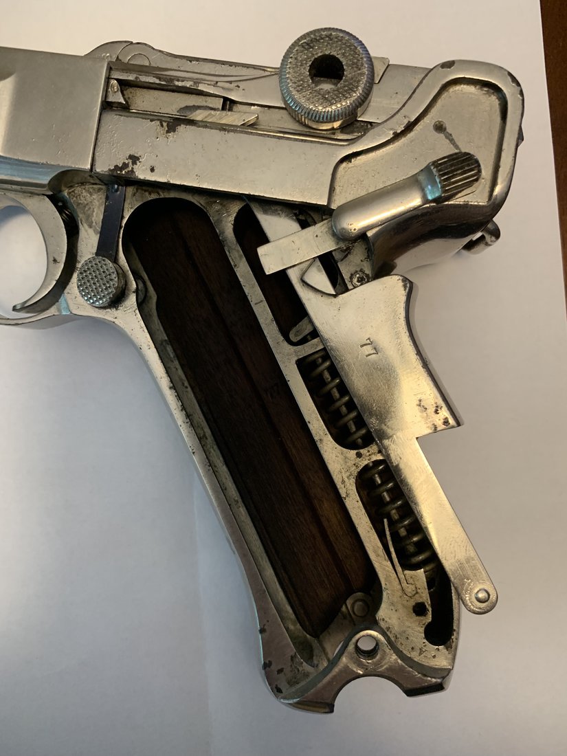

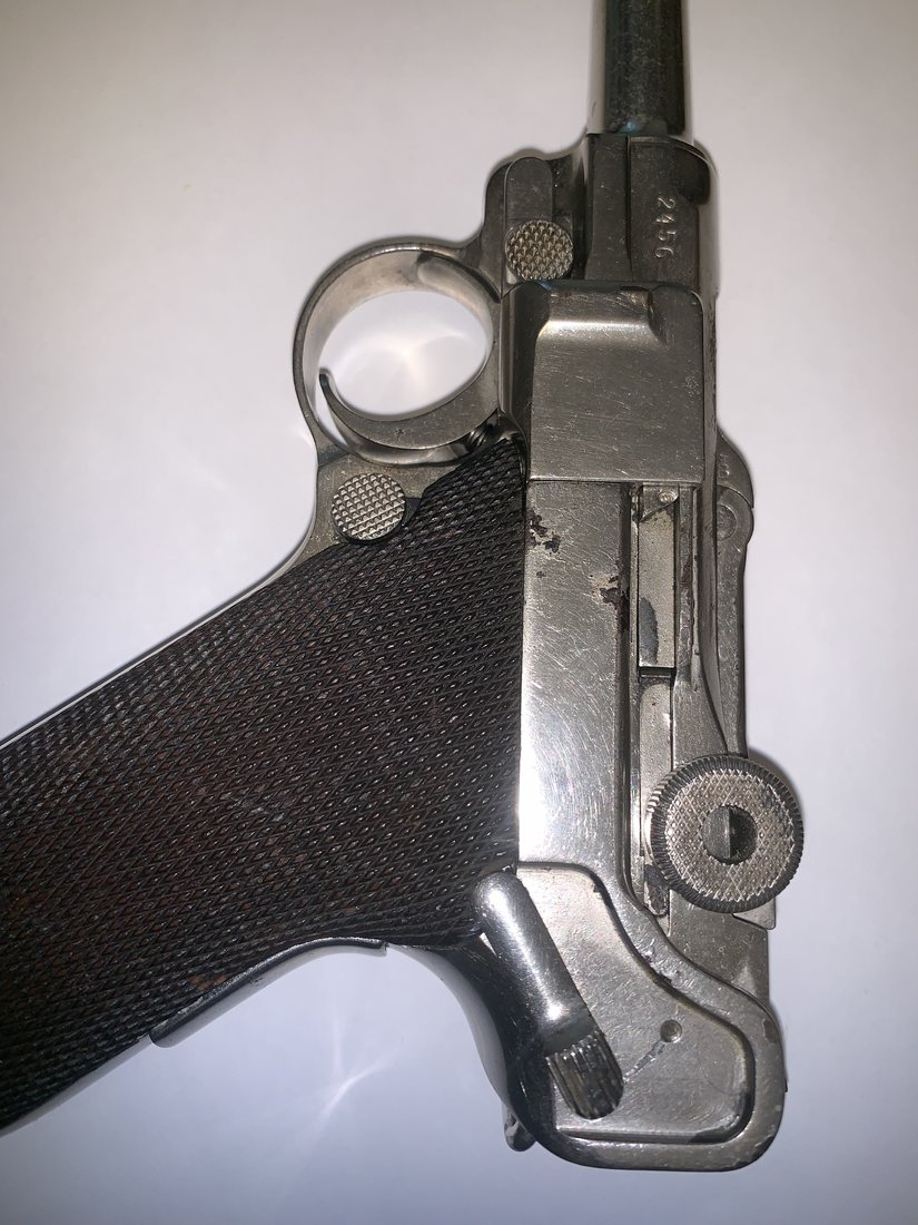

Thank you both for the reply. The spring is there but it appears to be too short or broken. The grip safety does have a tab but it is farther up and the spring doesn't come close to contacting it. I have a crudely annotated photo if that helps describe it.
The barrel has 1920 on the top and serial 2456 with 388 under it closer to the receiver and upside down compared to the serial. The frame has 31777 all over it and most of those parts all match with '77' stamped on them.

Unread 06-09-2019, 11:08 PM   #5
The 388 on the barrel is "8,88" the actual bore diameter.
The picture of the grip makes me a little dizzy; but the tab may also be broken and a little short.
I really can't make out the length of the spring.
lugerdoc on this board can help you with a spring.

I've taken a couple more pictures. The spring is about 16.5mm from the tip to the end. The tab on the grip is about 3mm wide. It's not long enough to contact the grip safety tab. Thanks for the suggestion about Lugerdoc, I'll ask if he's got a spring for sale.

Great additional pictures.
Yes, you need a spring.
Unread 06-10-2019, 09:53 AM   #8
I do have new grip safety springs in stock. TH
