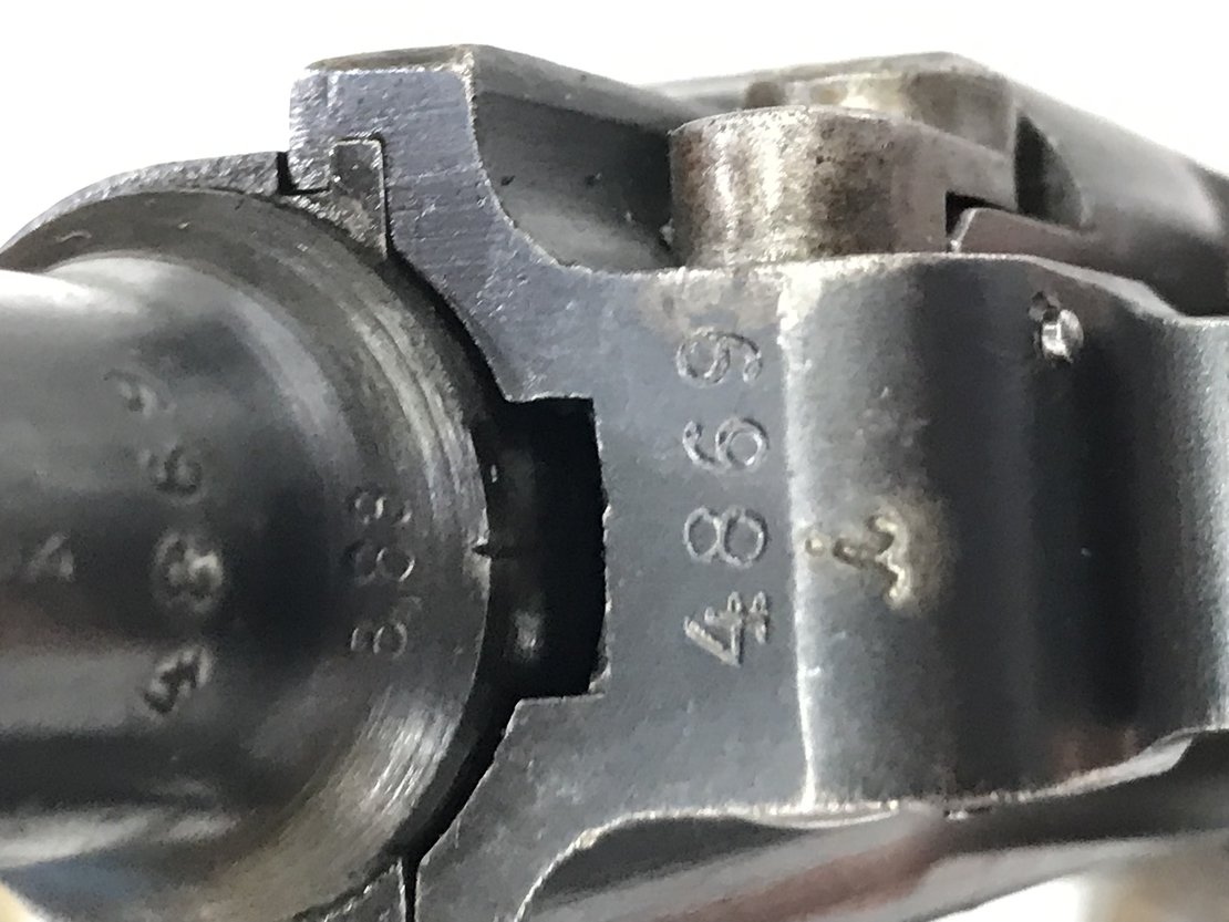

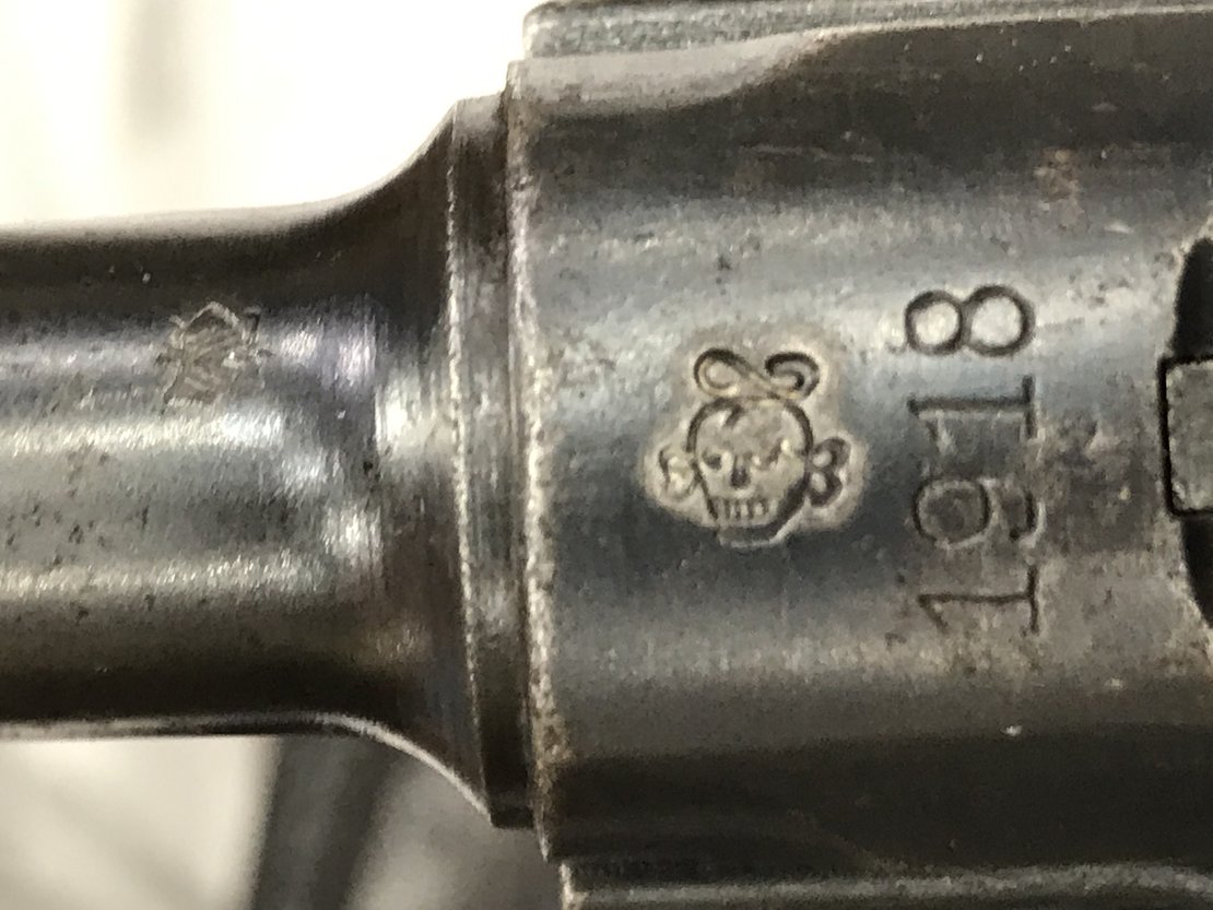

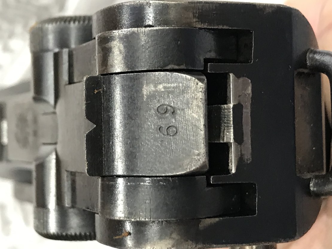

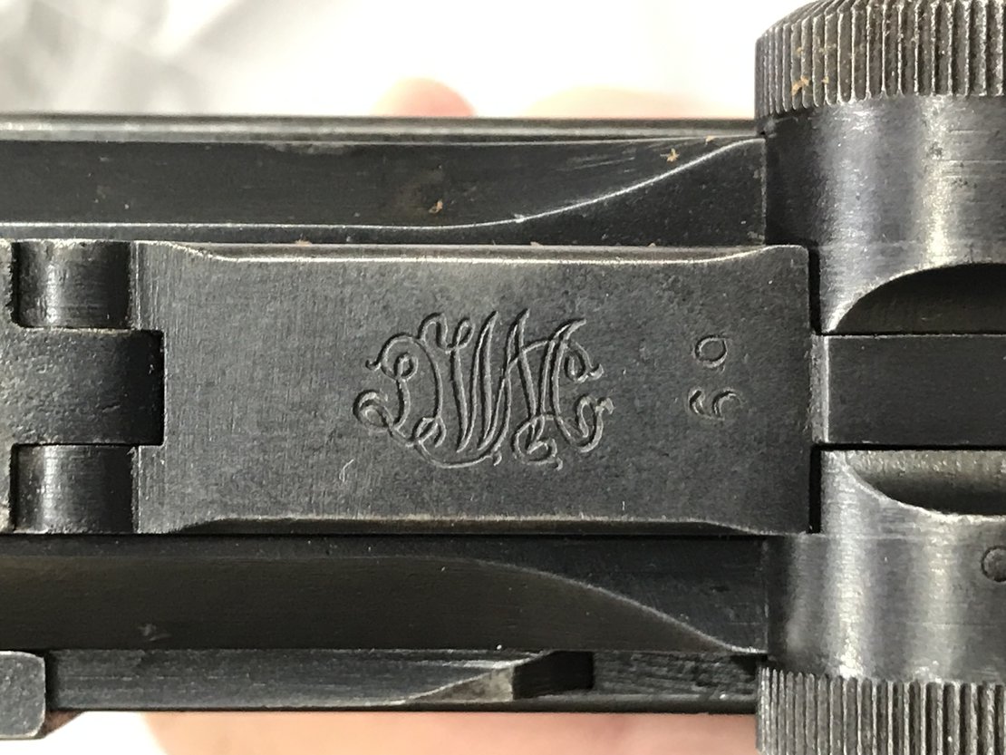

Help from the gurus needed! I have the opportunity to purchase a 1918 Deaths Head Luger with what looks to be acceptance stamps where it was used in WW2. This gun is all matching including two numbers matching magazines and leather holster. I have inspected this first hand. Any input on authenticity and price range for this? |

According to more recent books, including the blue book of gun values, almost all are fakes. They are valued as normal Lugers. Beware.

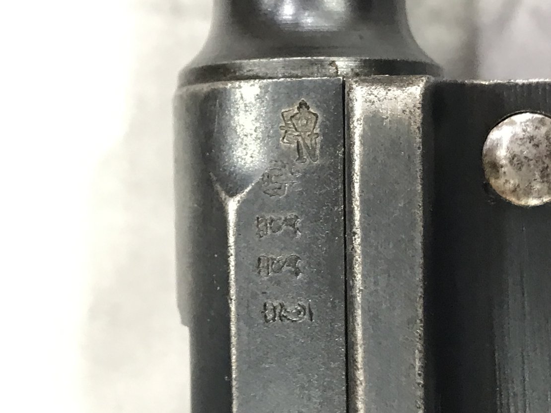

It also has Post WWI commercial proofing from Suhl, an indication of re-working.
There May be some original DH lugers; but when buying one- I would assume it is a fake. It is really near impossible to prove it original.
03man(Don Voigt); Luger student and collector. Looking for DWM side plate: 69 ; Dreyse 1907 pistol K.S. Gendarmerie |

The gun looks a lot better than some of the fakes I have seen, so who knows? Also, the holster is only the third one I have seen with the "lazy S" DH. It has the earmarks of being authentic, but it can't be proven one way or the other.
If it's made after 1918...it's a reproduction |

I am suspicious, from bitter experience, of any Imperial Luger with one matching magazine, let alone two. A closed 4 is incorrect on any P04 (Navy Luger) and I believe it may also be so on any Imperial P08.

Why would it be C/N proofed? It was military accepted and proofed by DWM in 1918. I tend to agree with k98mike, used and marked by a post war paramilitary group. Freikorps or some other smaller group during the hectic times in Weimar Germany. Perhaps similar to the EWB markings. G2 |

It was re-proved after rework in post WWI germany, the proof markings are from Suhl.
It was re-proved because it was re-worked.

A reproof would only be needed if any critical component was replaced: barrel, receiver or breech block.

It may have started as an artillery and needed re-barreled for Versailles, but I can’t see the artillery sight notch if it was.

See the first picture, no artillery cut.

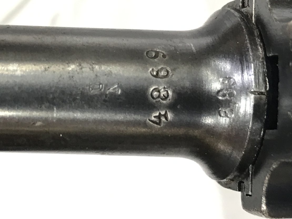

The C/N of Suhl is over a Weimar era firing proof on the left chamber. The barrel was replaced at some point, as it is a Simson barrel. Who knows what else could have been replaced when it received the Suhl re-proof.
