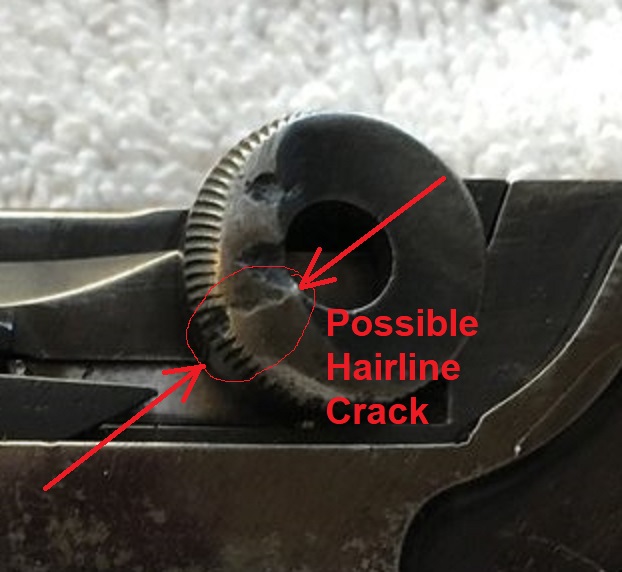

Wow! That is the most unusual sideplate I have ever seen. It is most definitely a hand made item. I will warn you to DO NOT SHOOT this Luger if that left toggle knob is cracked... It will end up in pieces, and possibly harm you.

Thank you John I will most certainly look at this closer when I get home, hadn’t noticed it.had no plan’s of shooting it until it was throughly inspected due to its age.

I would particularly like to see the sideplate removed, and good clear photos of both front and back (inside and outside).
The Toggle knob may not be cracked, it is hard to tell from the photos so far, I hope it is not. This is a very unusual specimen.
Here in this photo enlargement is why I suspect the cracked toggle knob.
I would strongly suggest that you get in touch with our member G.T. (Gerry Tomek) at gctomeks@msn.com .
He lives in Chandler, AZ not far from you, and can give you an expert craftsman and gunsmith's evaluation of the condition of not only the toggle, but the entire gun.

You might also want to check the toggle lock under the right toggle knob. It's not pointed out as often as it should, but the dished toggle Lugers need the toggle pulled straight back about 3/16" before lifting.
Most ham-handed gun dealers and their uninformed customers just yank up on the toggles.
I was lucky. My lock wasn't broke.
