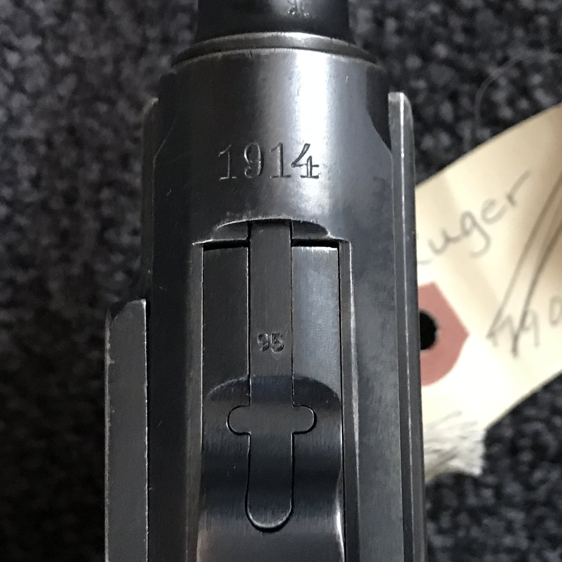

Hi everyone, I inherited several Lugers from my Dad and I'm trying to figure out what I've got here. I think this one is a 1914, and I took photos and made notes of everything I could figure out. For the rest of the information you'll need, I don't even know what I don't know yet, so please be patient with me. I can take more photos if needed.
This gun was in Canada until recently. I assume the "Germany" mark was put there when it came into Canada from Germany. It should also have a mark indicating that it came into the USA from Canada, but I haven't found that yet.
I'll post photos from my phone--give me a few minutes.
Thanks in advance for your expertise!

Here are some photos.

Oh--also, I should point out that as far as I can tell, all the serial numbers match except for the magazine. I need to look at my other ones and make sure they didn't get mixed up.
I took photos of your website's handy note pages and will post those as well. I was only able to partly fill them out because I didn't know what some of the stuff was. (I'm embarrassed to say this but it is what it is.)

Mom, From the looks of the marks I believe you are correct. The import in the curve of the mag well and Germany are bound to have been done at the same time. In all the Germany marked Luger's I have ever seen I have never seen one this small or in this area.
Your 1914 WW1 Luger is a very decent looking pistol. The magazine is a WW2 type with an aluminum bottom. Your 1914 should have a numbered WOOD bottom.

The scroll on top of the toggle is the manufacturer, Deutsch Waffen und Munitionfabriken (DWM), the smaller “inscriptions” that you see on the right side of the pistol and the one on the underside of the barrel are proof/acceptance marks from the German military.
Side note, is there a full serial number on the underside of your barrel?

The acceptance stamp on the bottom of the magazine is a Weimar Eagle (droop eagle) over 63. It was made by / for Mauser.
I'd estimate your Luger's value with the magazine at $1600 if the Luger's numbers are, in fact, matching. There are internally numbered parts that would need to be checked, along with the inside of the grips .

The barrel looks newer than the rest of the Luger. Also, IIRC, one of our members here makes replacement barrels for Lugers because of some arcane barrel length requirement by the Canadian authorities. It might be worth measuring the muzzle-to-breech length, not that it matters here but it may have been swapped out in Canada.
Nice looking Luger. My WAG would be in the $1200 to $1500 range, depending on the abundance or scarcity of Lugers in where ever you live.
Unread 04-08-2019, 09:11 PM   #13
It is the original barrel, or an original replacement; one can see the original DWM(Spandau) firing proof on the rear of the barrel in two of the pictures.

Nice looking 1914 and great job on the photos!
Just need two more that will help. One of the serial # under the barrel and one of the serial # on the front of frame.
For the next guns, I would not worry with posting photos of the forms. It should be adequate if you post the photos you did for this 1914 and the two additional photos requested above.

The magazine is from 1936.
