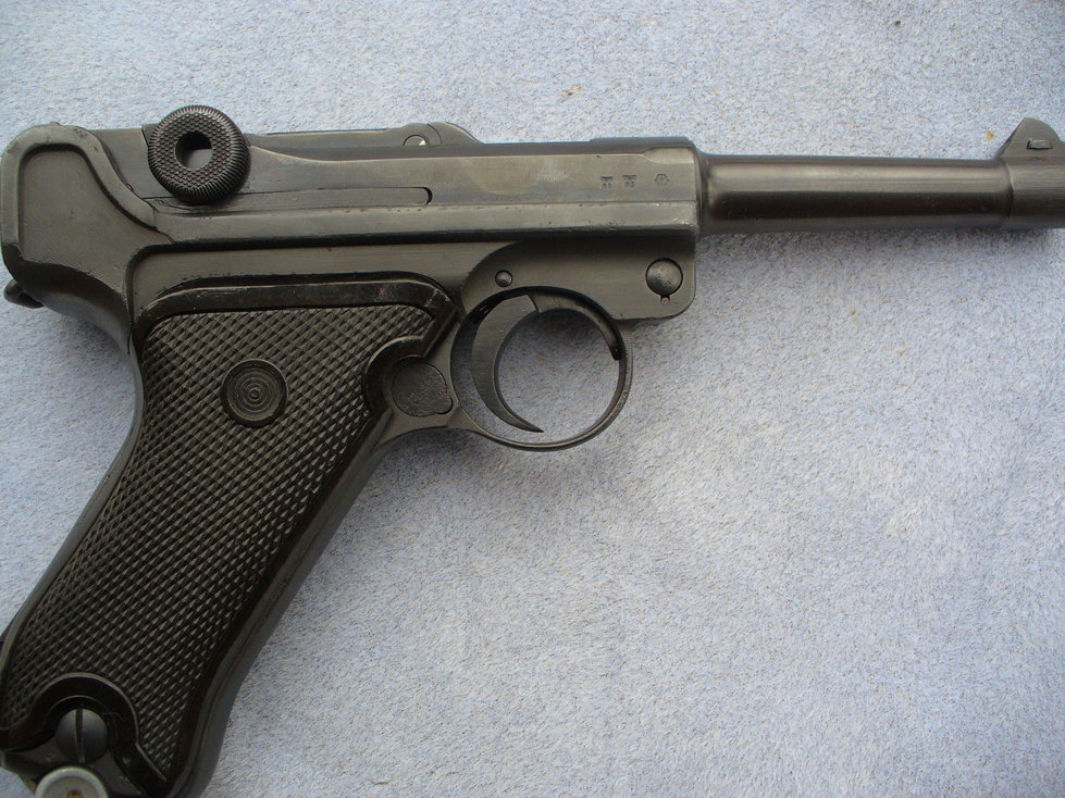

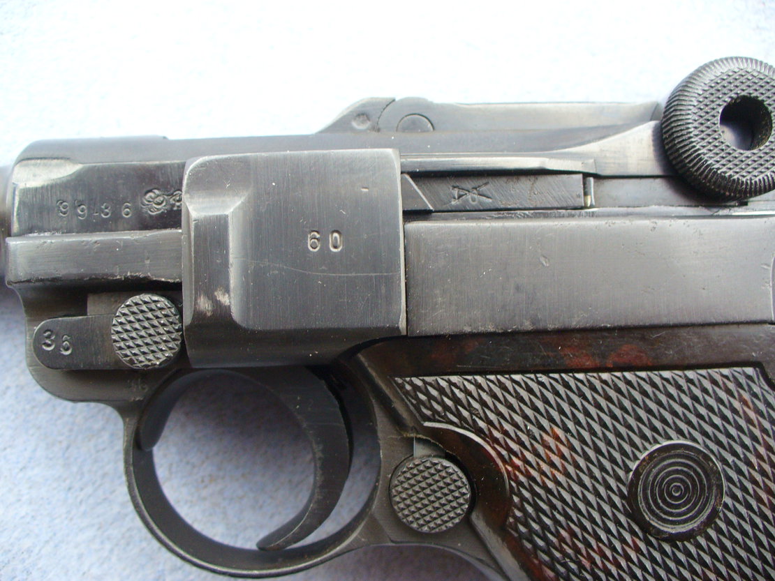

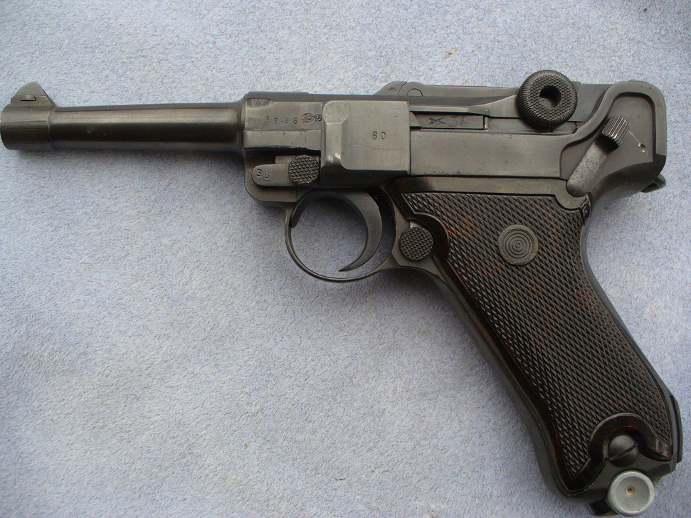

Just bought this Luger and was unsure if this is a RC gun or just a parts gun. Barrel has been replaced and has a crown N proof mark, and import mark. Cant figure out what Luger the barrel was originally on. Numbers don't all match and some of them are in electro pencil. Came with two Thalmann mags serialed to the gun. Toggle and receiver is 1938 S/42. Frame is 9936i. Top and back of toggle has had the original numbers ground out and restamped with 36. I don't know if this was something the RC rebuild did or if this is an attempt by someone here in the US to make the gun "matching". Last question, how much would this pistol be worth? Thanks.

It is an East German rework, or Vopo luger.
The barrel is likely a new made EG barrel installed at time of rework.
Since you just bought it, why not tell us what it was worth?
Unread 03-29-2019, 08:42 PM   #3
The grips are typical VoPo (Russian Capture to East German Volkespolezei) bullseye trips.
The importer was likely the "Cross Roads Gun Shop" "ECCSA" in Pennsauken, New Jersey. They imported quite a few East German / Russian Capture Lugers back in the 1980's. They have been long closed.
The barrel change, and rest of the work was either done before it was imported, or the importer assembled guns from parts. It would really be hard to tell which.
The Frame, (with no "Mauser Hump") probably is from an earlier Mauser Luger made in early 1937 or earlier.
If it functions properly, it would be valued as a Shooter, and probably around $1000.

That particular crown/N is the one used by East Germany; it is not the same as the "other" crown/N you are used to seeing on DWM commercial lugers(both receiver and barrels).
There are way too many variables in luger pricing to give you a "value", you got a deal at $450 for sure. On some venues the selling price may have been 2x that; which only demonstrates that any "value" idea - has no value. JMHO.

No others, it was a sale from armslist. I kind of thought that was an X below the serial number and letter i on the frame.
Unread 03-30-2019, 10:00 AM   #9
There is an 'X' on the sear bar.
Unread 03-30-2019, 10:13 AM   #10
I believe that "x" is there to cancel the old number, as it is placed "on top" and then the sear bar renumbered.
Canceled Vopo markings are seen just to the right of the serial number on the left chamber.
The RC "X" is usually on the left side of the chamber(and larger, and not squished); though there may be a circled X on the front of this frame, which I can almost see in one of the pictures.

The encircled X on the front of the frame would be there to cancel the letter suffix.

It also looks like some mark was canceled out to the right of the serial on the left side of the receiver. So I guess what I am reading is that this isn't a Russian Capture, it is a VOPO put together correct?
Unread 03-30-2019, 01:23 PM   #13
"Canceled Vopo markings are seen just to the right of the serial number on the left chamber."

So is it normal on these pistols to find the Vopo markings canceled out, and also electro penciled numbers put in place of Xed out stamped numbers, or was this done by some "bubba"?
Unread 03-30-2019, 04:50 PM   #15
That was done to obscure the East German provenance.
It's a totally correct VoPo.
