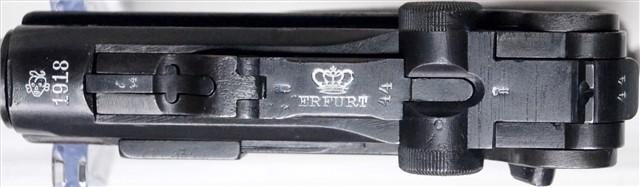

Like Simpson's write up, many of the DH lugers I have seen were Erfurt pistols, and were 1917 or 1918 dated. Past that, there are those with only original inspection/proof markings and those with additional commercial proofs that date to Suhl in the 1920 era.

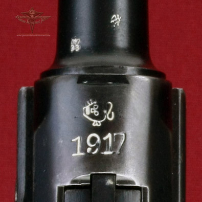

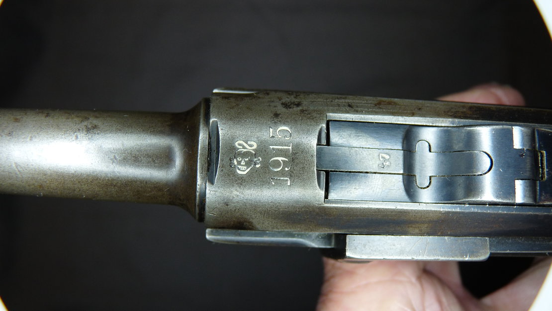

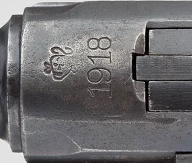

Don, I noticed quite a difference in the details of each Deaths Head. The 1916 has far more detail than that of the 1917. In looking at each of the 3 Death Heads faces and their detail differences, mouth/teeth, eye and nose shapes and "S", I believe they were all from different stamps. I would think most original Death Heads would be made from one original stamp. Would be interesting to compare what is considered to be a "True" Death's Head stamping to the rest.

Ron, Looking closely at your photo's details, along with Don's three, I feel they are all 4 from different stamps. Most notable, the shape of the ears, among other details. I think yours has the best/clearest stamping. The Photo of the DH in Lugers at Random sadly is to poor to see the DH detail.

It's a popular belief that the 'deaths-head' is a Freikorps marking. There may be different 'stamps', as there were different Freikorps geographical groups.

Sheepherder is correct; there are several different DH stamps.
One or more may be "real" or original to the Freikorp time; and some are likely not.
