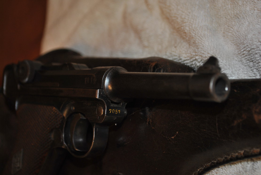

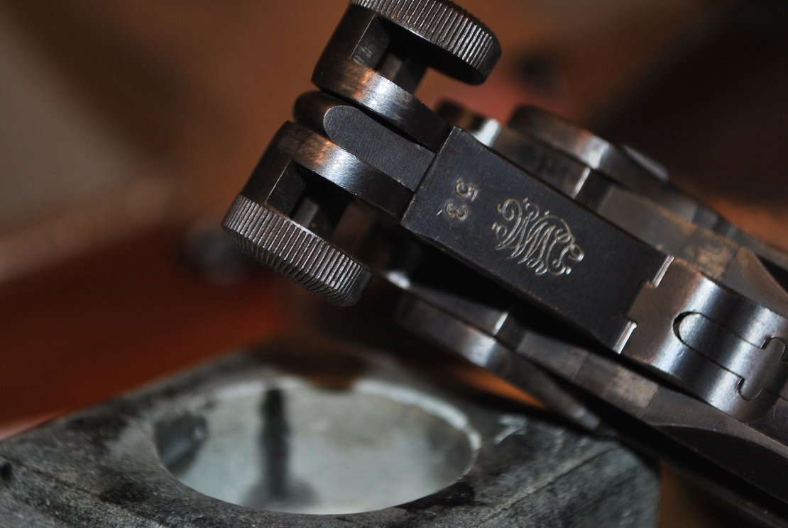

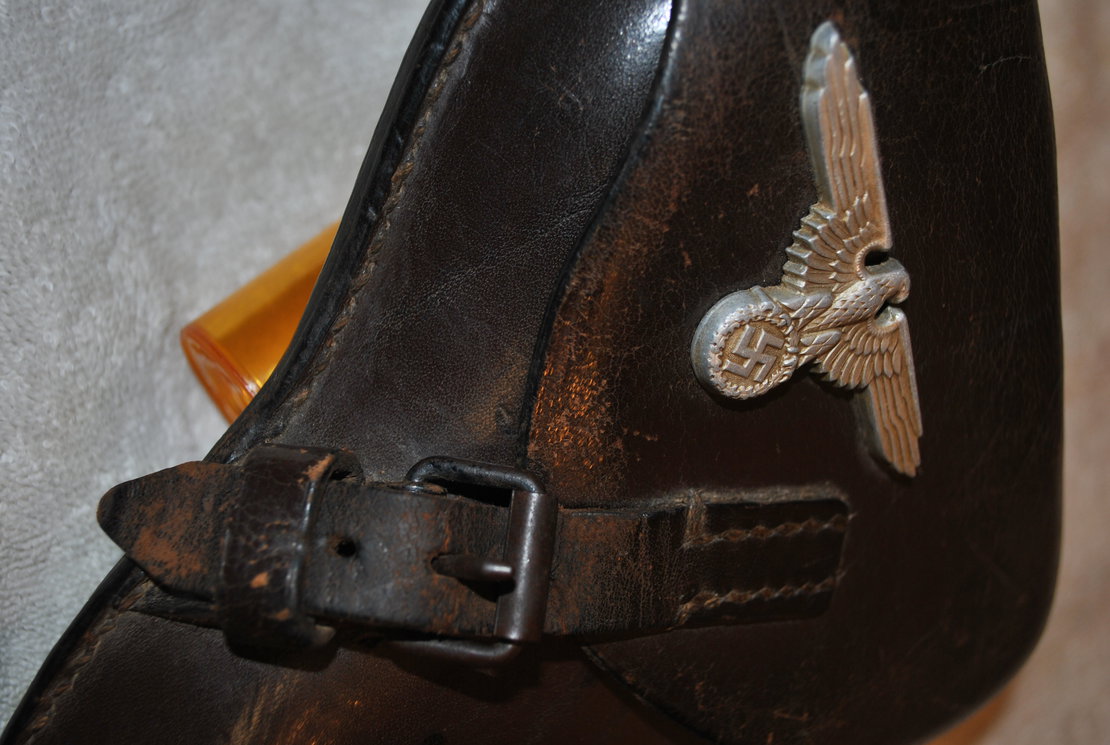

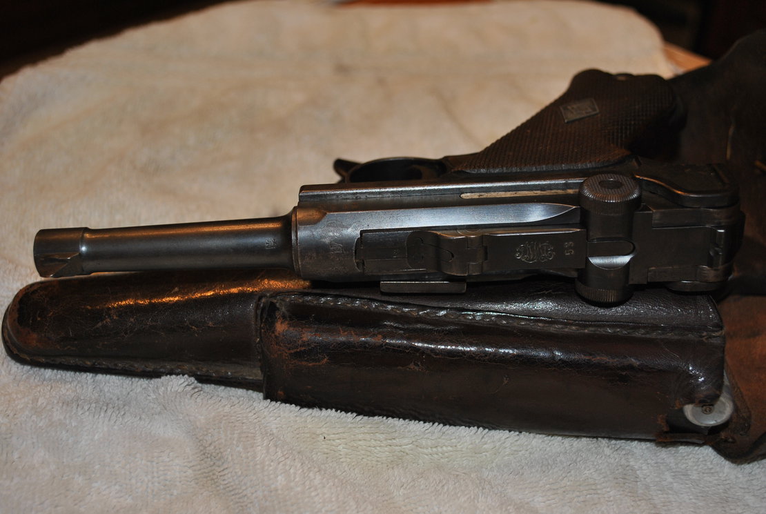

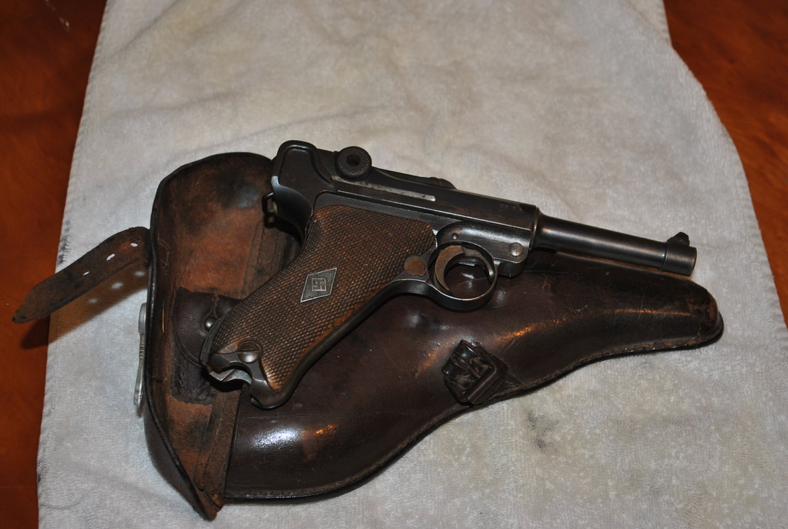

This popped up from a friend...
No idea bout the markings and such...
Pretty sure it's a Berlin ...\
Comments on it are welcome...
Worth or value... etc.
Thanks, TW

Well, it's a WW1 gun, a 1917 DWM. The holster eagle and the swastika on the grips are both after-WW2 additions, for unknown reasons, probably bragging rights or marketability. The magazine is wrong for that gun. 9mm. Hard to judge condition from those photos, but I'd guess-timate value around $1000 or $1100 for the gun, maybe $100 for the holster.
Any specific questions?

yes the inset swastika on the grips and the pin that has been attached to the holter flap are post war modifications by some owner/seller. Such modifications would never be permitted on an issue weapon being used on active duty.

The magazine is a 1941-1942 Haenel Schmeisser milled steel magazine, and these are about the best ones available for shooting.
It's hard to be sure of the finish because of the use of flash, but it looks like it is likely in original finish.
A higher end shooter with the visible pitting and the grips modified that way. I also think David is right on the money.
