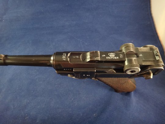

I have one example of a 1912 Erfurt that has had a hold open
installed. Its a staff weapon so it could be conceivable that a higher ranked officer would have the upgrade done.

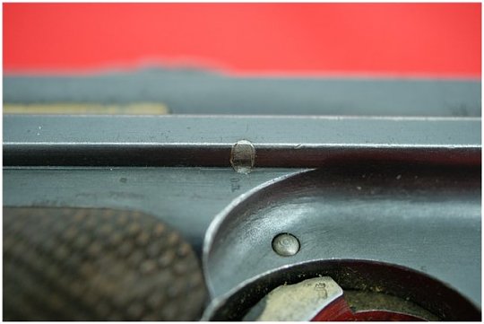

Here are a couple quick picks of the gun and the holdopen installed
The following 4 members says Thank You to wayne8661 for your post:

nice pistol Wayne
Unread 02-28-2019, 07:11 PM   #19
1912 dated Erfurts seem to be some of the best finished of all Erfurts. Even better than DWMs.
