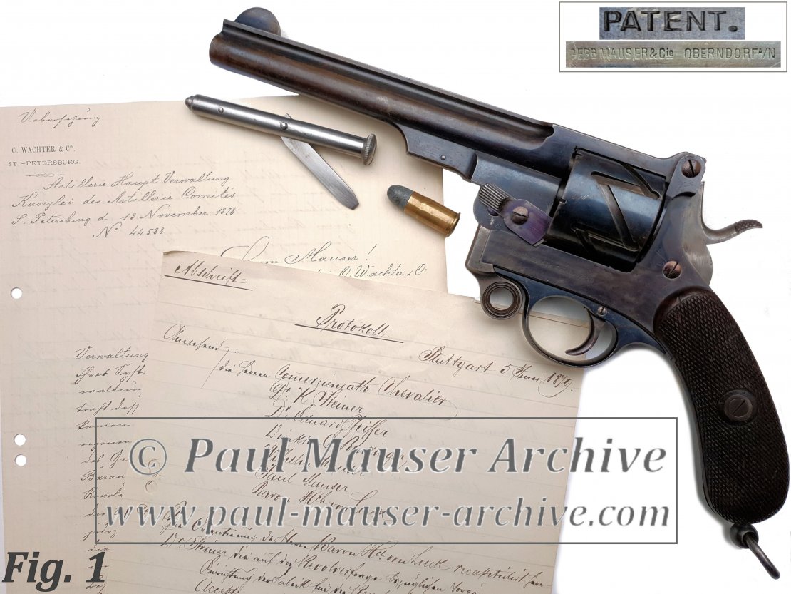

Figure number 1: The Paul Mauser Experimental Revolver is displayed with the unique necked 10.6mm ammunition that is still associated with the patent revolver; his dismounting tool and two rare documents from the Paul Mauser Archive. The document named Protokoll is the most important management document for both C78 and Reichrevolver made by Mauser and signed by Paul, Wilhelm and the Baron Heh von Luck. The other is one of the letters exchanged with Russian importer C. Wachter & Co. in St. Petersburg. In fact, Russia (Caucasian Army) was particularly interested in the revolver and Wilhelm travel to St. Petersburg to demonstrate it.

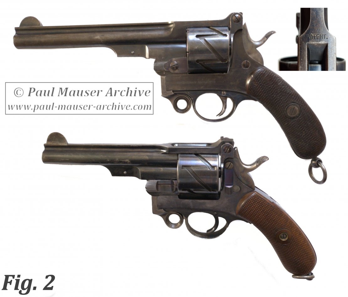

The Paul Mauser experimental revolver is marked PATENT. on the hinge in order to highlight the primary reason this specific firearm was produced and GEBr MAUSER & Cie OBERNDORF a/N on the left side of the frame similar to the mark found on the solid frame C78 revolver.
Figures number 2 and 3: Comparison between the Paul Mauser experimental patent model revolver and early standard production C78 10.6mm. A detailed analysis shows major differences. The most evident are that:
• The experimental revolver is in general bigger and the barrel is longer
• The safety is not present
• The machining of the cylinder grooves is different
• The dismounting lever is affixed with a screw

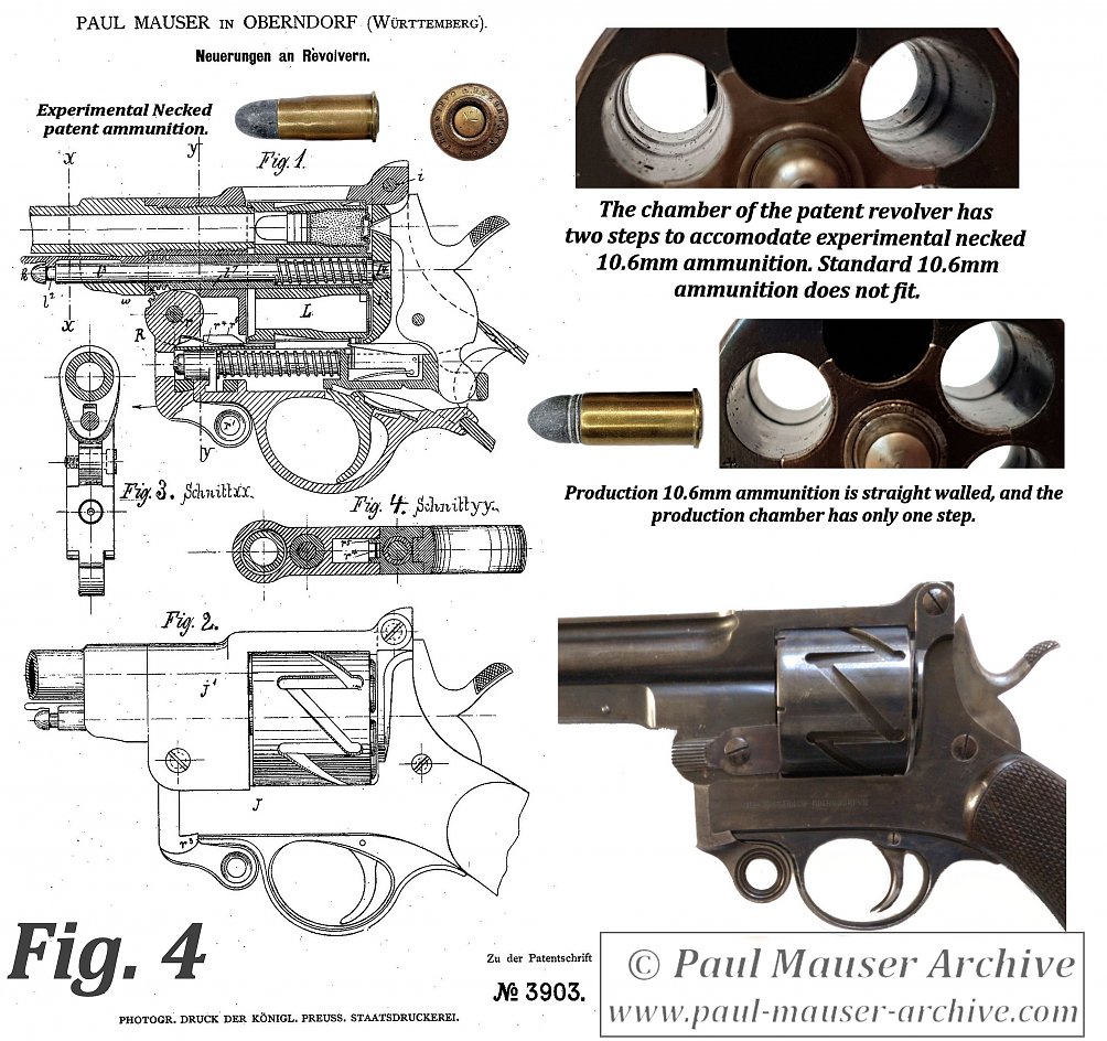

• The hammer is attached to the frame with a screw and not with a pin (note that the two screws are quite visible in the patent drawing, see figure 4).
• The experimental revolver is chambered for a necked case 10.6mm ammunition and not for the standard straight wall 10.6mm one.
• The experimental revolver is marked PATENT. on the hinge in order to highlight the primary reason this specific firearm was produced and GEBr MAUSER & Cie OBERNDORF a/N on the left side of the frame similar to the mark found on the solid frame C78 revolver.
Figure 4: The comparison between Paul Mauser's patent model experimental C78 revolver and patent 3903 “Innovations in Revolvers” granted to Paul Mauser on the 9th of April 1878.

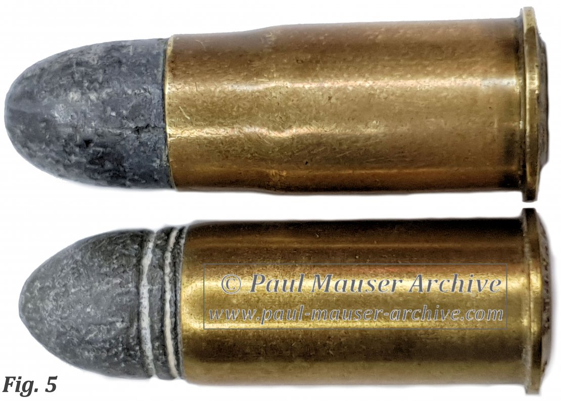

Figure 5, 6 and 7: The unique necked ammunition was produced by H. Ehrmann & C * CARLSRUHE *. Ehrmann was the forerunner of DWM's Karlsruhe ammunition facility. The factory went from Ehrmann to Lorentz (Deutsches Munitionsfabriken – D.M.), then DWM. It shows the long-time cooperation between Karlsruhe and Mauser, even before the factory in Karlsruhe became Loewe property. The rare ammunition is a concept cartridge that never went into production, in the end Mauser chose to chamber the C78 for the standard 10.6 mm straight wall cased ammunition. Below the necked concept ammunition is compared with the straight walled standard 10.6 mm ammunition.
The experimental necked ammunition is 1mm longer than the standard straight one (below in the comparative picture). Both cartridges headspace on the base rim. The chamber of the experimental Paul Mauser revolver has two steps to accommodate the necked ammunition. Of course, the standard ammunition does not fit into the chamber of the Experimental C78 revolver (see photo below).
