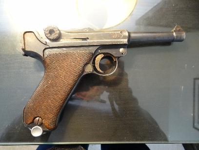

I have a 1916 DWM Luger that was shooting nicely with few problems.
The last two times I took it to the range it has acted up.
It appears to load the next round into the chamber but smokestacks the ejected case.
Thoughts ?

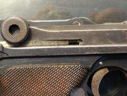

The ejector is broken, the front part that does the ejecting, I assume., is missing about 1/4" .
Will attach photos if I am able.
Thank you guys again for the input.
Any suggestions as to where to purchase another one ?
