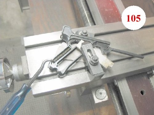

Agreed. There are several threads with pictures showing 'more better' ways to do it, using proper tools. I believe Jim Solomon markets a clone of the original tool which is used for this purpose. I prefer clamping the bare frame to a table and using a Cotter-pin puller to compress and remove/install the mainspring assembly, then using the puller to 'unscrew' the mainspring from its guide.Pliars slip too often and can be sure to find a blued surface, soft steel, or tender skin to impale.
...$.02...
Edit: Here's a pic from one of my threads. The Cotter-pin puller has a 90º tip that fits in the hole in the mainspring guide. The Luger frame is clamped securely to my mill table.
I've read other threads here about holding the frame between your knees, or pushing it against a table. Yikes! Clamping it down and using a Solomon-type tool (or a pin puller) is the bestest way, IMHO...

I agree that Jim Solomon's beautiful repo tool makes a difficult job so much easier.
OP, you get a "A" for effort, but looking at that pic you provided made me cringe. Ouch! Get Jim's tool.
A bonus is the Jim's tool works perfectly for replacing the (are you vocabulary restrictions kidding me?!?!) hammer spring on an M1 30 carbine.

I have a deep appreciation for guys that use what they got for a specific task. Makes me think of old time farmers making a living in the fields.
Not everyone is made of money for specialized tooling. I have even more admiration for those that use what they have, with results just as nice as those with more stuff.
The key ingredient is in the user oneself. We all know that a 100K lathe with a new operator can mess up the first pass of threads. We also have the garage lathe guys with 100 year old lathes with 50 thousandths or more backlash cut threads with the best of them. So all kinda comes down to pure environment. I have tried over the years not to kick another guy's dog...........still trying.
I learned early on, that these springs require some hand strength and vocabulary restrictions. I won't tell you how I changed out my first mainspring, but we all get smarter and make some new assists.
I kinda like the holding fixture and the modified(heated/bent) awl. Being able to hold things..........stable..........sure does help. I have changed all my shooting Luger springs to the Wolff 38#, I think I am good to go for life with either 30 or 9mm caliber or nice wildcat.
