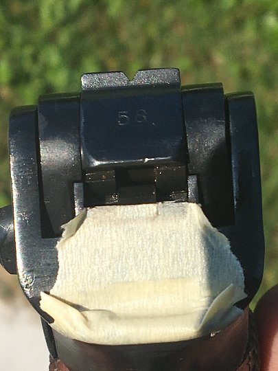

If your Luger is cycling properly, don't be too worried about older springs. If you have concerns, search on "tape test" for discussions of marks on the rear of the frame and the recoil spring. The FAQ lists the various recoil springs used over the history of Luger production.

OK, I'm going to the range tomorrow to try the tape test, a new mag and some different ammo. I read about the tape test but I'm not sure what I am looking for. I'll search the threads tonight. The idea seems reasonable. I have to confess, I see the references to stickies but have no idea what they are. Anyone care to amplify, Be gentle, I'm a rookie.

Thanks, I understand now. I found a thread on the tape test. My understanding is that if the toggle leaves minor dents on the tape and the pistols functions then its ok. When I break it down again I will look at the inside rear of the receiver and see what that tells me.

Check out the back end of the breech block and firing pin spring guide as well, for peening and spalling. Worst case, you might find a crack. Those are the parts that get smashed against the inside rear of the frame...

Default Tape test results.
S&B 115 gr.. Ran my thumb nail O/S over frame, no peening. I/S of frame had some peening but it is old and still covered by rebluing job. My thought is that is was from proof loads but who knows with a 101 year old gun, right?
