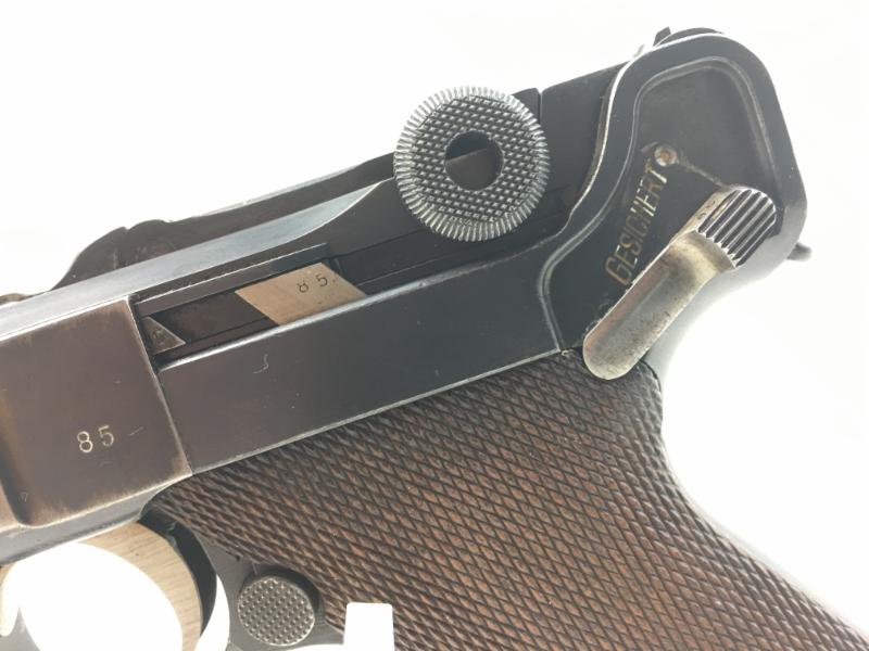

I bought this one for S & G; it is a well known fake or fantasy luger.
First described in 1965 (thanks Marc for the work on this pdf):
http://forum.lugerforum.com/attachme...6&d=1347113697

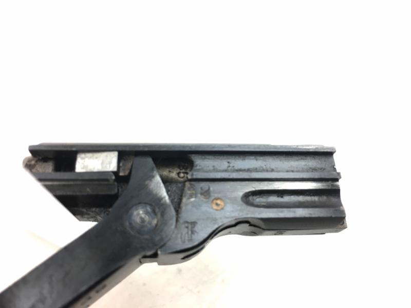

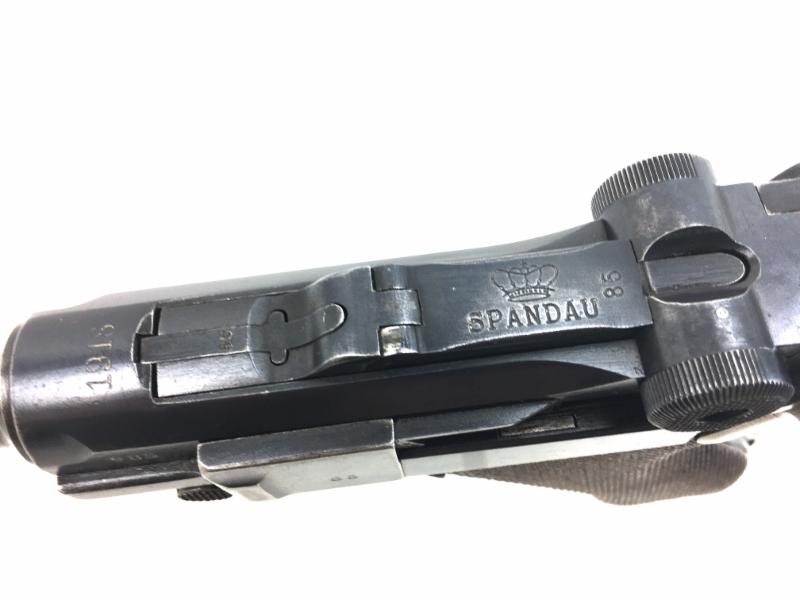

What is it? As best I can tell it "was" a very nice all matching 1918 DWM luger before the spurious crown and Spandau were added to the middle link.
The frame and receiver all bear the "N" or "circle N" of DWM and the small parts are matching and original to the DWM serial number of 785d.
Who ever "boosted" this luger added Erfurt inspected grips(crown/letter inside marked) and overstamped the original numbers with "85", they even added Erfurt grip screws.(which immediately went into my parts box).
Lest anyone fear for my sanity, I only paid a shooter price for this piece.

It seems I'm gathering a small collection of fake or fantasy lugers,
This "Spandau" joins the fake "1925" Simson I bought last year.
Now to find a nice fake Navy!

Norm,
It is amazing how long the "skull duggery" in lugers has been going on. I continue to wonder about the saga of this fantasy construct,can't be a fake can it?- as there was never a "real" one; and the money made or lost by its creator/owners along the way.

Thanks George,
You have mentioned that "Spandau" die in oid posts.
It is really clear that the center link was reduced in thickness to remove the original marking and the
Spandau name and crown stamped, probably the "85" re-stamped also.
When viewed from the sid-e the center link is noticably thinner than it should be. I'll take a picture later and post.
I don't see how this pistol ever fooled anyone; but in the days before the "net" and digital pictures and with snail mail, I guess it was much easier to create "special" lugers.
