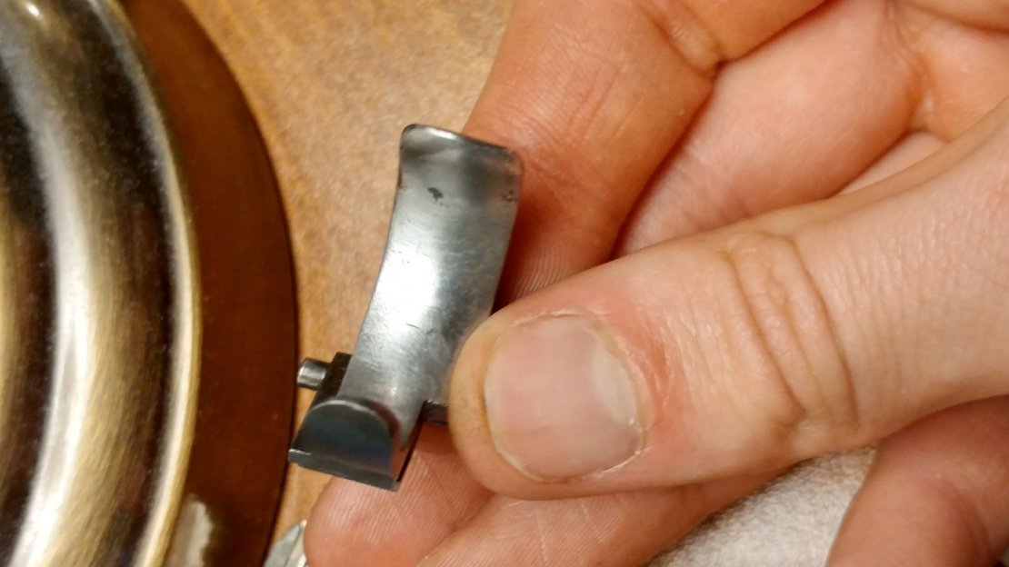

Hello, happy to say I finally purchased my first luger last week, a 1938 S/42 matching russian capture bought at a gun show (perhaps not the best place to buy a first luger?)

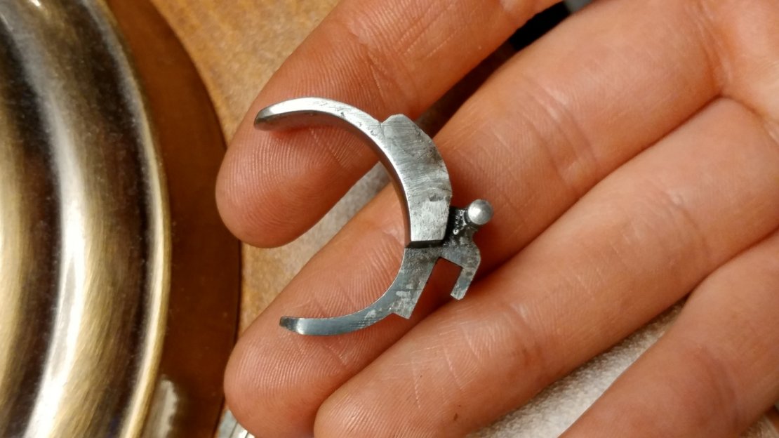

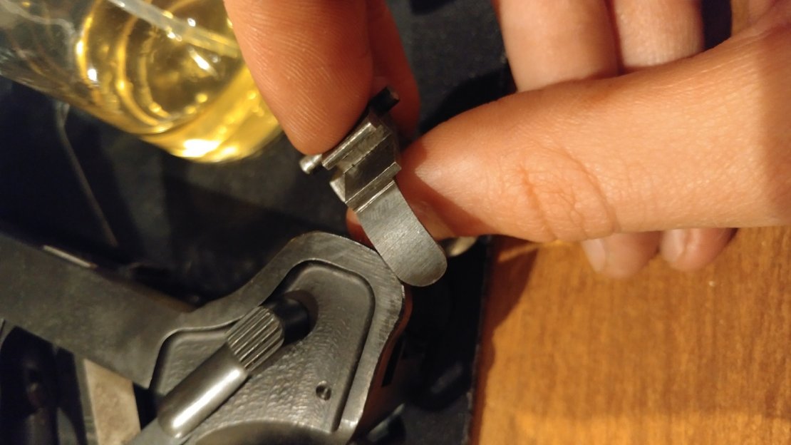

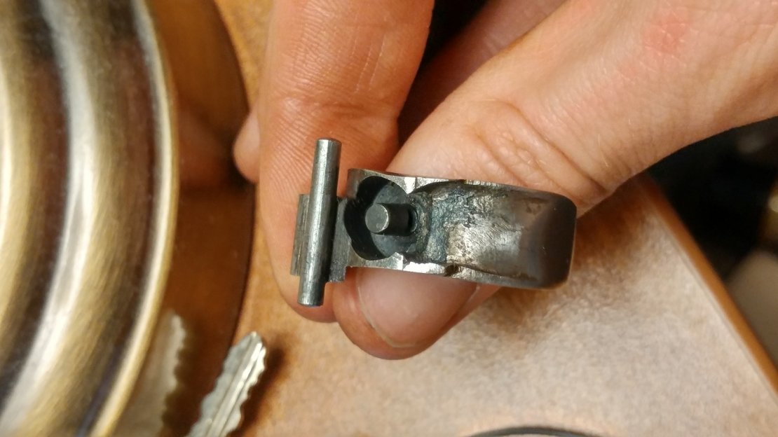

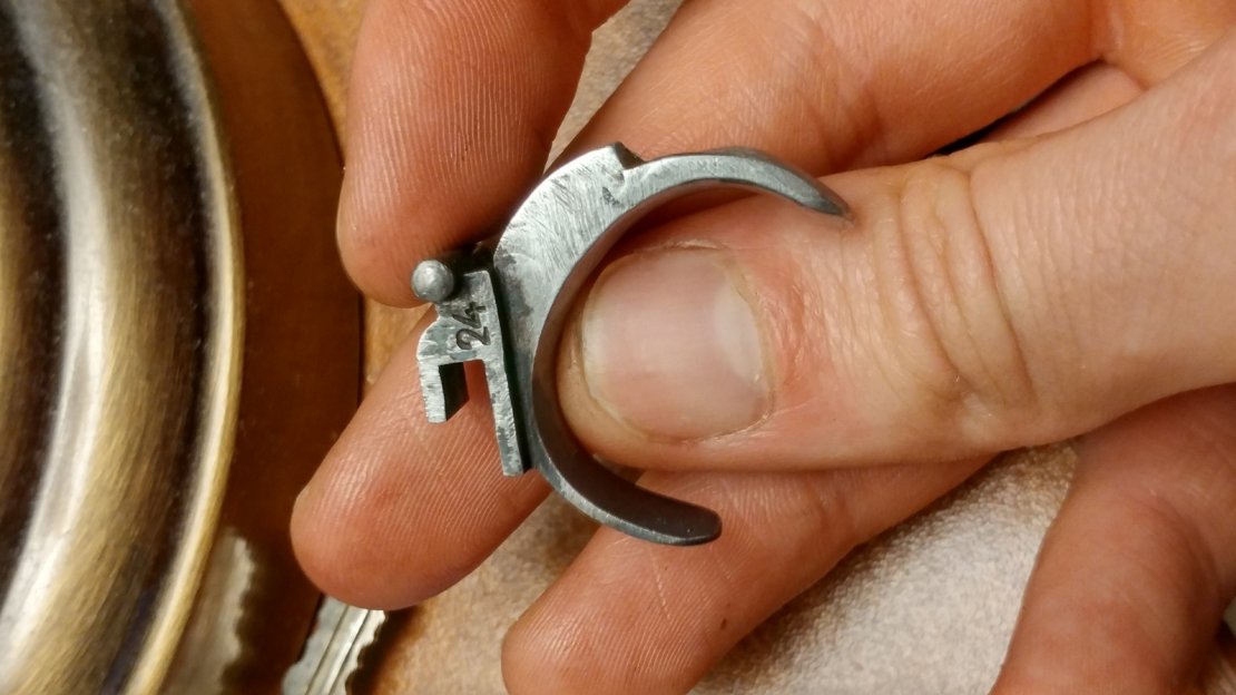

From what I have read and understand, the germans moved away from strawing many of the small parts, including the trigger in favor of bluing in 1937. This is why I was confused to have a "light" colored trigger, although the numbers on the trigger match the rest of the gun.
Why is this? does this look like it may have been strawed? My best guess is that perhaps someone polished the trigger for whatever reason. In some places it looks like salt bluing remains, or perhaps this is preservative I was unable to remove or a tarnished portion.
Assuming it's polished, If I did salt blue it, would this be considered fraudulent, or returning the gun to original condition?

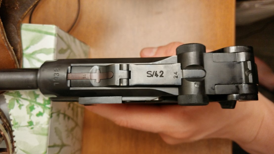

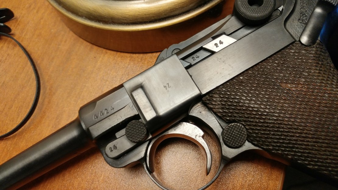

Finally, what is the deal with the upside down number in the sideplate?

I can only guess that someone has removed the bluing from the trigger, as a 1938 gun should have a blued trigger. Also, the webbing has been trimmed away on the rear of the trigger, so someone has definitely messed with it.
Why do you say it is Russian capture?
But regardless, go ahead and re-blue the trigger if you wish, it will make no difference in value IMHO.

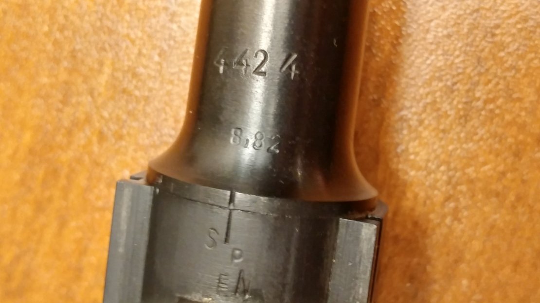

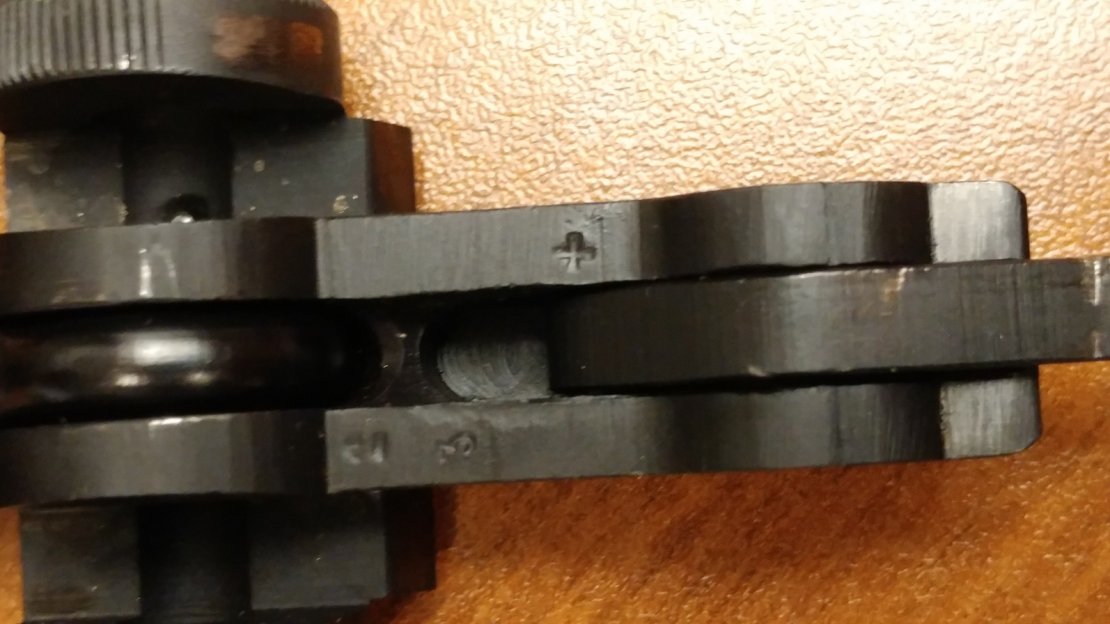

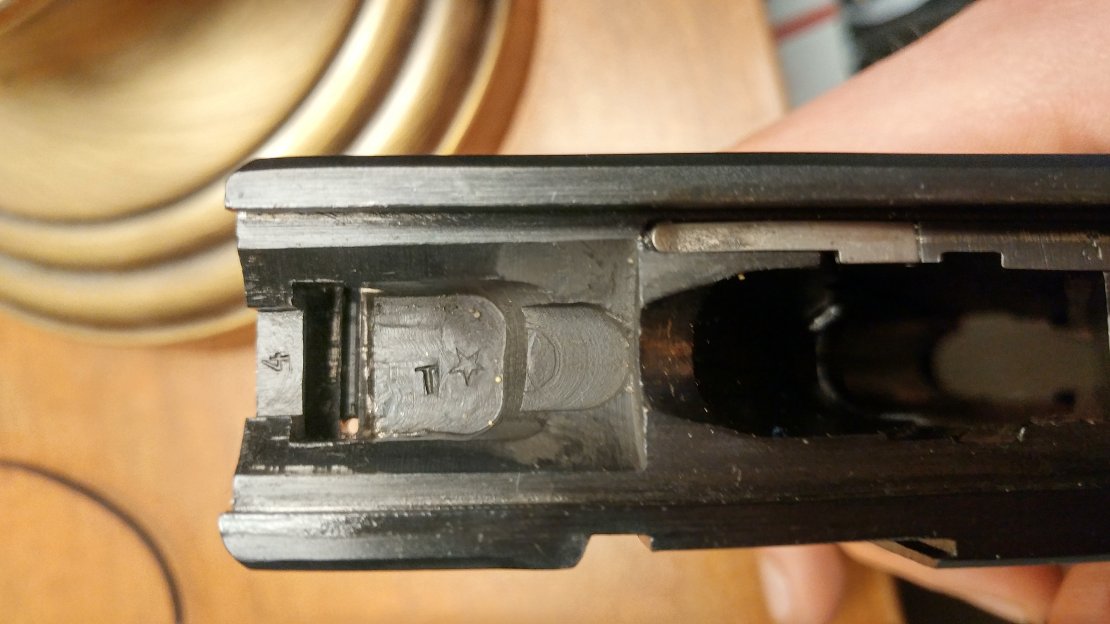

Mainly the salt-blued appearance (I know the germans also did this) and this star stamped on the inside of the frame. It doesn't have any of the "X"s common of the russian captures, but I spoke with one of the "luger experts" who specializes in trading lugers and he said the star on the inside of the frame was an indication of a russian capture. This dealer also didn't know I was looking at this gun, nor was he the seller, so I don't think that influenced his answer.

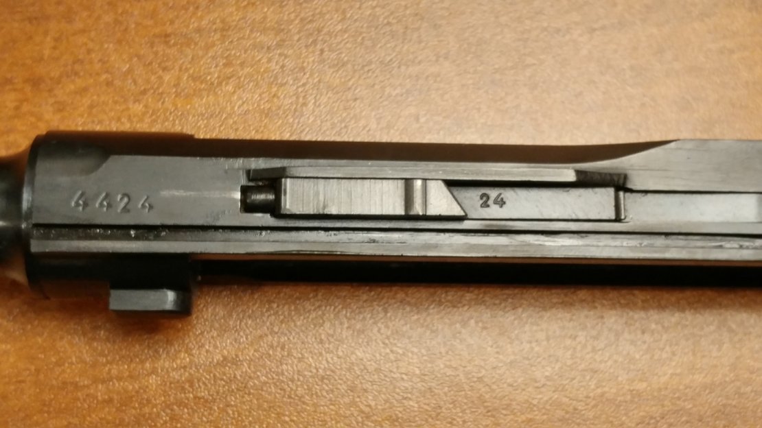

The side plate number apparently was stamped wrong and just left that way. I to am curious why you call this a Russian capture. I think the trigger was sanded and removed the blue for whatever reason. Actually a nice looking luger. Bill

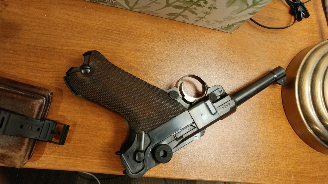

I'd question why it IS a Russian capture, not the other way around.
How about a set of good photos showing the entire gun as well as specific areas, markings, finish, etc.
Bill, good catch on the up-side down numbers on the side plate!

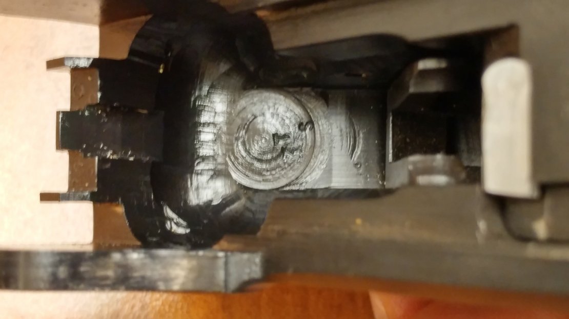

My question is about why the back half of the bottom portion of the trigger has been hacked off. File/grinding marks are visible on its side, as well. There's certainly more missing that a bit of bluing...
I'm wondering if this was done by someone unfamiliar with Lugers--instead of adjusting the side plate lever--to give the trigger more travel.

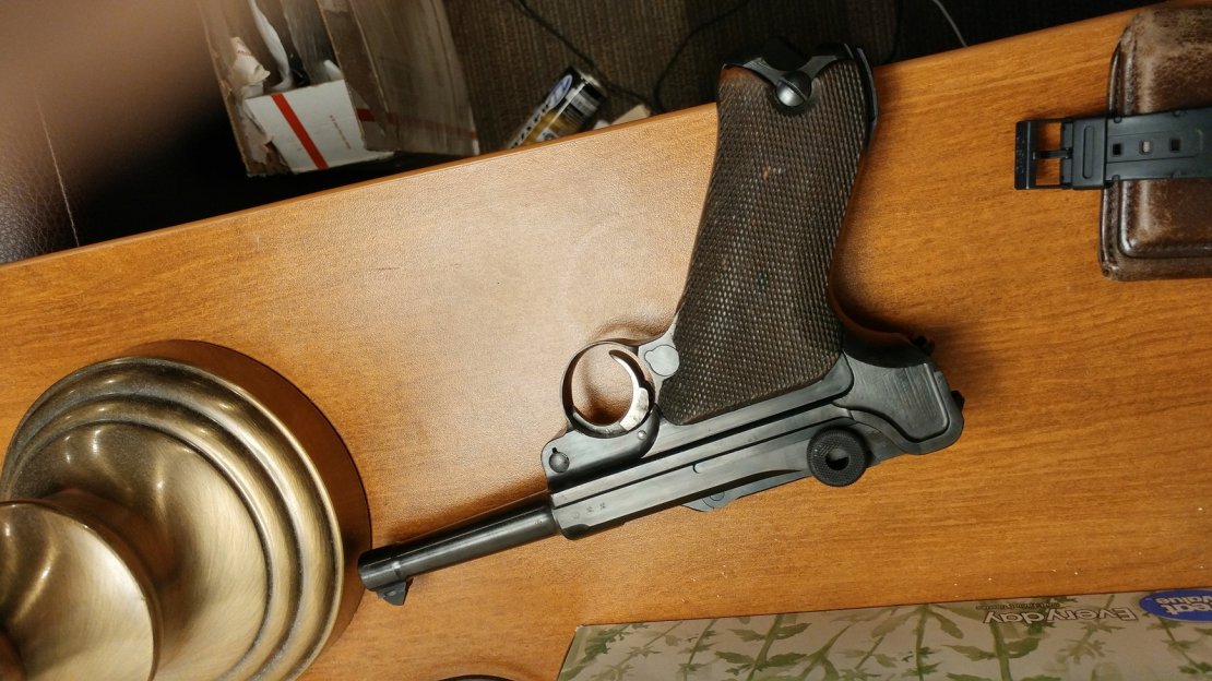

What would the star mean then? I was a bit weary, but now I definitely am. is there a chance this is a refinish that is not original german (or russian if that is somehow the case)?

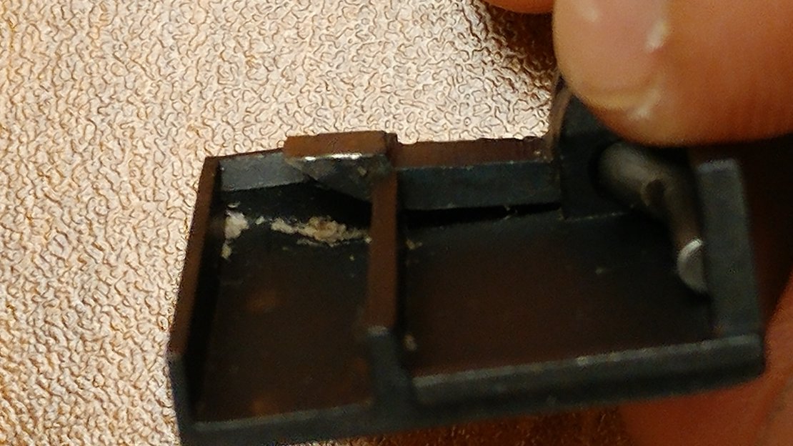

It also seems like bubba went to the Wile E. Coyote school of gunsmithing and may have took a file to the connecting piece on the side plate, thus probably the reason for the trigger modification.
I have a feeling I may have made a bad purchase... I'm going to be sick
You read my mind. The piece looks ground down.

I would say that the finish looks like a matt black, similar to that of a Russian captured gun. But I don't know that the star means anything relevant to this subject.
We will never know the "why" of the trigger work, but what counts is does it function correctly? To me the RC story matters not in the gun's value. It is no longer original, therefore a shooter. So how does it shoot?

So, it's very likely someone was messing with the trigger, plate and possibly the trigger linkage.
You'll need to check and verify it is correct prior to firing it. Start with one cartridge at a time, then move to two. I don't generally put more than 5 in a Luger magazine.
I don't have any EG or replacement trigger plates to compare this one to. If there is no number inside the plate relating to the first digits of the gun's sn it is a likely replacement. In any case, the plate looks like a replacement.

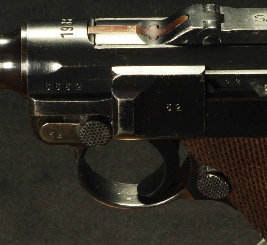

Here, for reference, is the side plate and trigger area from my 1938 Mauser Luger:
You will notice the shape of the plate, the corners and the shape of the part that encloses the trigger transfer bar.

The star in that location inside the receiver or frame is typically an internal factory inspection mark done by a Mauser worker as the part moved through the manufacturing process. That shaped star was also used as an acceptance mark by the French occupants of the Mauser factory after the war.
The finish has a dull appearance and may be a dip refinish.
Assuming the trigger linkage is correct, reliable and working properly, you have a nice gun for shooting.
Don't be anxious. The price you paid is appropriate for that.

While there are several suggestions of refinish from the pistol's general appearane, most notably both the trigger lever and the coupling link on the toggle are blued. On an orginal 1938 military, those should be white. When those parts are blued it is definitive proof of refinish.
As far as replacing any parts, if the pistol functions properly most collectors would not bother. The refinish makes it a shooter and replacing parts will not increase the value of the pistol. Better to allocate those funds towards an eventual collectible.

They are ground during fitting; so nothing wrong with what you see; other than most will have a bit of a bevel to help in the "reset".

Please see the FAQ - it discusses a Star and it discusses internal markings. Mostly makers marks, the mean almost nothing to collectors.

A Luger's trigger and the parts that integrate it to the firing pin are both complex and sensitive.
Without a fair level of experience, you're likely to do more damage than good.
If it is malfunctioning as it is now, consider sending it to someone like Tom "LugerDoc" with experience fitting Luger triggers.
If it is functioning properly, why open up a potential bag of worms?
Have the trigger hot blued if you don't like it as is.

The side plate does not look like an original part.
